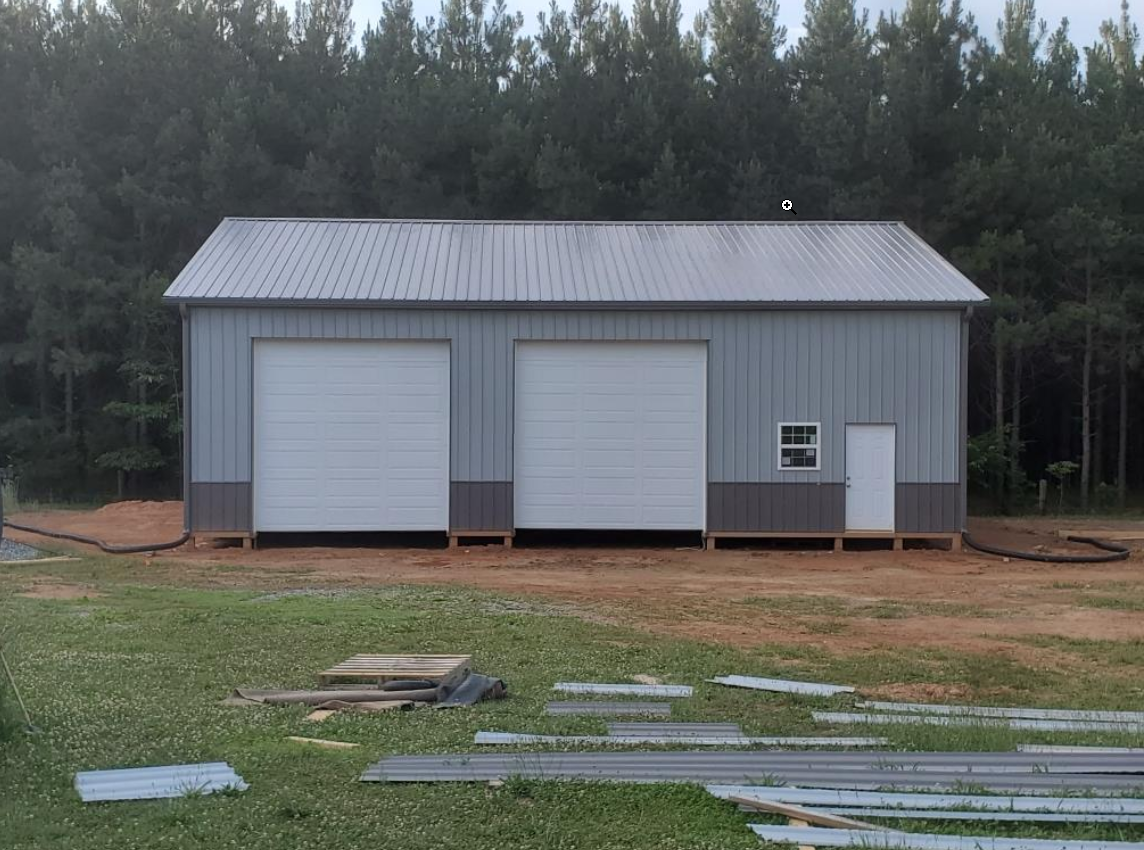

I went back and reread your original post and picture. Whether your pad is level or not isn't the issue. Pad elevation is. Again, should have been considered before construction. The bottom treated skirt board should be sitting on the ground. Or even dug in a couple inches.
I'm not picking on anyone. Just offering observations. When the building construction was done dirt would be brought in to raise the surrounding pad to the bottom of the metal which would create a slope away.
Dude, literally in the first paragraph ""Due to complications with the county, the building pad was built up just enough to create a level area for the builders to do their thing."""
The county pulled some BS with me a week or so before the build was planned to start and AFTER the pad was already built and compacted and signed off by the soil engineer. What, am I supposed to pay thousands last minute to have some dirt company to reconstruct the the pad? or just raise the building up and work with what I have? I know what the plans call out and the skirt board's relation to grade, I'm not an idiot. Even if I had not raised the building up, I already had positive grade on three sides, it was only the front of the build where we had negative grade.

Don't let him get you feeling defensive, Drew. Sure, accommodating the elevated building is taking some extra work now, but you're handling it. Keep forging ahead!
When I built my 30x36 pole barn, I had an oversized compacted dirt slab that had some drainage in all directions, so they put the bottom treated skirt board basically right onto my grade. Had to dig down an inch or two in one corner, and left a couple inches of gap on the other sides; no problem. The best part about this was indeed the minimal work require inside to get prepped for my slab afterwards. Just had to pull out a handful of loader buckets of surplus soil, then level, compact, 2" foam, 5" slab.
I think you will actually come to appreciate having your building somewhat elevated. Especially with that backside drainage issue you mentioned initially.

Just finished a 40x48 pole barn. There is ~12" gap below the bottom of the skirt (2x8) that I need to do something with. This was intentional as the barn is on a slight grade and I wanted to raise it up a bit due to the crazy rain we get here in NC. Due to complications with the county, the building pad was built up just enough to create a level area for the builders to do their thing. Even then, this resulted in ~2.5' of fill in the back. Yes, I understand it would have made more sense to build pad up to
I have ~14" that needs filled up INSIDE the barn. I figure 4" concrete + 4" #57 and ~8" of compacted sandrock would do the trick. The outside we will blend off using cheap fill dirt. Should I double skirt this building with a 2x10 below the existing 2x8?
Just curious if anyone has been down this road before...the builder said they typically put the skirt right on grade but that wasn't going to work in this situation.

I don’t understand why you didn’t go on down. Should have poured a concrete footer or cinder block at minimum just to prevent your band board from resting right on the ground and rotting out. Then took your metal down to the footer. The way it was done doesn’t really make a lot of sense.
   / Backfilling pole barn, need advice #80
Sounds like you would be pretty disappointed in a majority of pole barns here across the midwest then.
Putting the skirt or band boards right into the ground is how it's done. Mine were done with full ground-contact rated, tongue and groove 2x6s. Three courses of them, two are below grade, the top one is above.
Back-fill the building exterior, fill and compact inside as needed, then you pour the slab inside and it's already all formed up by your skirt boards. So what if they get a little rotten over the years, they aren't structural in any way.
As with any building, you need to make sure you have good drainage away on all sides. Then the ground-contact skirt boards ought to last 50+ years.
