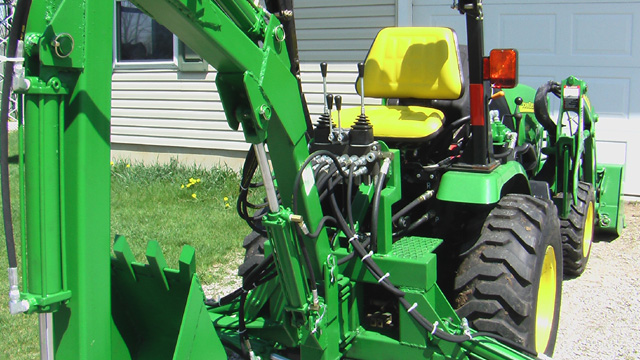

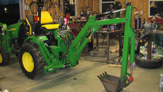

Here's a couple more photos with the boom and bucket being fitted up.
I am not pleased with the crowd arm cylinder, it could use another couple inches of throw to tuck the bucket in tighter. The bucket itself has plenty of rotation, after curling it up I would have liked to bring it in closer to the boom upright. I could move my attachment point but would lose some of the full extention.
Having never operated a BH before I may be concerning myself about something that isn't that important.

Thanks for the loads of pics!! It looks very nice and well executed. You have spent alot of time to bring your great project to near finished. To hook up the hyd with NO leaks that is nothing short of tremendous. Good Job!!
One thing that I noted is that the pins are only retained with the snap-over pins. These very likely will catch on something, open and fall out (especially on the bottom, ie swing cyl). Also, at this time you do not have any way to keep the pin form rotating in the pin bosses. This will cause undue wear in the bushings and pins. Pins should be kept stationary in some manner. You could lengthen the pin boss with a hole drilled for the retaining clip, put an "ear" on the pin and bolt it to the structure, or put in a pin with an eye and bolt that to the structure. If you have movement in the bosses there is no lubrication there and that will cause wear where you do not want it.
Thanks for your helpful suggestions regarding the pins. Actually, I had been trying to come up with a different retention method but finally settled on the linch pin idea. I can now understand why I hadn't seen them on other BH's.
Thanks for saving me some future problems.

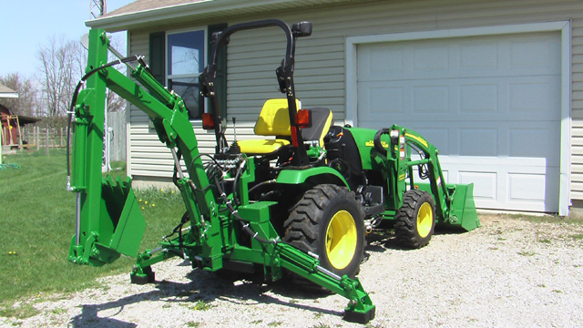

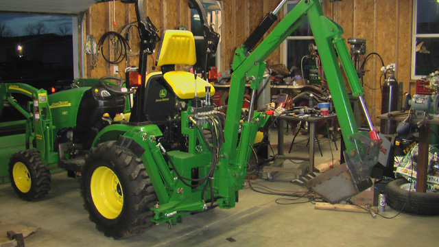

After quite a few weekends, a bit of head scratching, some welding and a lot of grinding followed by noticing my white hair has taken on a "Green" hue (do not paint in the garage with the doors closed without ventilation) and except for the decals, the BH and subframe are basically complete.
Now, on to the extensive "Honey do" list.
Thanks for everyones advise and comments, I appreciate it.
Rick
