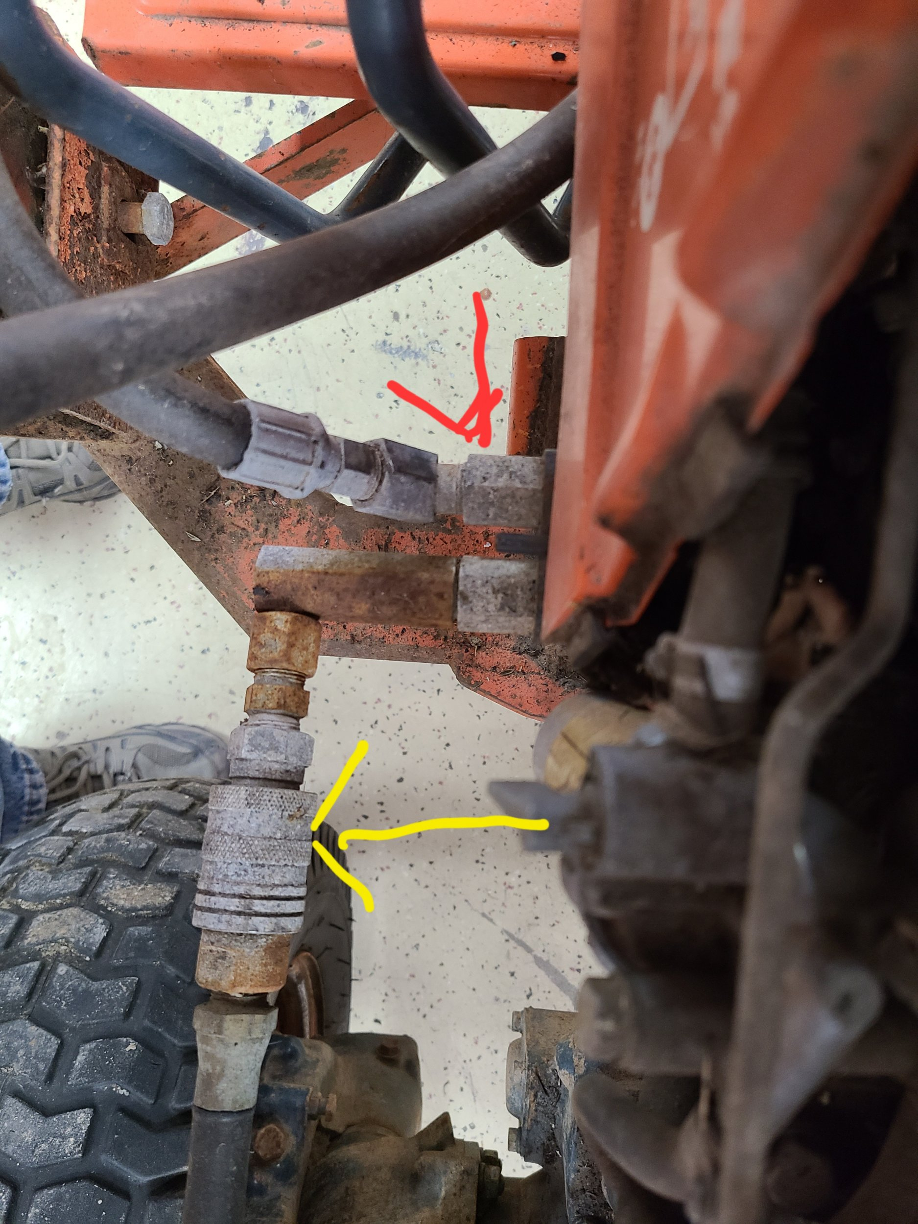

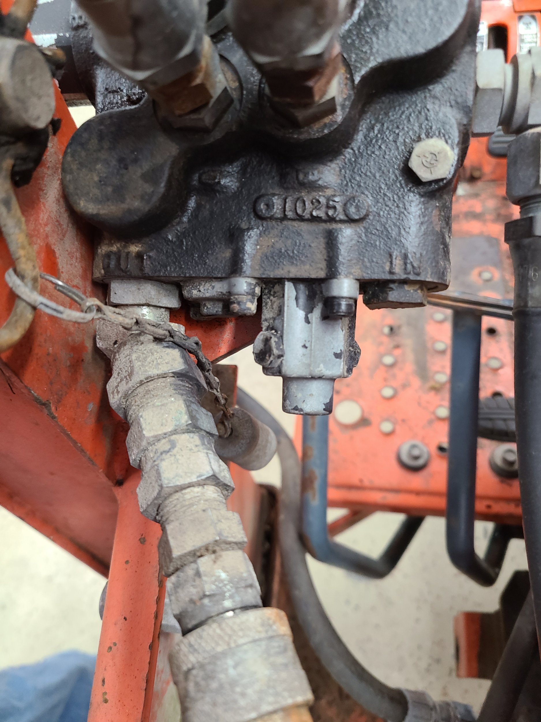

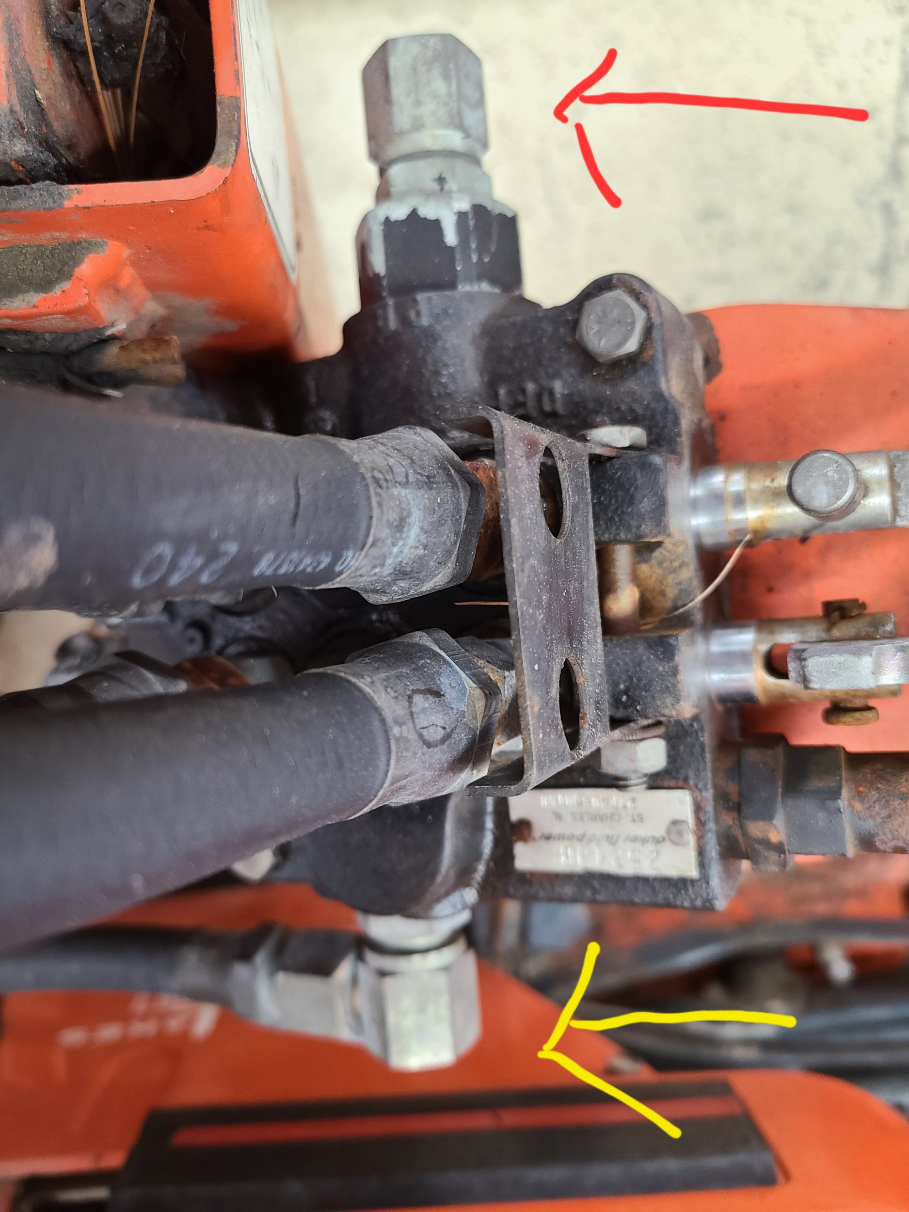

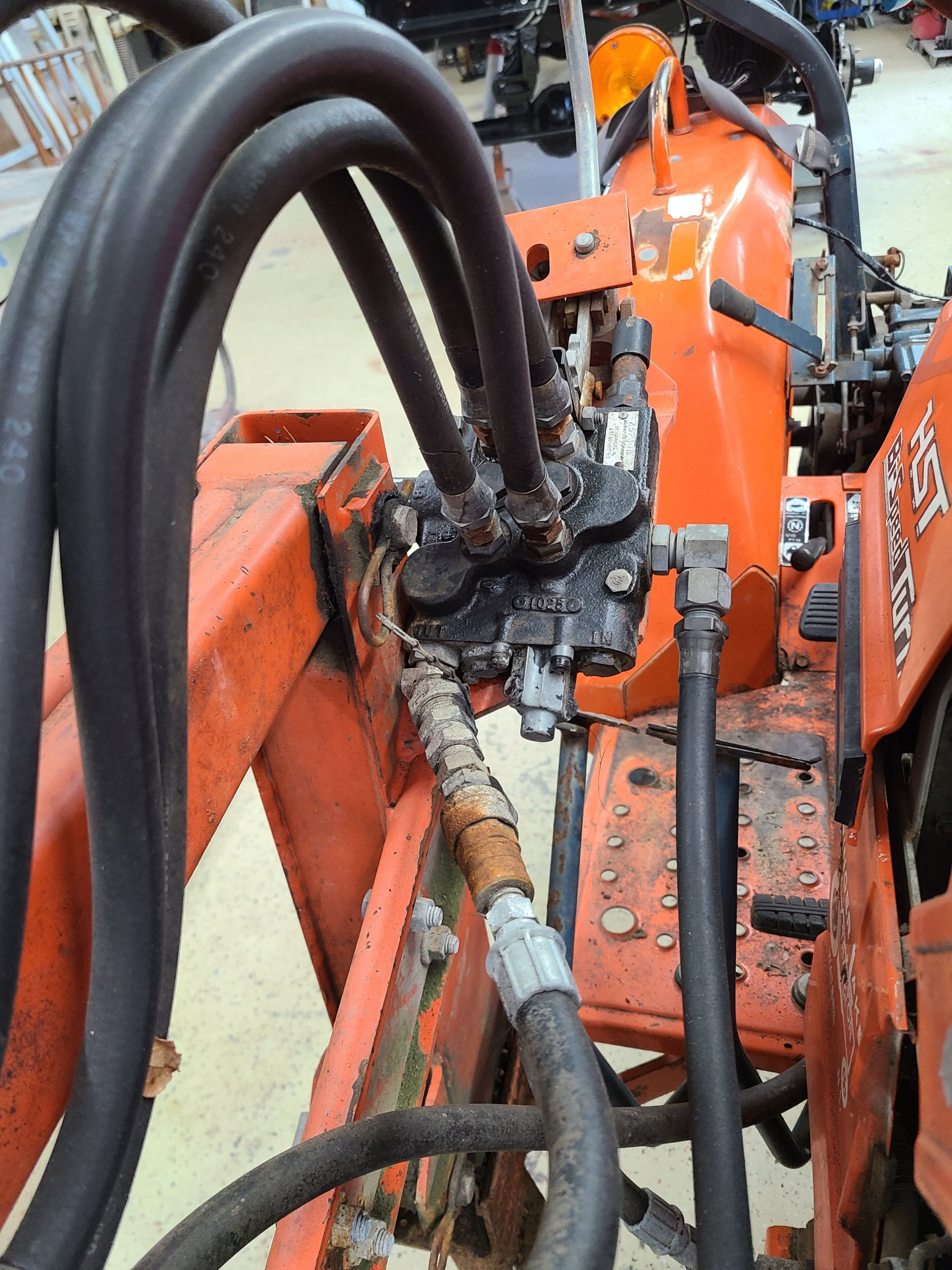

So I'm not sure what effect that high resistance path will have on the backhoe return. Maybe nothing, or it might slow the backhoe down too much. Worth a try.
Well, the flip side of that is that a pump that can comfortably run an FEL would generally make a backhoe ‘fast’ because if both are sized for the same tractor, the backhoe has less fluid volume in its single larger cylinder for each function, vs the two smaller ones of a loader function.
I recently replumbed a backhoe on my friend’s b6100 to run off the loader pump and got rid of the pto pump (will be repurposed somewhere, someday). There were a few reasons for that but one of the big ones was that i didnt want to have to rev the engine up to get the backhoe to move at reasonable speed. Since i figured the backhoe sectional valve set could take full pressure on its exhaust port, i plumbed from the loader pump, through the backhoe valve, to the loader valve. So far it has had exactly the desired effect. It is adequately fast at ~1500rpms.
I plan to do something similar on my b8200 backhoe which also needs too many revs to move like i want it to.
/ Backhoe attachment
#62
So you're saying come FROM the hydraulic block to backhoe and return into the loader valve instead of what was previously mentioned which is the opposite ?
Valve to BH and back to block
