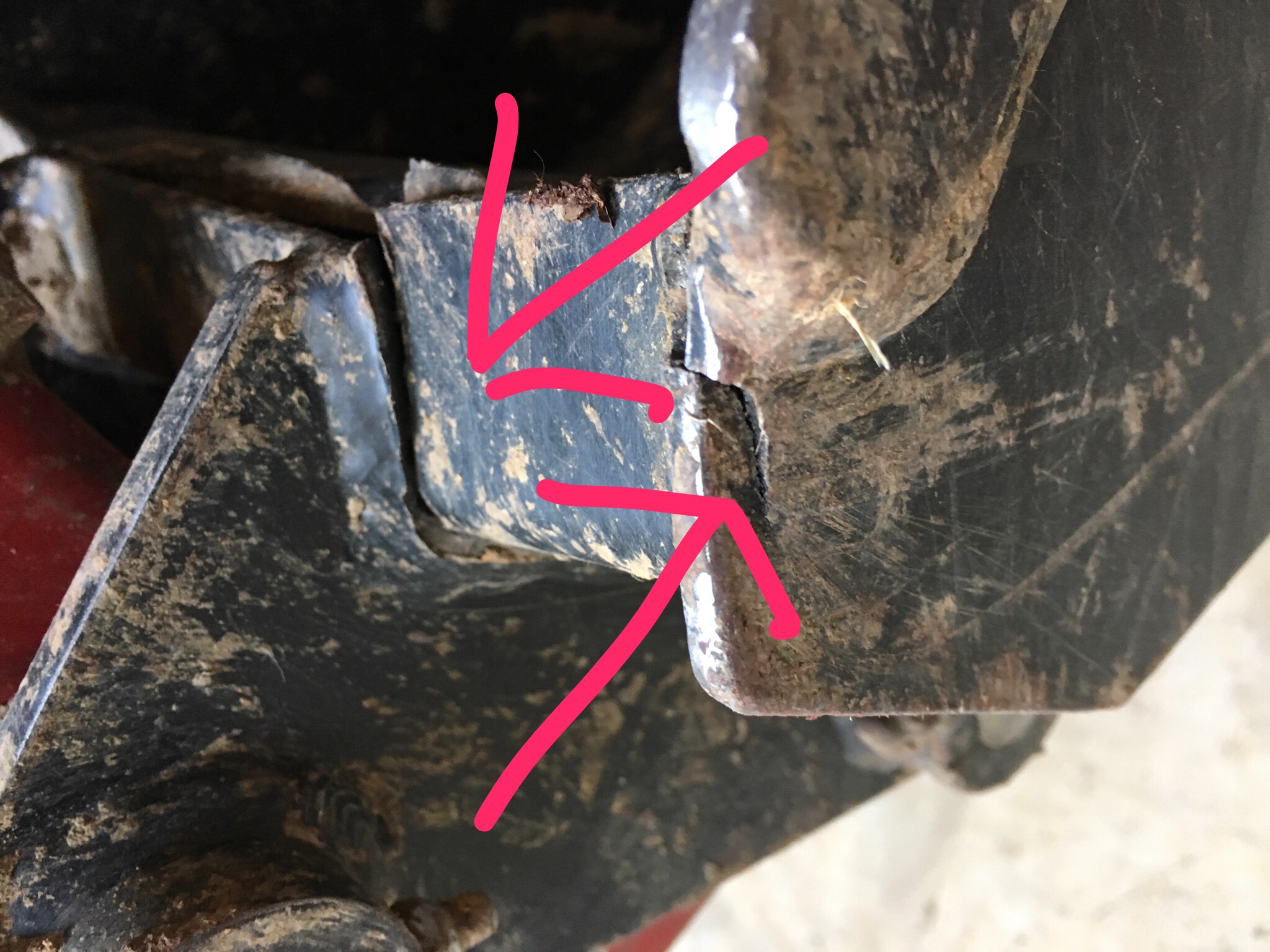

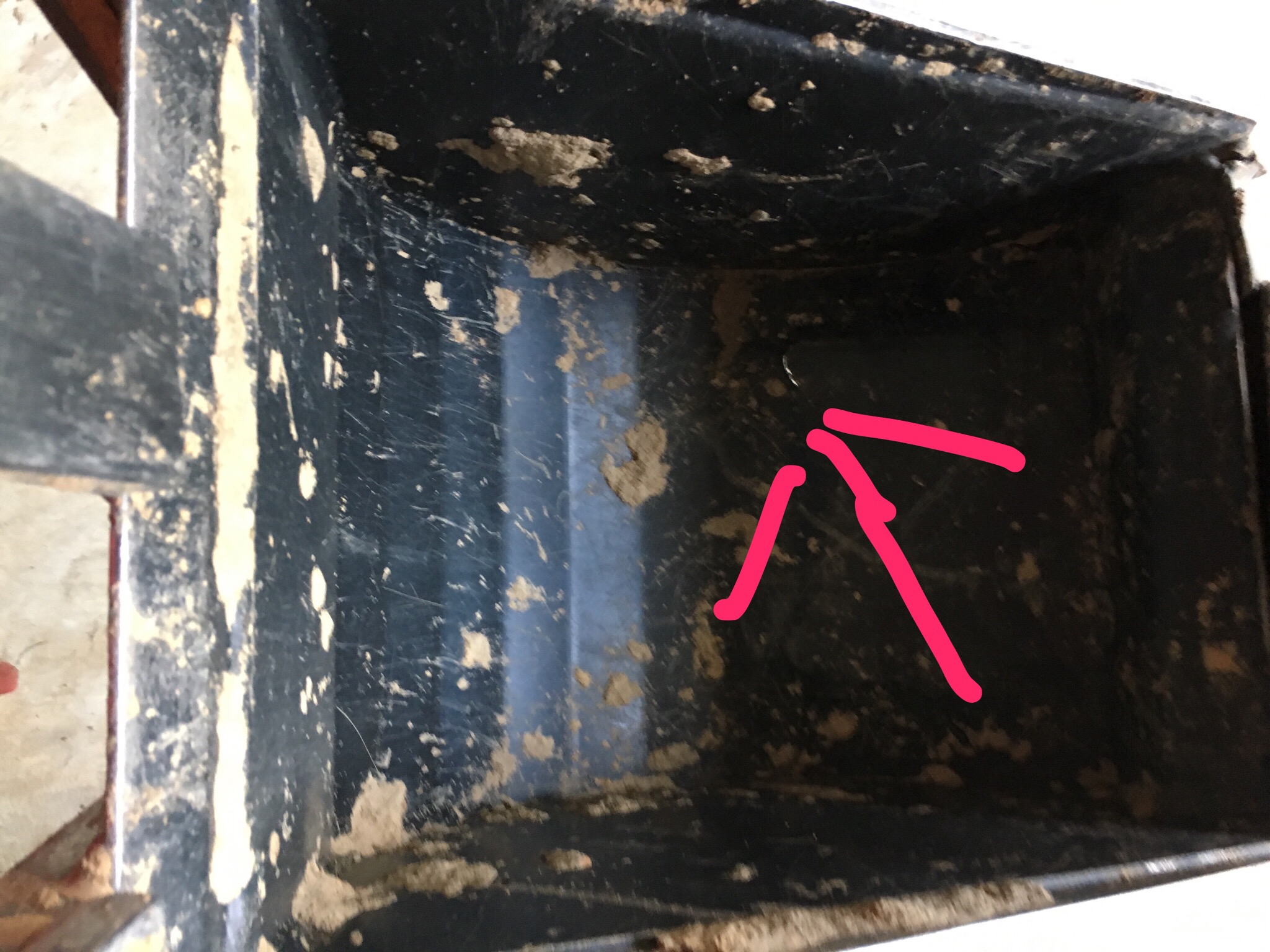

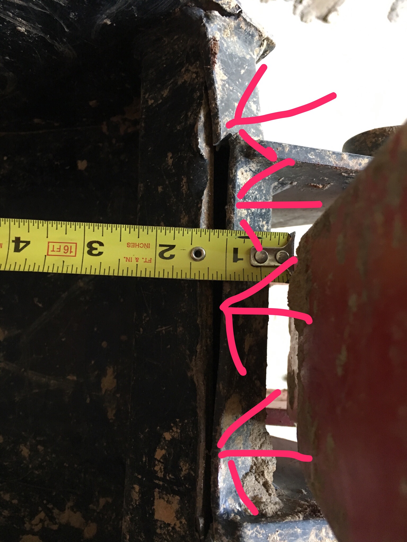

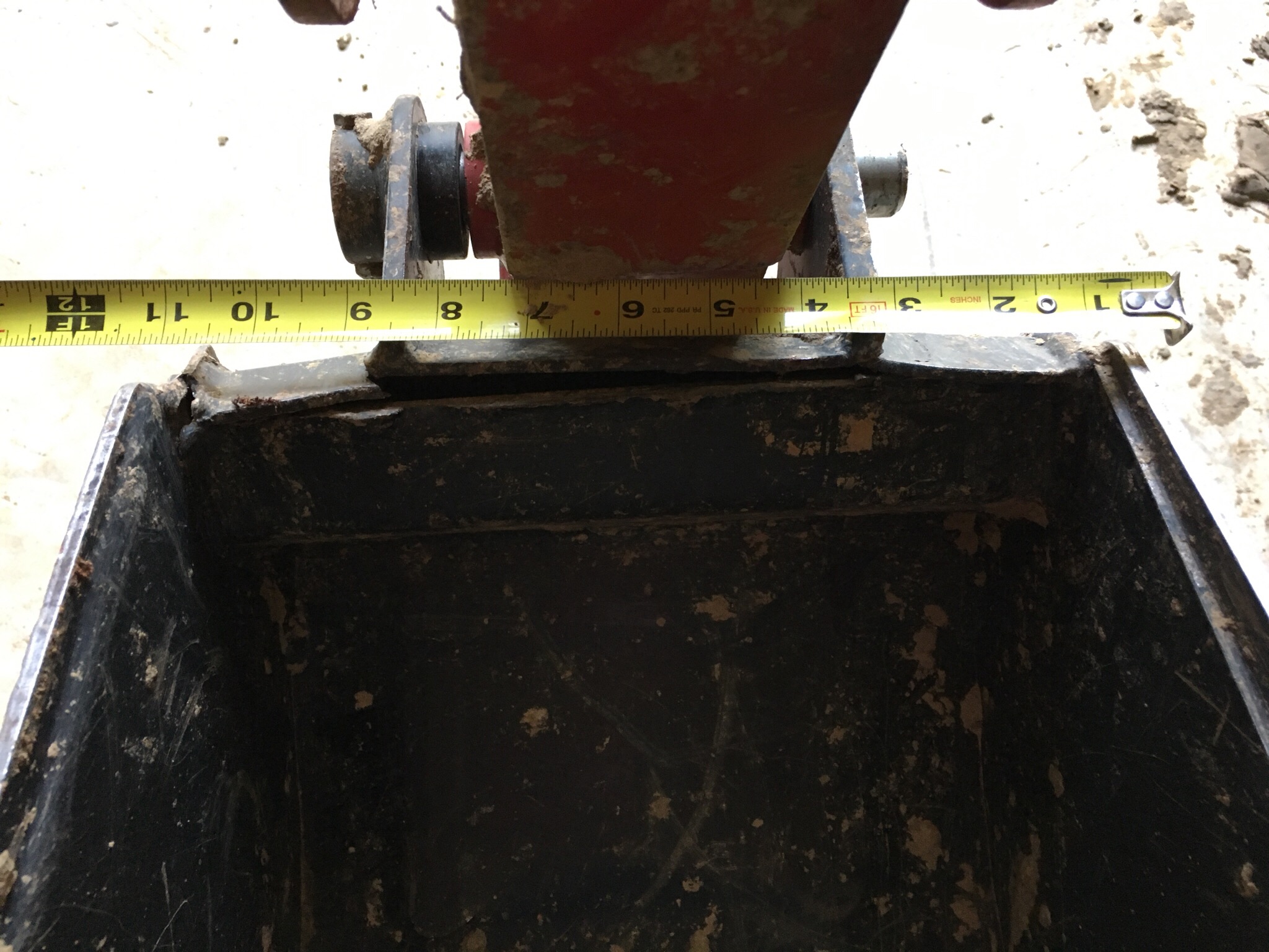

I had a weld break on my 2538 backhoe bucket which in turn pushed the supports on the back side through the metal on the inside of the bucket. I took the bucket to a friend that is a metallurgists with a large local steel fabricator. He said the if the weld wouldn't have broke then none of the other damage would have happened. He said that it was defiantly a manufactures defect and that it should be covered under warranty. You can see in the attached pics where the 10" of a weld pulled away. From what I have read the tractors backhoe should never have enough power to break a weld on a bucket. Have any of you experienced any issues like this and were you able to get the dealer to cover under warranty? Thanks in advance for the input.

Given the age and warranty, I would be inclined to think it should be covered. I didn't see anything revealing by viewing the pics on my small phone screen. But absent any evidence of neglect or abuse....it should be covered.

I guess this is the age of the Internet and all, but it is interesting to take pictures and pose the question on a forum instead of just asking the dealer if it is covered under warranty. Send the pictures to the dealer and ask him to cover it. I suspect he will say yes.
There are ways to abuse a backhoe bucket, but it looks to me like this just had some welds that were not proper.

To be fair, I know he has already talked to his dealer, as the service manager sent me pics yesterday morning. This is absolutely going to be covered by warranty.
And you are right Dave, this is just a bad weld situation. We don't have many issues, but we do have one from time to time.

We have sold hundreds of KMW made Mahindra backhoes over the years. I can count on one hand the buckets that have failed due to a defect. Not common. But if it does happen, it happens in the first few hours of hard usage.
