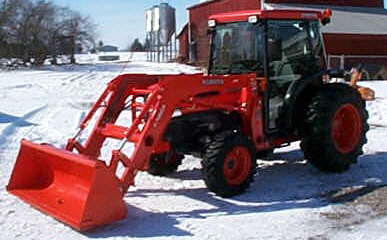

Here is a picture of it, just washed and getting put to bed.
Daryl
