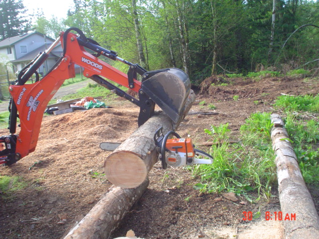

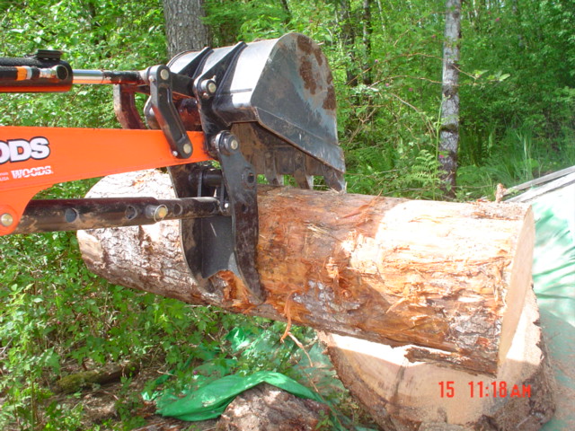

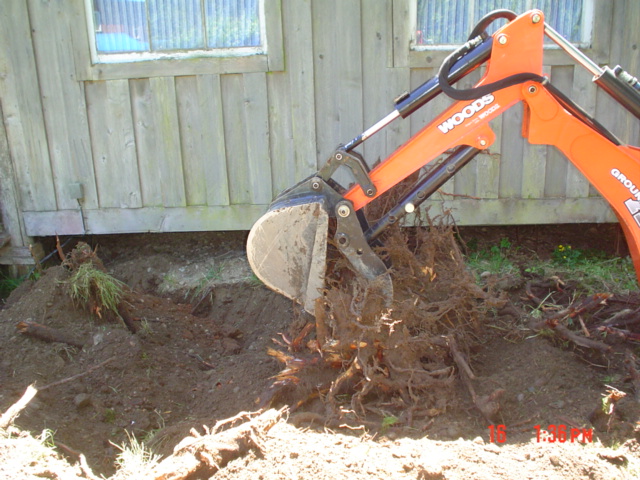

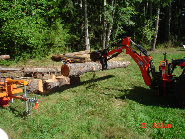

When I got my CK35 almost 3 years ago I got it with a Woods 7 ft backhoe.
Main reason I got it over a Kioti backhoe was that the Woods came with a factory installed 7 position Thumb, which was a must for me. Had one problem with the backhoe (they replaced a swing cylinder) but was looked after promptly :thumbsup: by the dealer.

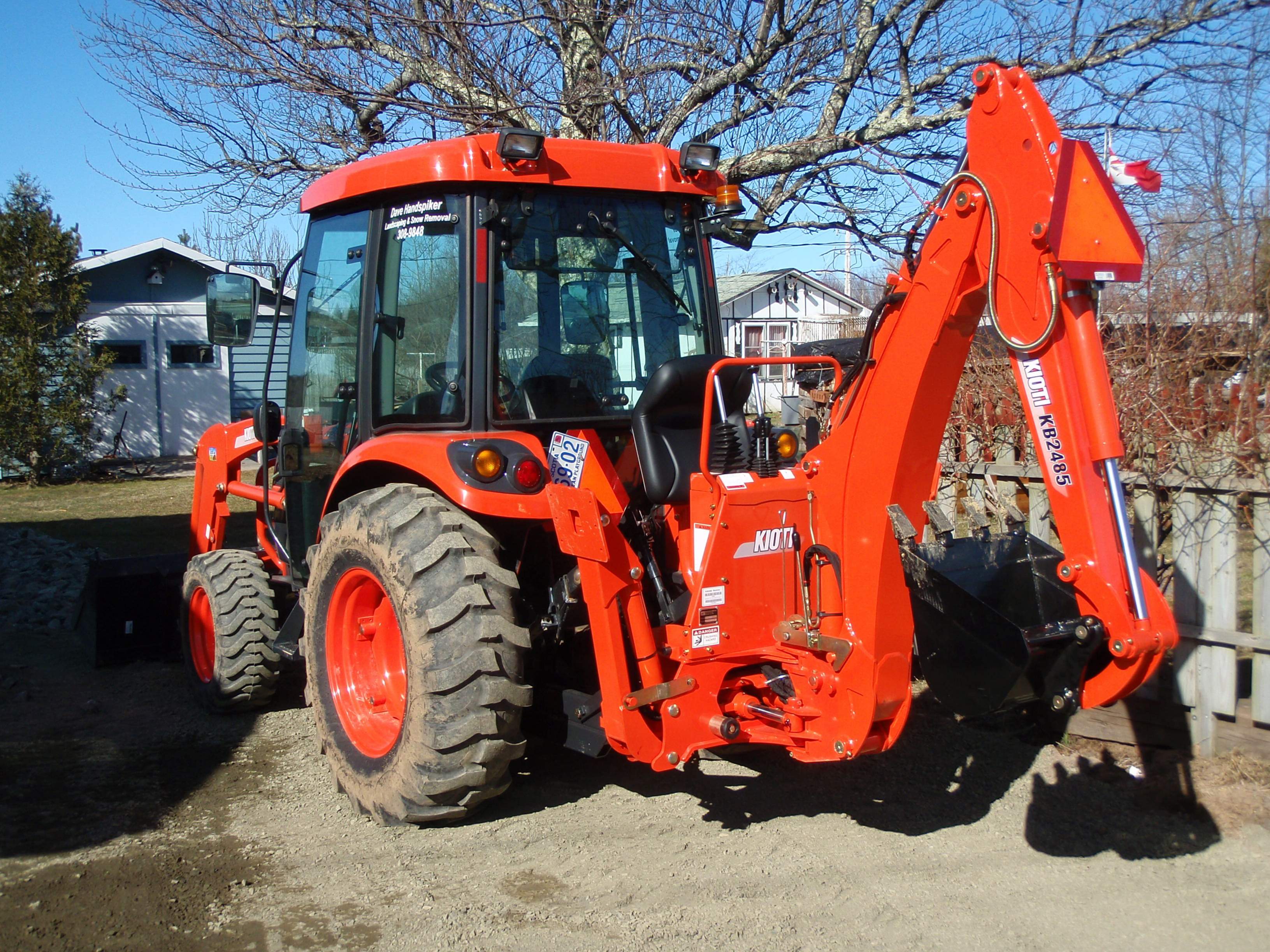

For comparison, I just had a KB2485 installed for $7500 + tax. This is on my DK40se with cab.

Hi
I just had a 2475 kioti BH installed for $6000 including tax brought it home and it took me less than 5 min to remove. I was inpressed the dealer was right it was so easy. The other day i thought i would put it on just to see how easy it was, backed up to the hoe conected the hyd hoses lifted the sub frame backed up alittle more ajusted once more backed in droped the 2 pins done. unbelieveable no arms to remove. slick as ****:thumbsup:

Getting a thumb with my backhoe was very important to me. The local Kioti dealer said he could weld on a 2 position thumb, which to me was a bit hokey. The Woods backhoe came from the factory with a very nice and substantial 7 position thumb. So it was a bit of a trade off, better thumb or possibly easier on/off backhoe. :)
