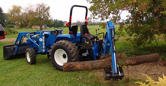

After some research I decided with a frame mounted Woods BH 7500 with a 16" Hd Bucket. The downside to a frame mount is clearence and I did get hung up once and required a little tugg to get out but other than that It has been a real worker. I paid $5800 for the setup installed. Pic enclosed.
