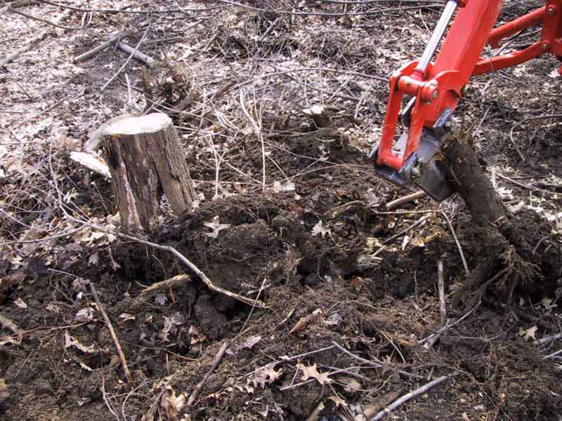

One slight design flaw - the mounts I made for the front pin doesn't quite have enough standoff from the plate - it hits the bottom of the dipper stick - so it can't be curled in as far as I would like. I'm thinking this might be fairly easy to fix with a little grinding of the end of the plate and rewelding. Attached is an image with the tooth curled as far as it will currently go.

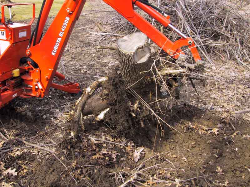

Obviously there's more to do.

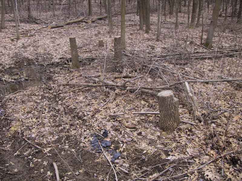

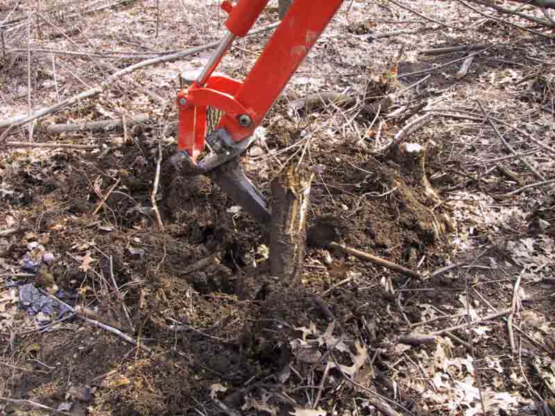

This is a 10" or 11" stump from a white ash that I cut down last fall. I believe it was living at the time I cut it, although in another image you can see it had some disease.

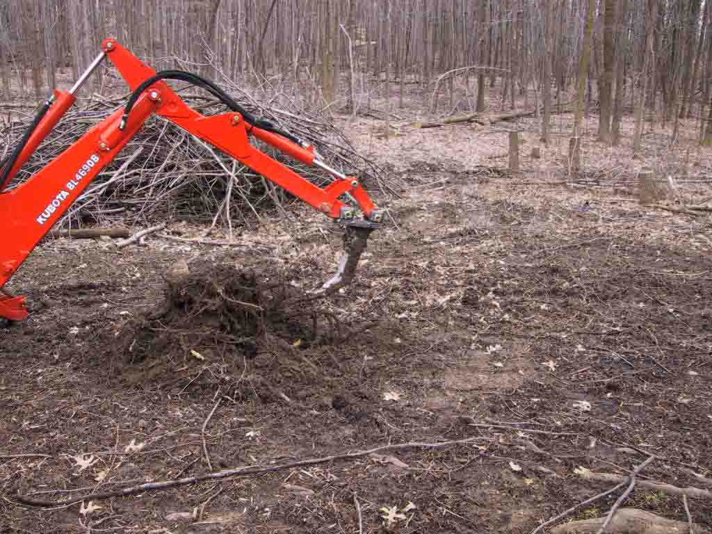

One of the lateral roots. It's about 4"+ in diameter.

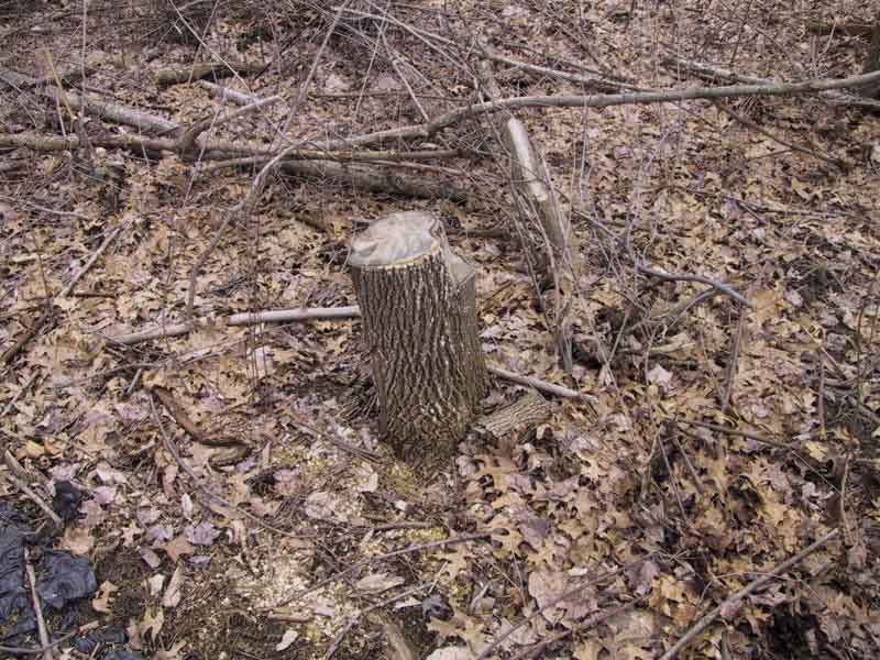

Another shot of the root.

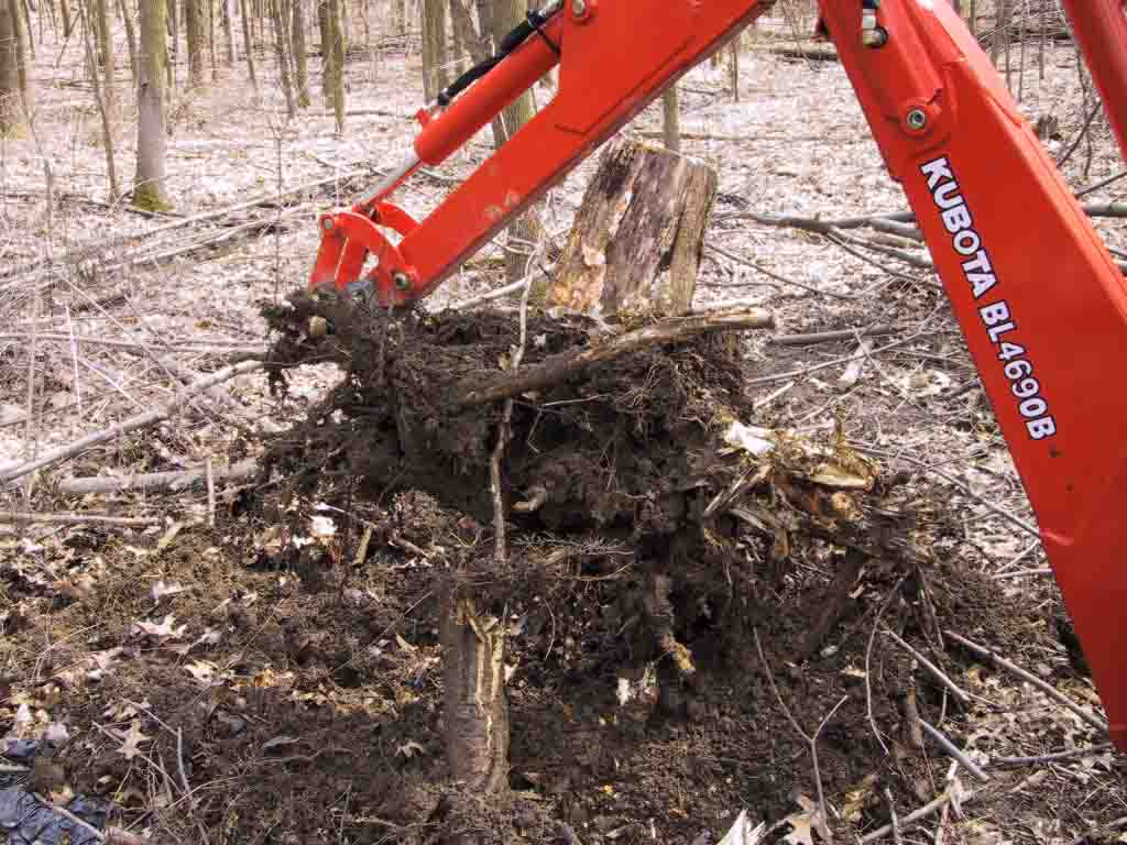

Completely ripped out.
You can see the portion of the trunk where the bark had split, exposing the inner wood of the tree.

#27
Another angle. All and all it took maybe 10 to 15 minutes to rip this one out. I was being sort of cautious because this is the first thing I've actually used that I have welded that was under extreme stress.
After this one, I did another white ash - maybe 5" or 6" in diameter - took about 5 strokes to cut the roots and pop it out. Then I started two more white ash which were bigger - 13" or 14"+ in diameter. I ended up needing to reposition on both of those and about that time the sun went behind the clouds and it got chilly so I went in.
I'm fairly pleased with the performance of the ripper tooth thus far - although I'm sure even larger stumps will be a challenge.
