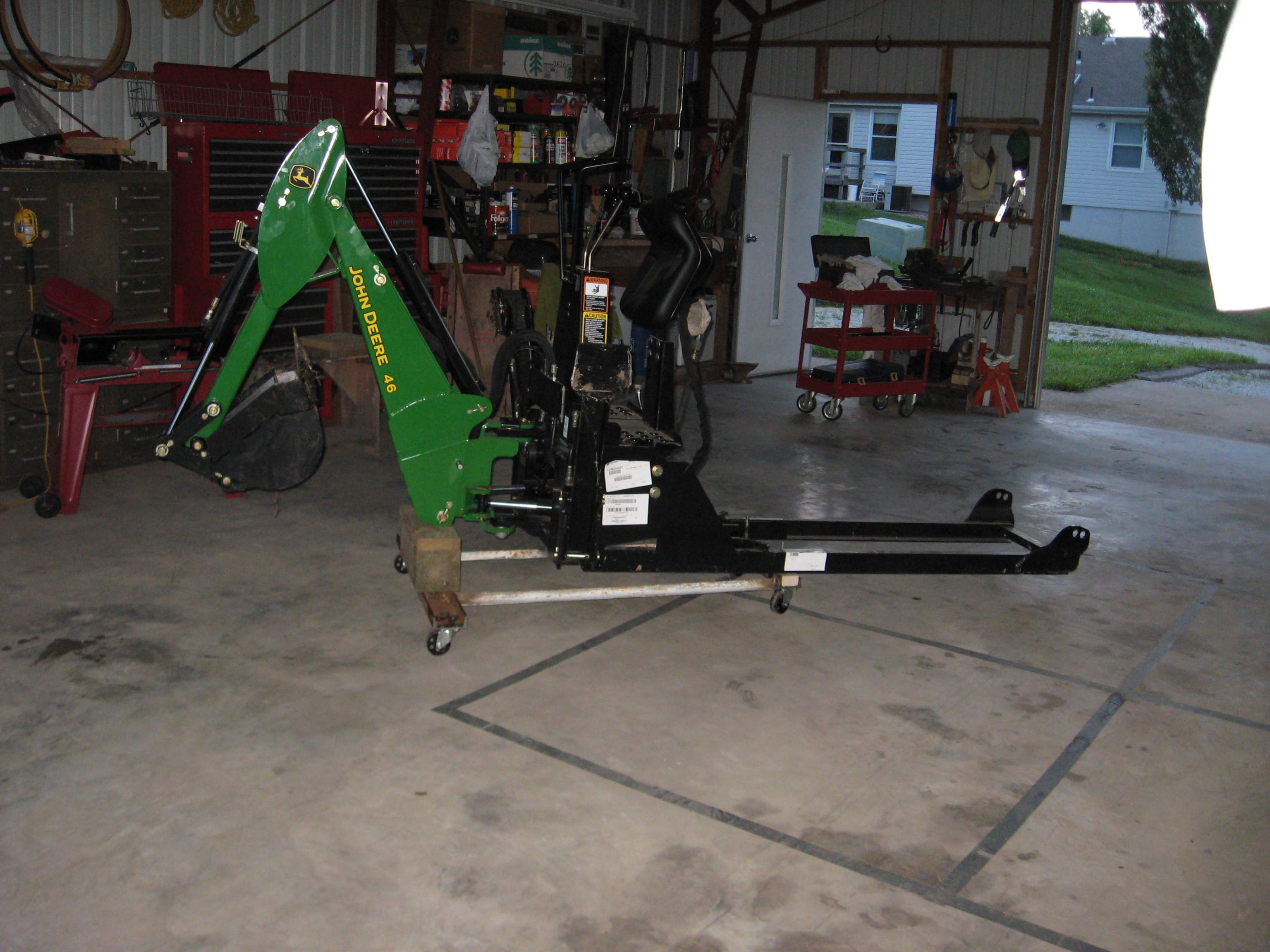

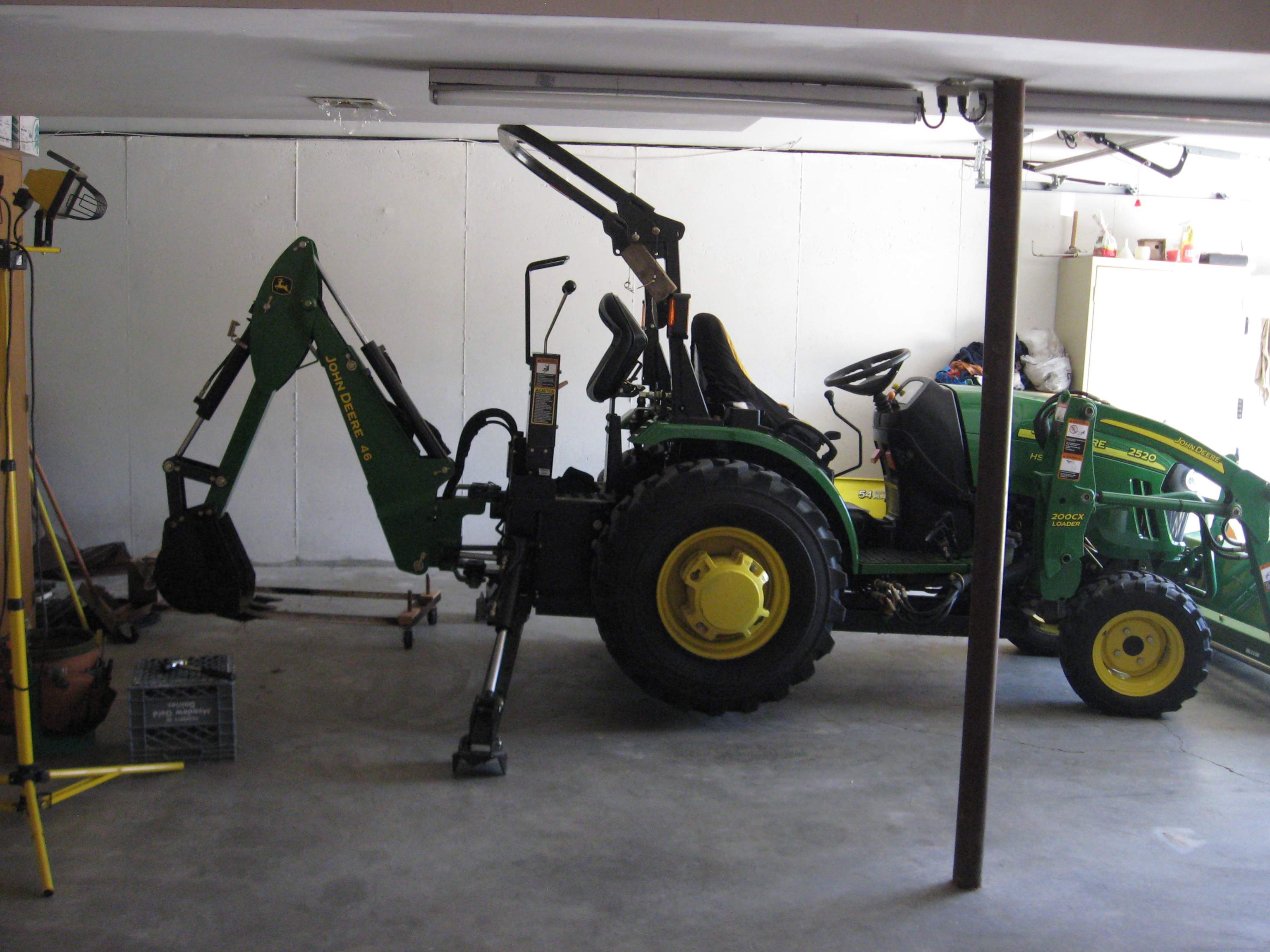

Thanks Rob-d and especially Runner for the excellent pictures.
My eyes opened wide when I saw those.
I can see how the back hooks on then as you said the front will pivot up.
Ok so I can safely say that to put the backhoe on or off should not be a weekend project provided I have a dolly and the flat floor in my garage.
This really helps guys:thumbsup:

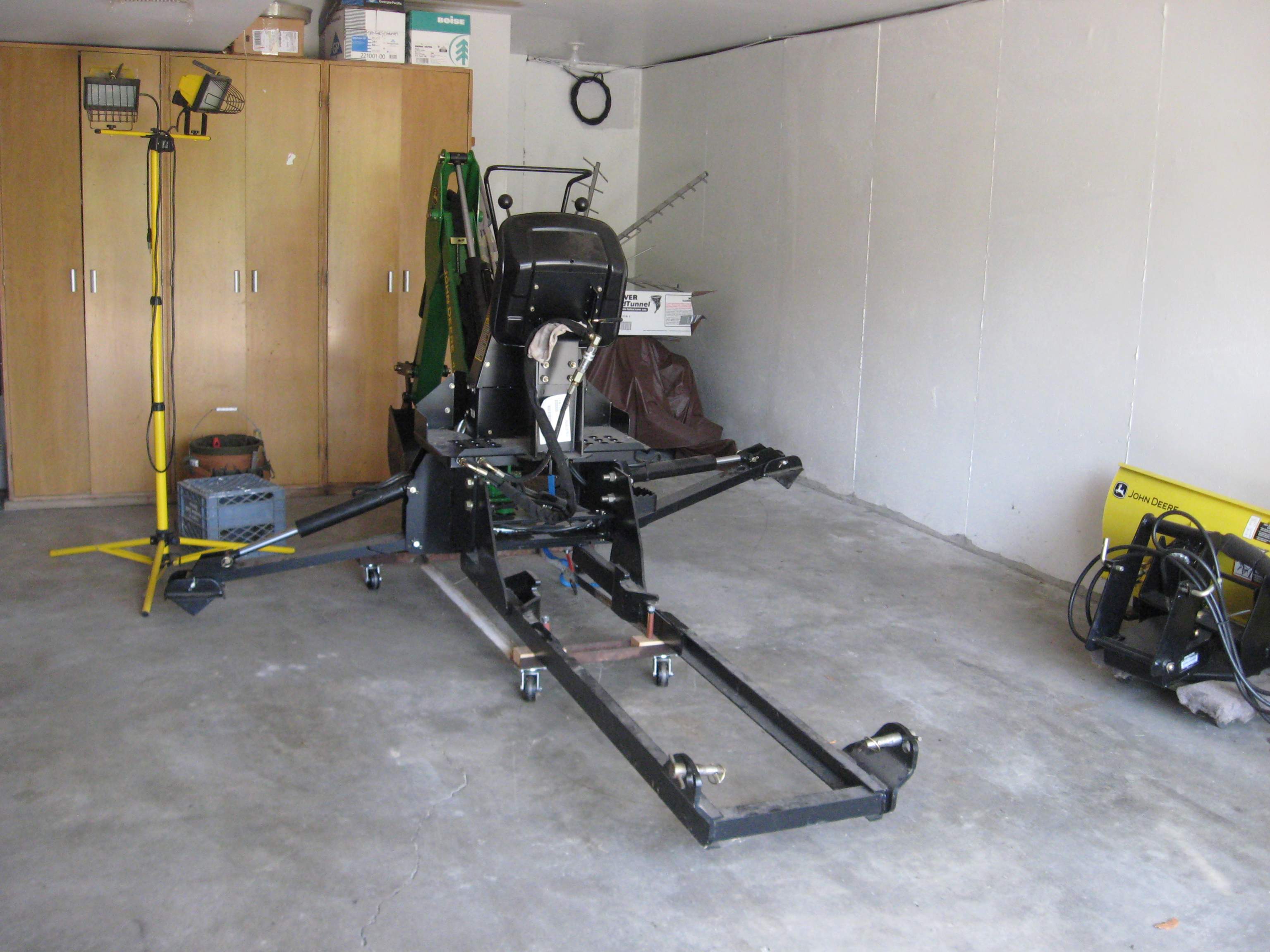

"Can you talk about the mower deck attachment brackets how are they to on/off. "
Not a big deal, pull two pins on the front and two on the back. The two on the back are the lower arm pins for the draft arms, so they have to come off anyway. This just adds a couple of minutes to the 15 minutes it takes to do the whole changeover.
It does help make the case for a rear finish mower....

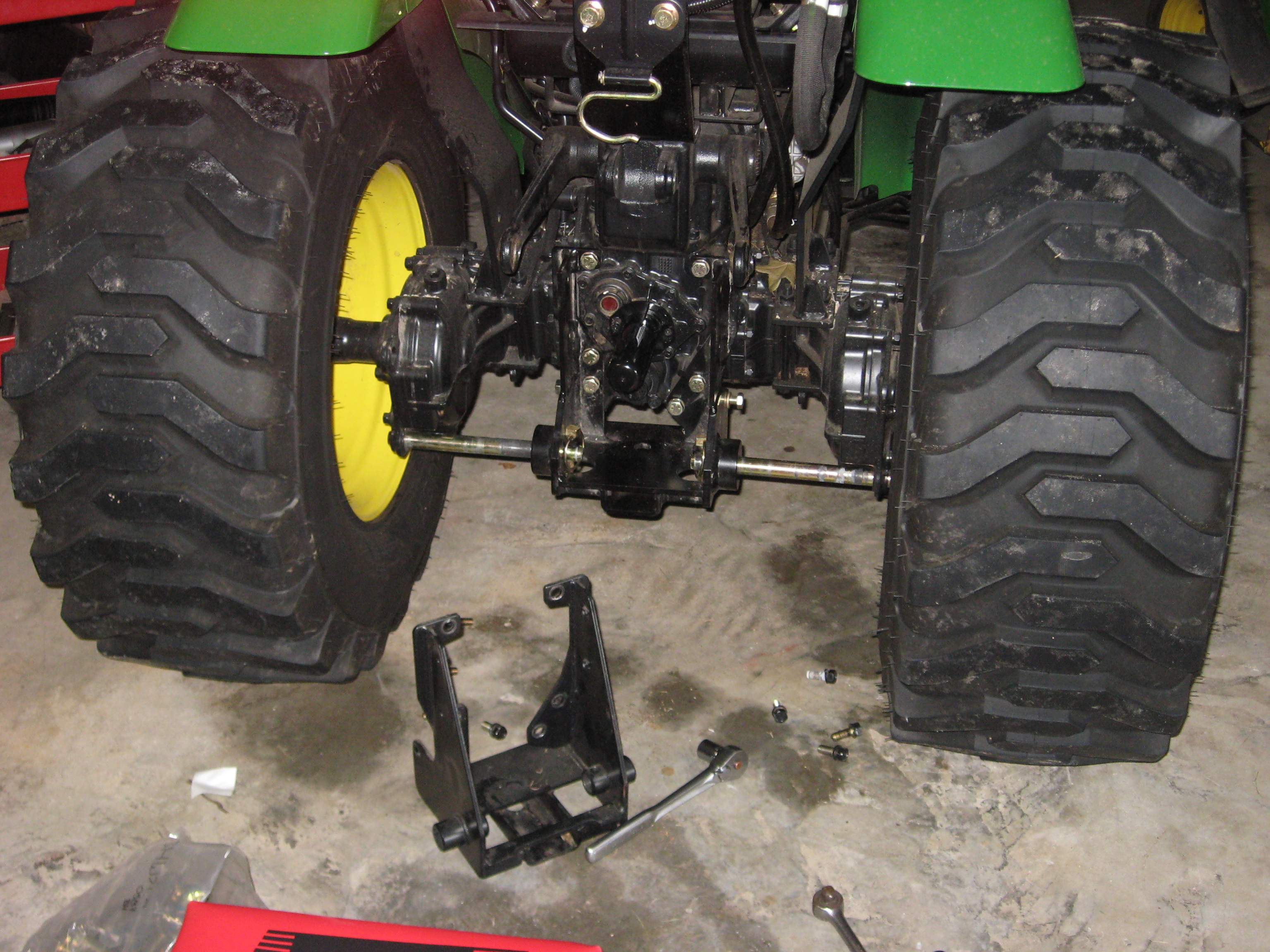

One more thing, as part of the backhoe package, you will need to change out the bracket that holds the three-point arm pins (the new one is a heavier-duty unit that stays on the machine, takes the place of the standard one).

Thanks that last part the new bracket for the that holds the three point arm pins I'll bet it's hard to find as a previous owner would probably leave it on his tractor when selling the backhoe. Unless they can be bought as a seperate JD part.

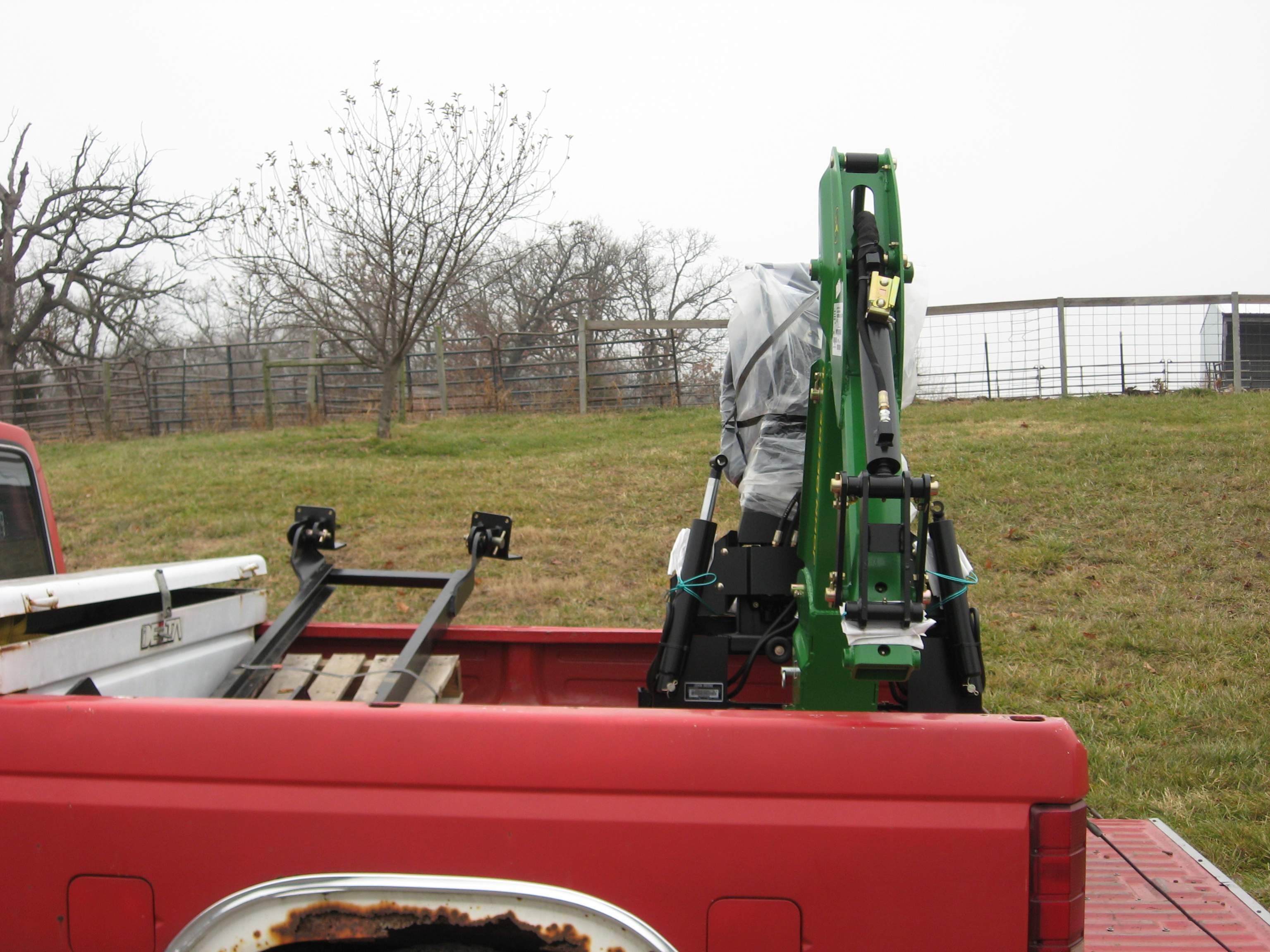

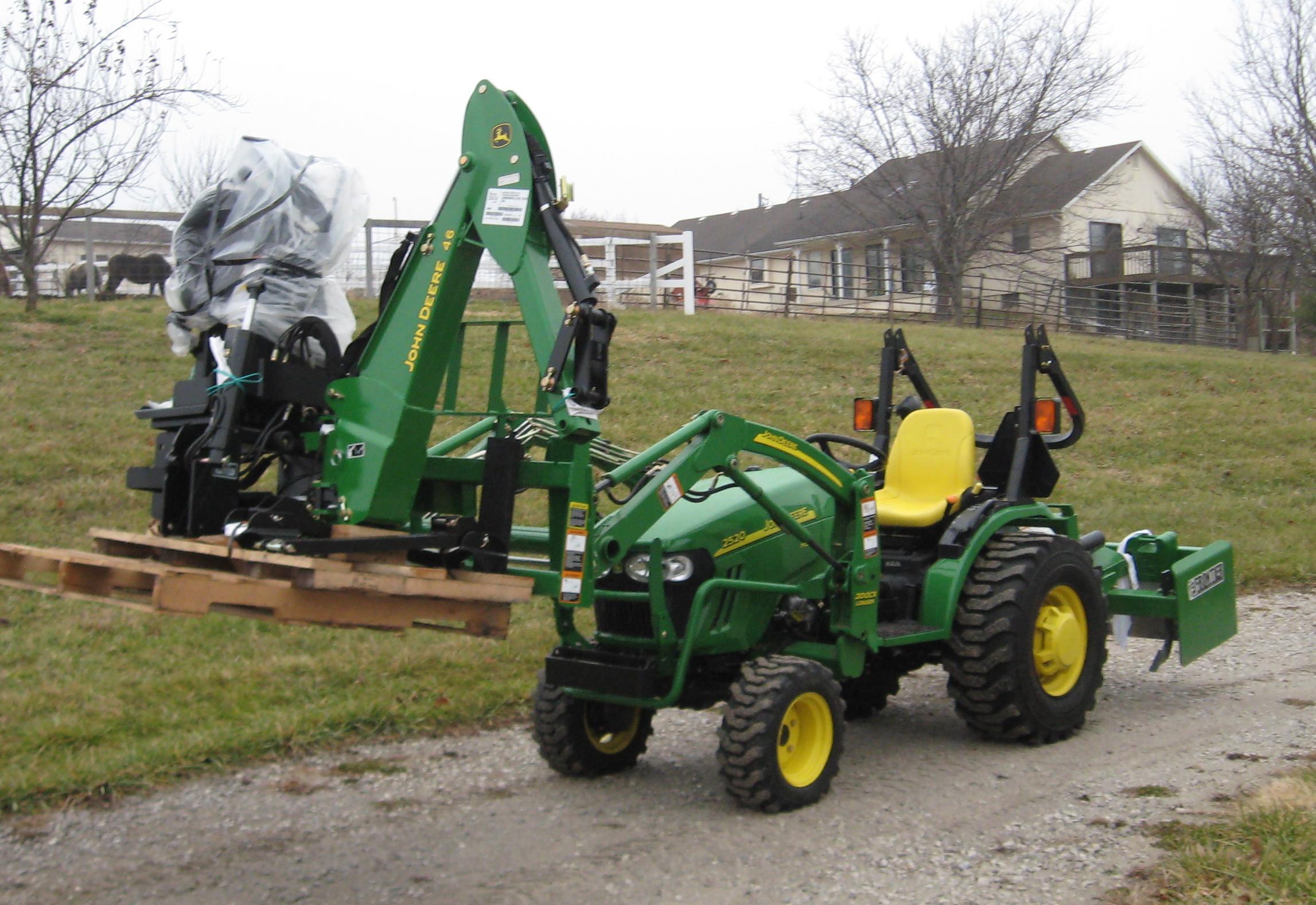

The bracket is ordered as a separate item when you order the hoe. I think it shows up as a "requirement" in the computer when you order the 46 as an attachment.
When you order the 46 backhoe as a separate item, it comes on two pallets, the hoe and stabilizers on one, the sub-frame on the other. The bucket is ordered as a separate item because there are different sizes available, and it also has to be installed on the dipper stick. So, I guess you would call it a "kit". You could probably have the dealer put it together, but it's not that hard to do, so I did it myself.

I think it shows up when you "build it yourself" on the web site as a necessary item.
If I remember correctly, the new bracket came with it's own separate installation instructions. It's just a direct "remove and replace" for the other one.

When I bought my 2320 with the BH the dealer gave me the bracket that came off the tractor that they had to replace with the one to allow the BH to be mounted.
