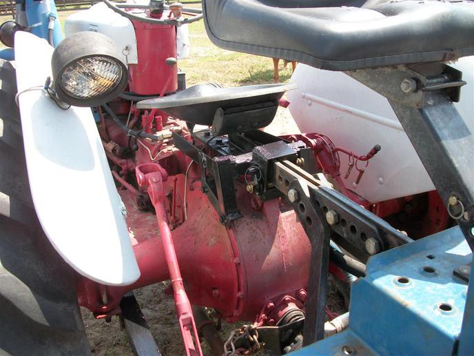

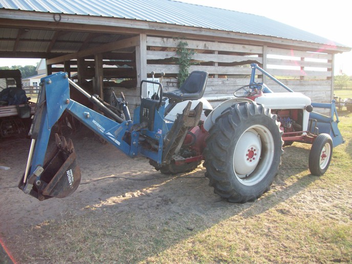

you are starting with a decent tractor. the 8xx fords had a beefier rear end.
now.. no doubt a full subframe would be nicer.. but many get by with a 3pt hoe by themselves. I prefer a lil bracing myself.

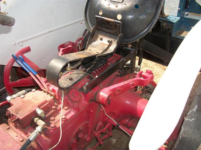

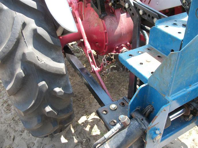

I married a woods 6500 to my 850
I made up 2 beams on the underside of of box tubing, and then at the top link area I welded up a cradle that supports the toplink to keep the rocker from moving, using as many top cover and axle trumpet bolts and studs as I could.
I havn't ripped any stumps out or anything.. but for digging.. she does just fine... that jd 46 hoe doesn't look to be much more how than this 6500 is.. so should be a good deal especially if you are a welder.
mine's got a pto pump, and runs fine with the tractor idling... hoe also solved my rear ballast issue for the loader :)
here's my 850 with a ford 722 1-arm loader, and the hoe.
