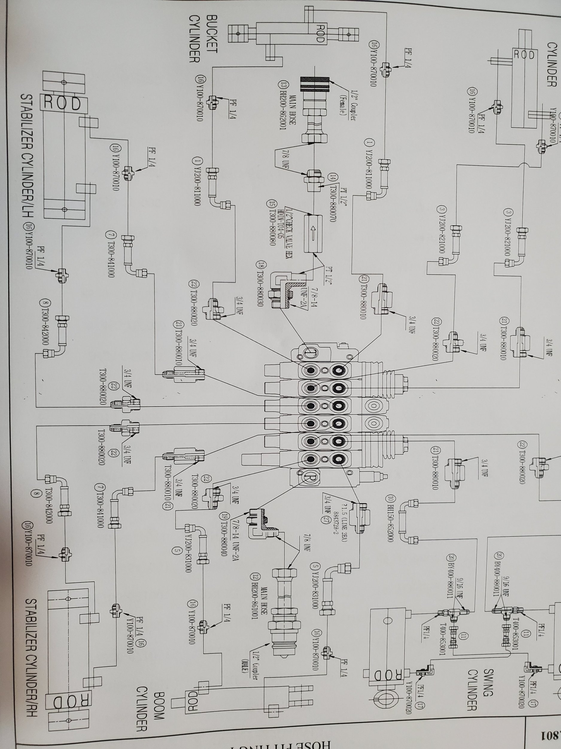

Need advise,
Yesterday my backhoe started acting up.
If i take the boom all the way to one side and then start turning it back, it goes 1/3 of the way, then stops for a second, then keeps going another 1/3, then hesitates again, then goes all the way to the end.
Pretty much same thing with the boom curl, when i extent it all the way out and start the curl, it stops in the middle, then keeps going. Same with the back movement when i try to extend it.
The oil is on MAX, clean as teardrop, so no problem there.
I called the dealer, he said he had never had such an issue. He also called TYM. They also scratch their heads.
The tractor is 2022 Branson 2515R with only 190 Hours.
Any thoughts?

How hard would it be to swap the hoses with the outrigger valves for a test? If the swing and boom work on those valves you can tell your dealer the problem is definitely in the first two valves in the series.

How does the Branson BH design their swing geometry? Got a diagram? Some BH use one swing cylinder and some two. Geometries vary. Your dealer sounds great; the tech team sounds a bit lame. That is partly a generational decline in mechanical abilities everywhere ..... but luckily here on TBN we have an advantage over traditional shop mechanics.
rScotty
I posted the diagram a couple of days ago and will attach it again. Is it what you are looking for?
Yes, it uses two rams. And my dealer is a great guy, however, he is not super knowledgeable in mechanics, it is why he parrots what BS he was feed by Branson geniuses.

Interesting that the "hiccup" always occurs at the same point in the arc. That would seem to indicate a mechanical binding not hydraulic.
Here is an idea: Remove both swing hoses from the valve body and put the open ends in a bucket. Then manually move the boom through the entire swing arc. The first couple of times will be purging the oil out of the cylinders and hoses. If there is a restriction you may or may not be able to feel it. I am betting not.
However, once the oil is out if there is any mechanical problem you should be able to feel that. I would curl the bucket up as close to the tractor as possible so that it lowers the mechanical advantage you have. If it moves freely that should eliminate any questions about the hinge pins and possible internal flaw of the cylinders.
If you can feel the hiccup after the oil is out, then you can disconnect one cylinder at the pin and retest. Then the other one and retest.
I don't think you have a mechanical binding problem and if you do it has to be significant to make the hydraulics slow down so you should be able to feel it when swinging through the entire arc by hand.
Other than that all I can think of is back to the hydraulics. As a process of elimination the next idea is a bit of screwing around but with some extra hoses you might be able to plumb the swing cylinders to the FEL valve, say the output lines to the bucket tilt cylinders. That would take the BH valve out of the equation and may give you some clues or confirmations. Flow and pressure tests are probably easier to set up if you have the parts needed.

ok, tried some things today:
1. Disconnected the rams from the boom. The BH swings freely by hand. So, no problem here.
2. Ran the rams without connecting them to the boom. Interesting note. The rams are connected between them hydraulically (llok the the diagram on the "Swing Cylinder" part) The oil coming out of one cylinder under the pressure goes to another cylinder to help in the movement, but the movement is not correlated between them as i would expect. They act like there is air inside. When one rod extends, it takes a while for another to start retracting,. I would expect it would to it immediately since all oil coming out of one cylinder immediately goes to another. But they behave with delay like there is a cushion or an absorber.
3. Swapped the hoses with the outrigger valves. no change.
4. I recorded the video, It came out terrible but you can get the idea

Since the swing cylinders were not mechanically tied together when you did your test the cylinder with least resistance will move first and then 2nd cylinder. One cylinder would have pressure to blind end the other to rod end so blind end would have greater working area and probably extend before other cylinder with pressure in rod end.
Be nice if TYM - Branson had a detailed schematic for the valve stack vs all of us trying to guess what is going on

Yes, I did see the original diagram. It's interesting. I've not seen a hydraulic diagram quite like that before. It looks to be set up for ordering parts rather than hydraulic info. What we could use for troubleshooting is a little more detail on how the various valves regulate the flows.
BTW, I believe that the diagram you posted disagrees with the description of how you describe the flow in #2 above. It is hard to be 100% sure without a flow or schematic diagram - and without more details about the T part BY400-8800111.....but if it is a simple T....then the way I see it, that diagram doesn't show that the oil coming out of one cyinder goes to the other cylinder to help in the movement. That's good. It would be odd if it did.
My guess is that in each extension direction the combined expelled flow from the cylinders is returned back through the valve to the sump without any regeneration. Take another look and see what you think.
