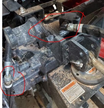

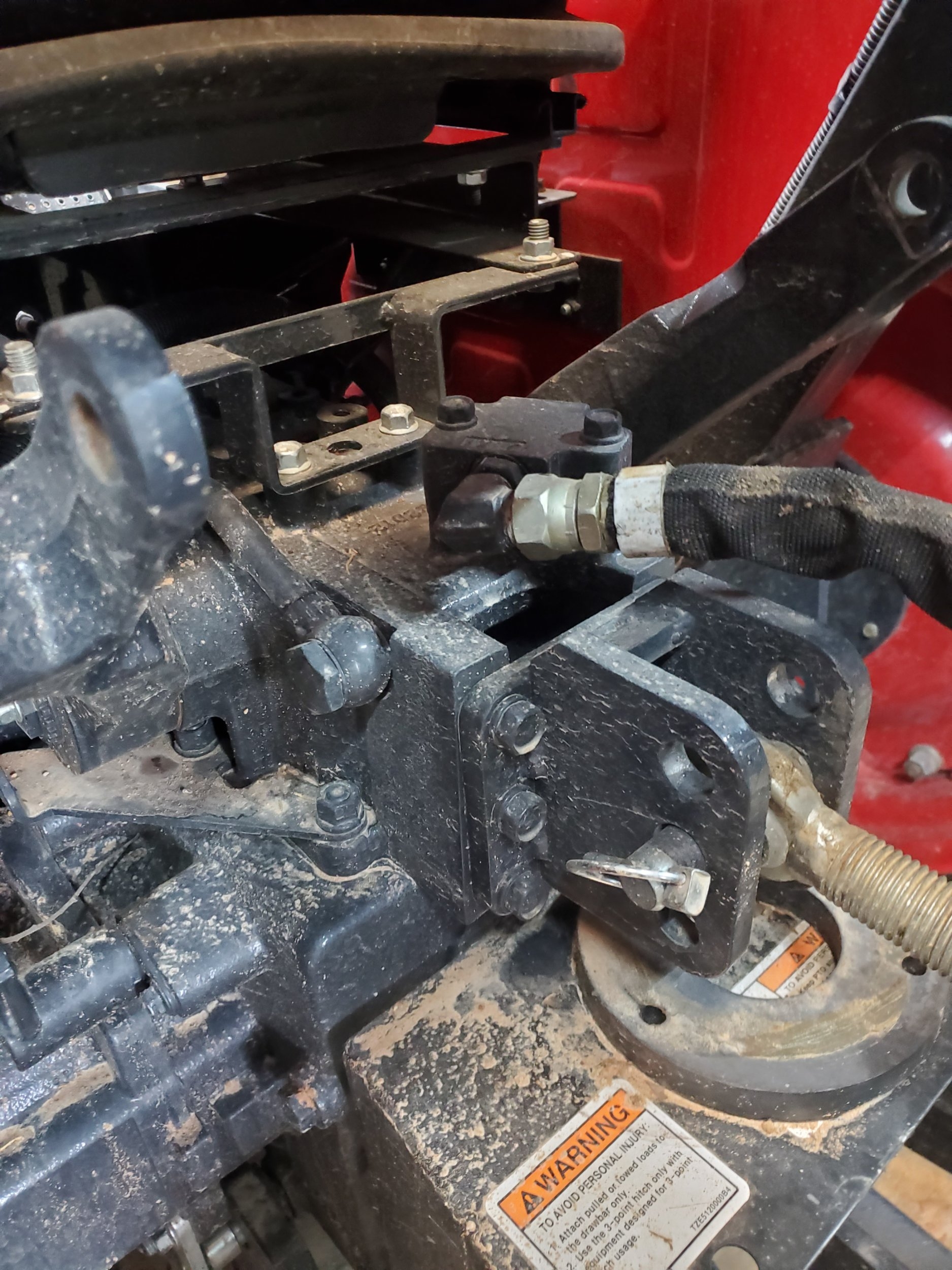

I attached the picture how the BH connected to the tractor.

OK. So it's time to start eliminating things.
BTW, that feed and return to the hoe looks like a homebrew hydraulic extention rather than factory remotes. Is that so? And if so, then the BH probably gets it's feed from the power beyond port - labeled PB - on the loader control valve. And so one of those hoses you have pictured is from the PB port - probably the smaller one to the left - and the other is the return back to the tractor transmission/hydraulic sump.
By the way, are you sure you don't have those hoses reversed? Do the fittings make that impossible?
It's not the hydraulic pump because the loader works well. That's great.
And It probably isn't the power beyond port up on the loader valve because that is just a port and a hose.
An important piece of info is whatever is going on affects all the BH functions. That means it isn't an air bubble in a cylinder or a bad backhoe control valve.
So that leaves either reversed hoses, some blockage on one of the lines, a relief valve n the backhoe control valve gone bad, or the hose connections.
Check the hoses for reversed first. Darn, I wish I was there with my pressure gauge.
Nest gently tap on the pressure relief valve or feel of it to see if it is jumping. The relief valve is usually the longest cylinder jutting out from the control valve block. Sometimes there are several. A relief valve It is just a pressure spring and poppet valve. Sometimes you can hear it operate. In normal operation the pressure relief doesn't do anything. If that valve is cycling as the hesitation happens then that is the problem. It should be quiet.
BTW, does the engine load down when the hesitation happens or does it speed up? Any noises?
It was installed by the dealer when i purchased the tractor+BH
They are different, no way to reverse, only one way to connect, besides, it worked this way before.
I attached the pictures of them

OH. I see in the photos that those connectors look to be standard aftermarket with standard thread. DO NOT use common plumbing fittings. It's just too dangerous. Please use hydraulic pressure rated parts. Any rural or tractor supply store should have them.
luck.
rScotty
Are you saying that that those ones are not good connectors? Which ones should i buy and how can i see the difference between the good ones and bad ones?
Also, i took a picture of the connection where the hose is connected. I guess it is PB point?

On the first picture, the #1 is a check valve that prevents you from running the BH if you accidentally swapped the hoses and fed pressure via the Tank port on the BH control valve.
#2 is the main relief valve for the control valve of the BH.
On the second picture, the line where the arrow is pointing is indeed the PB line that will feed the BH.

Interesting, meaning there is something wrong with the check valve because it got warmer. In my understanding, if it's función only to prevent backward connection, it should not work at all - get warmer ?
/ Backhoe problem #18
It should get at least the same temperature as the hydraulic fluid gets, probably slightly higher since it may cause a slight restriction there.
Even if it was bad, it wouldn't really affect much on the BH unless the hoses were connected backwards, but you already said it's not even possible.
