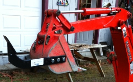

I have a BX24, so the BH is smaller than yours, and I bolted a stock boxblade ripper tooth from TSC onto the side of my bucket, so it protrudes out the 'backside' (ie: about 90 degrees from the front bucket sideplate).
It works great for stripping the soil away from the root structures at the base of the stump, which frees it up for pushing or rocking it much quicker than usual. I don't have enough hydraulic power to rip through thicker roots, but I can chisel them away bit by bit, if I can't conveniently work further away from the base.
Having the bucket still available is a big 'plus', because all the soil I strip downward refills my perimeter trench, and I can still scoop out the new dirt I've created.
I initially mounted the ripper facing upwards, but found it more effective to have it facing down, the same 'face' as the bucket itself. I used three 5/8ths bolts to lock it onto the side of the bucket, and haven't snapped one yet.
I don't generally leave it on the bucket, but whenever I attach it, I spend a little time ripping out surface roots around the lawn, or where I've compacted the soil with repeated tractor trips.
/ Backhoe Ripper tooth - Again #45
Here's a shot of the ripper tooth facing the 'wrong' way, when I first put it on. I now always mount it facing the other direction. It was a simple and inexpensive tool, that has really come in handy.

Have you ever actually removed a stump with your ripper. I realize the BX loader has limited curl etc but recall that they have been used successfully with ?Brotek rippers on stumps. If your adaptation works well it should be publicized to other BX owners. I would however be a bit concerned that the overall length of the ripper in your configuration would make it tough for a small loader to exert much curling force.

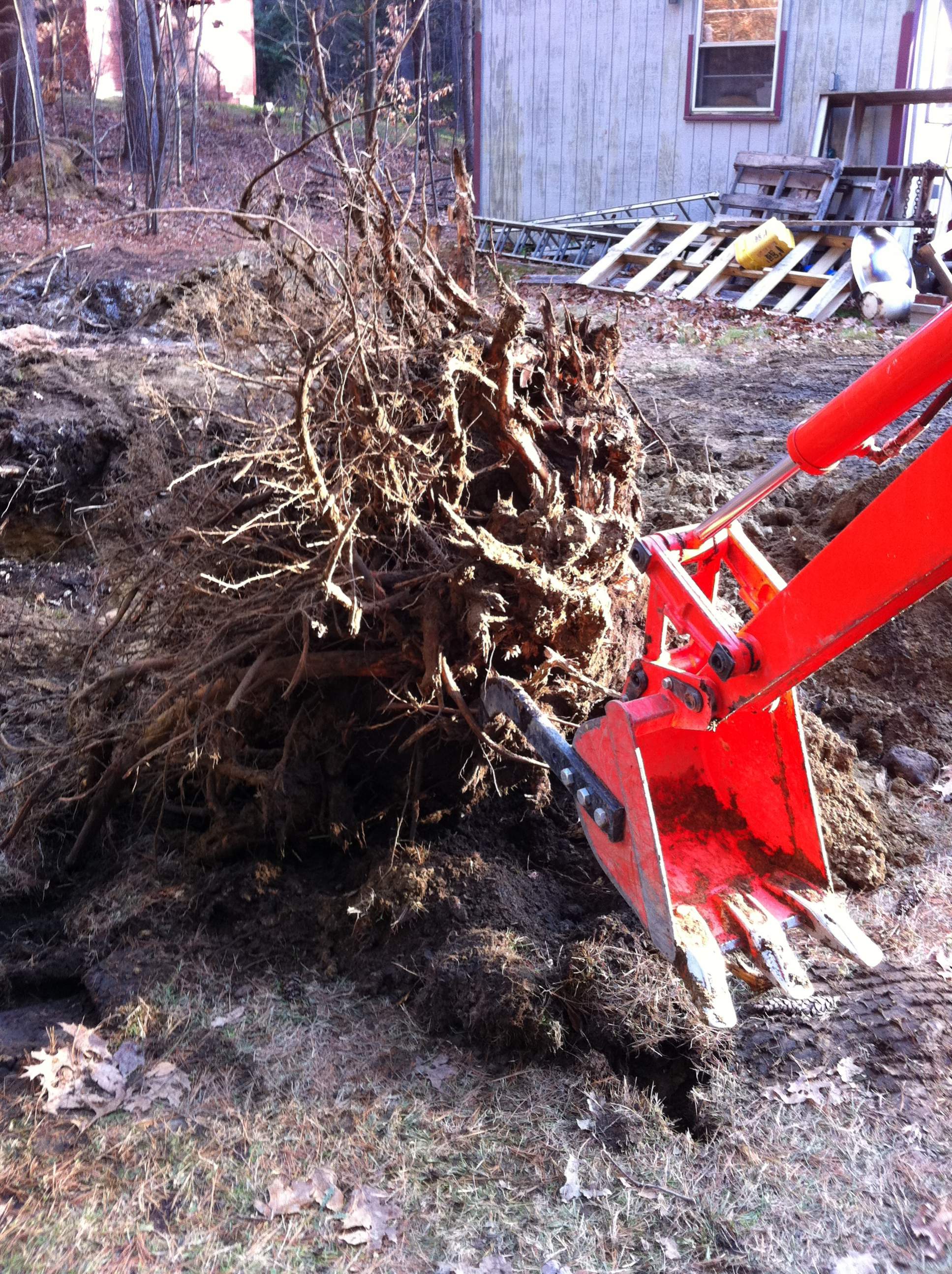

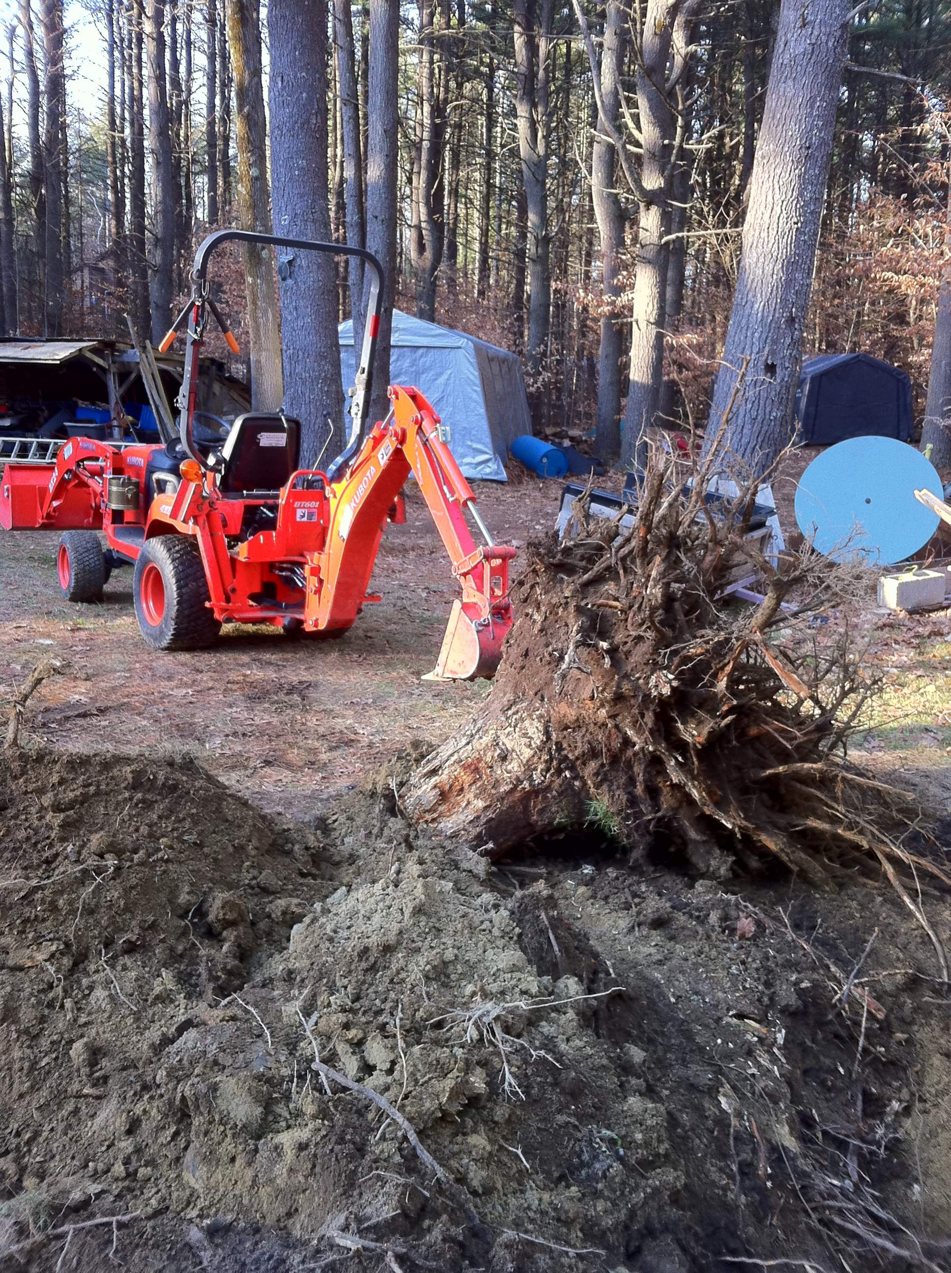

Yes, Island Tractor, I've used it quite a bit, and it has been helpful on several larger stumps, like the one below.
One shot shows the ripper being used to strip even more soil from the pulled stump, so it could be carried away... otherwise it would tax my capacity.

Nice. If you haven't done so already (I haven't seen it) you should start your own thread in the attachments section. Your el cheapo ripper should be very popular. I think most commercial options start at about $400-500 and require removing the bucket.
If I were doing what you did I might consider a backing plate and perhaps castle nuts or some system to allow quick in the field change over to plain bucket. That would be really useful.
