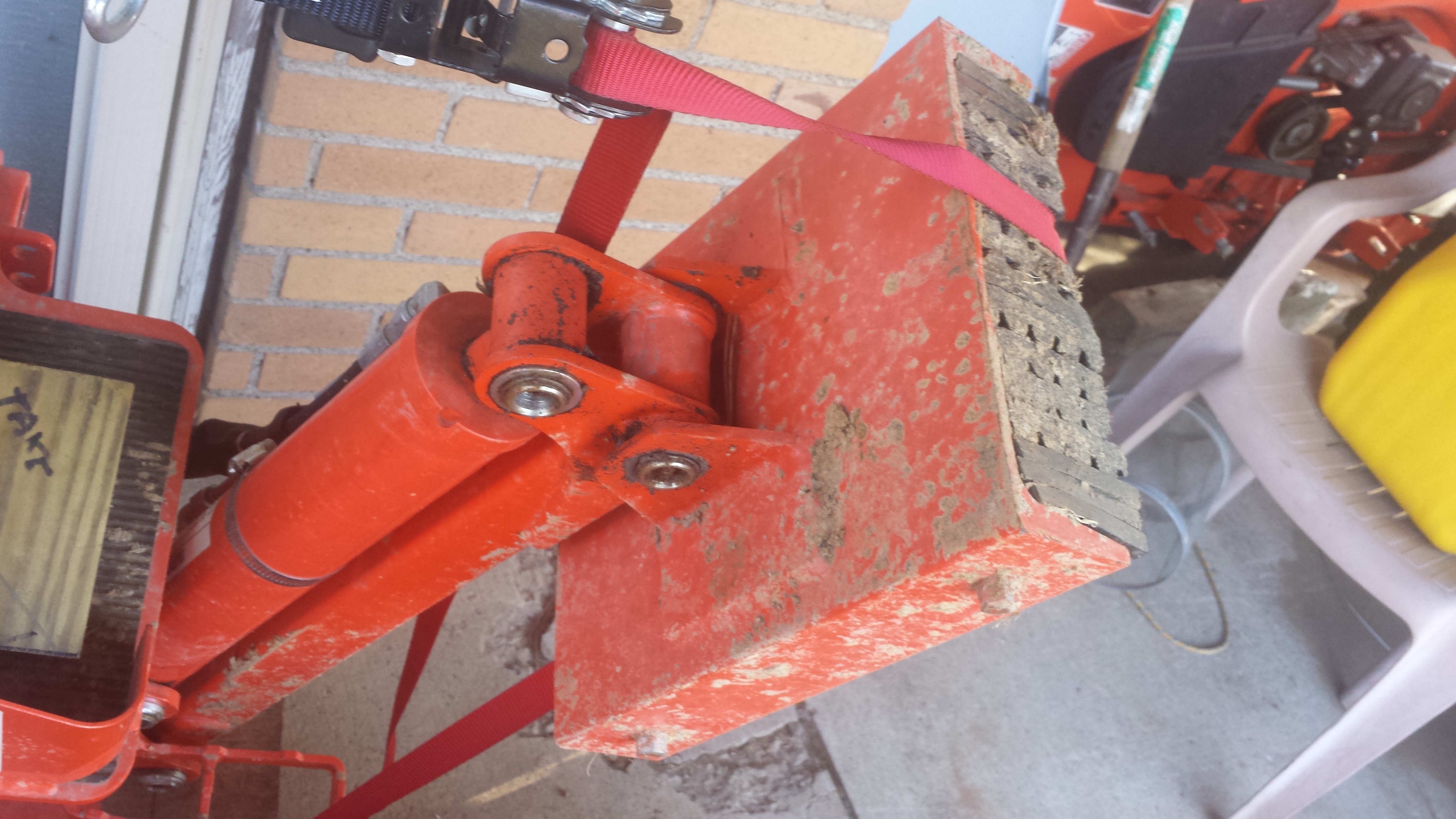

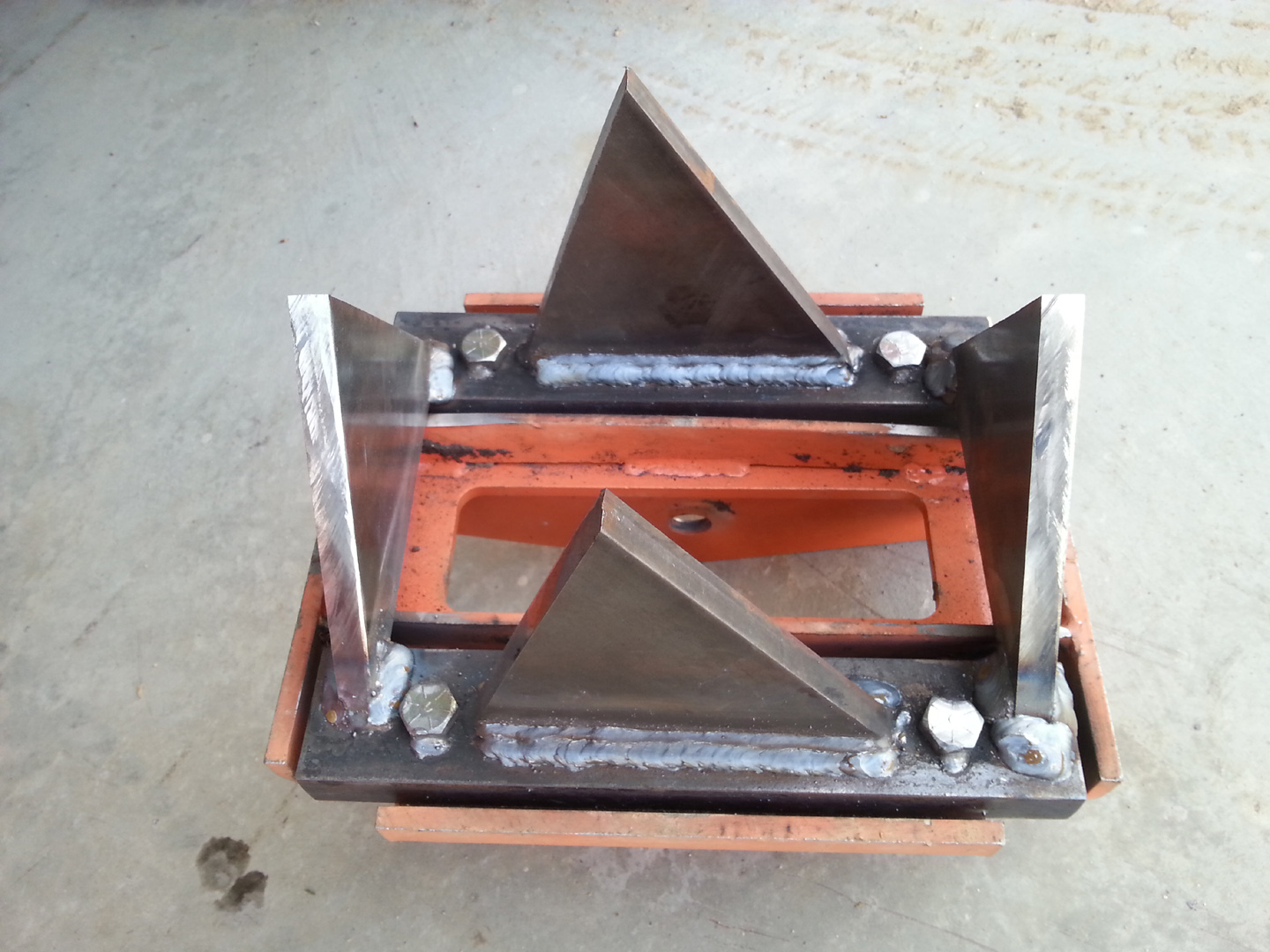

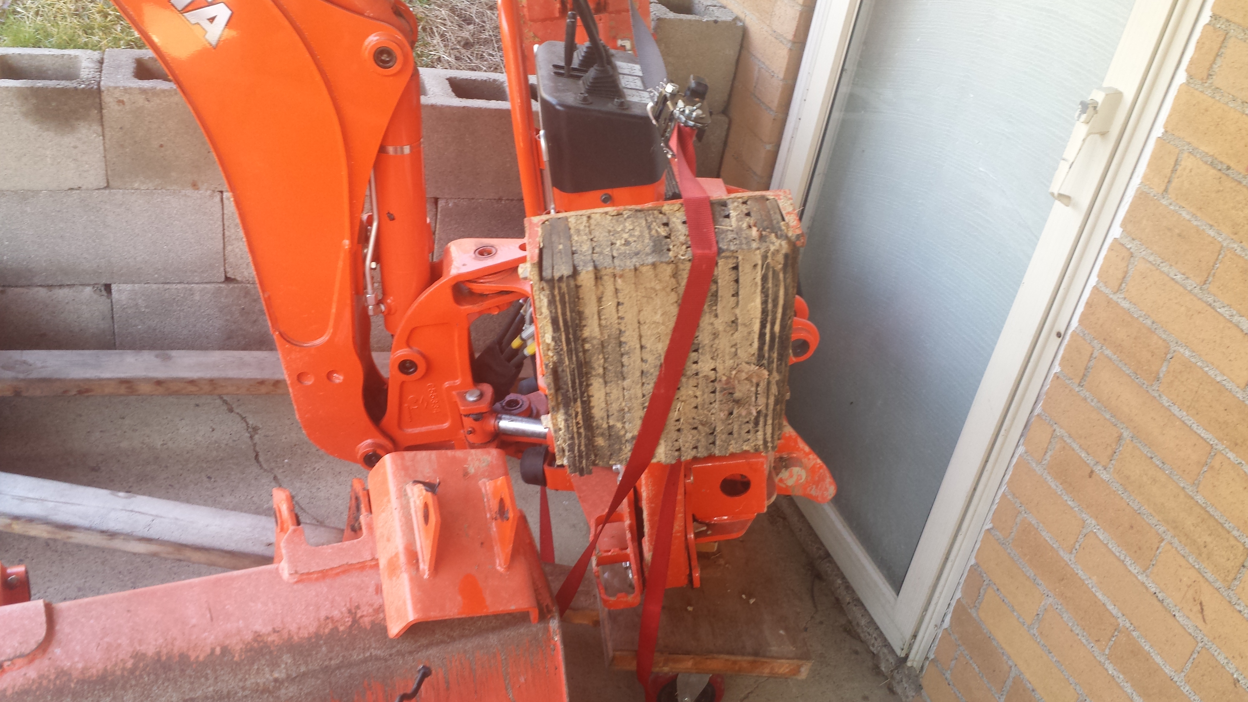

I also had a sliding around issue in digging out some stumps. My solution, which helped a lot but didn't completely eliminate the problem due to the weight of my tractor, was to make a steel wedge design. My stabilizers came with thick rubber pads, 2 per pad, for use on asphalt/concrete. Each rubber pad has 2 embedded studs for mounting. I simply used 1 inch x 2 inch steel stock in their place and welded on 4 wedges made from 5 inch wide, 1/2 inch thick stock.
Man I would hate to walk a bit too close to those when in raised position. Those look downright dangerous to the operator. A rectangular box of plate rather than the triangle spears would have worked just as well and not ripped flesh from your body if accidentally contacting them.

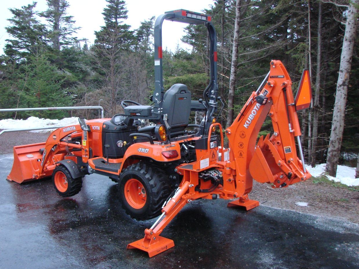

Planning to cut, drill, and bolt on some channel iron here. My hoe is constantly dragging me to the stump with the street pads.
DOH! Man do I feel stupid. I was reading the operators manual on my backhoe today and see that my pads are reversible. All I had to do was raise them up and flip them on the pivots. Didn't even have to take a pin out or nuthin.
