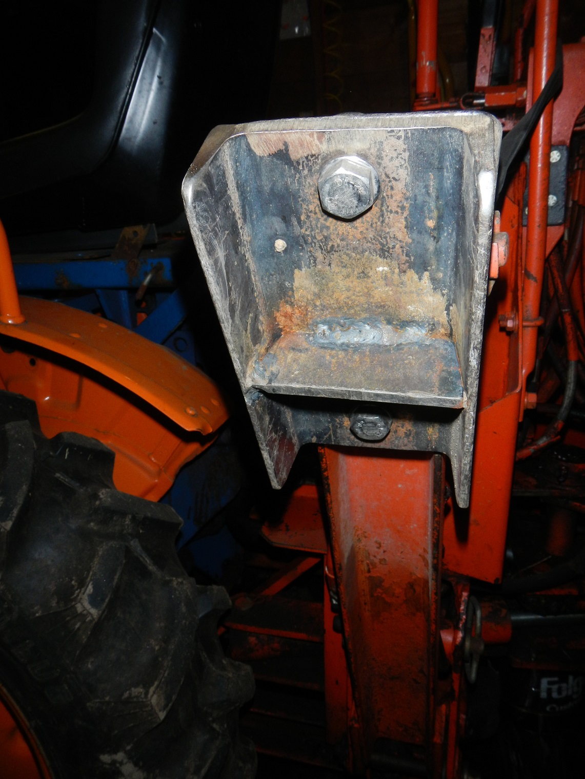

/ Backhoe Stabilizer Pads/Claws #4
DSCN2901TBNFoot2.jpgDSCN2900TBNFoot1.jpg.
Hot rolled U channel w a welded in cross piece.

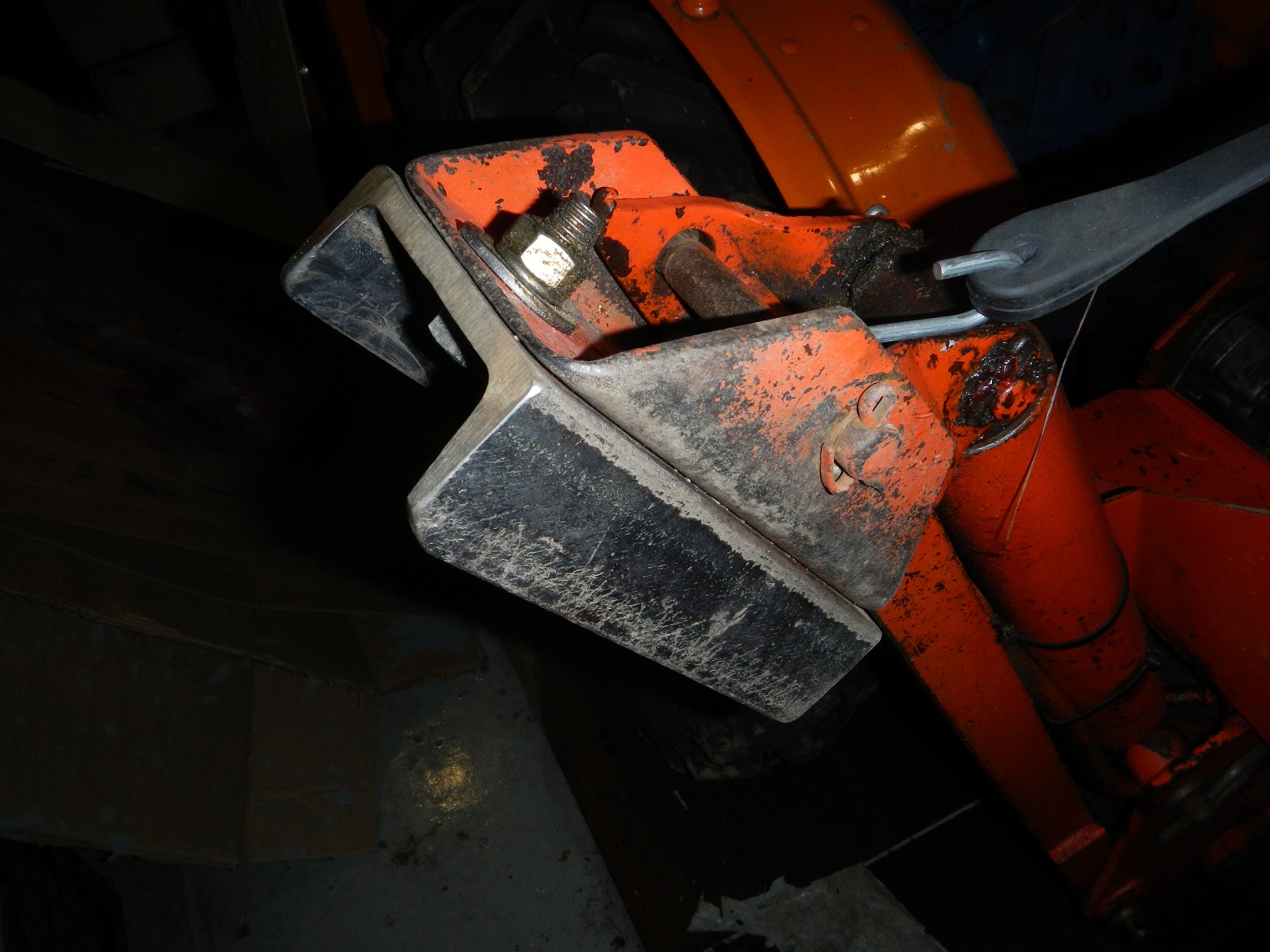

/ Backhoe Stabilizer Pads/Claws #7
image-4021653704.jpg I built these. Love them. Go on/off in under 30 seconds

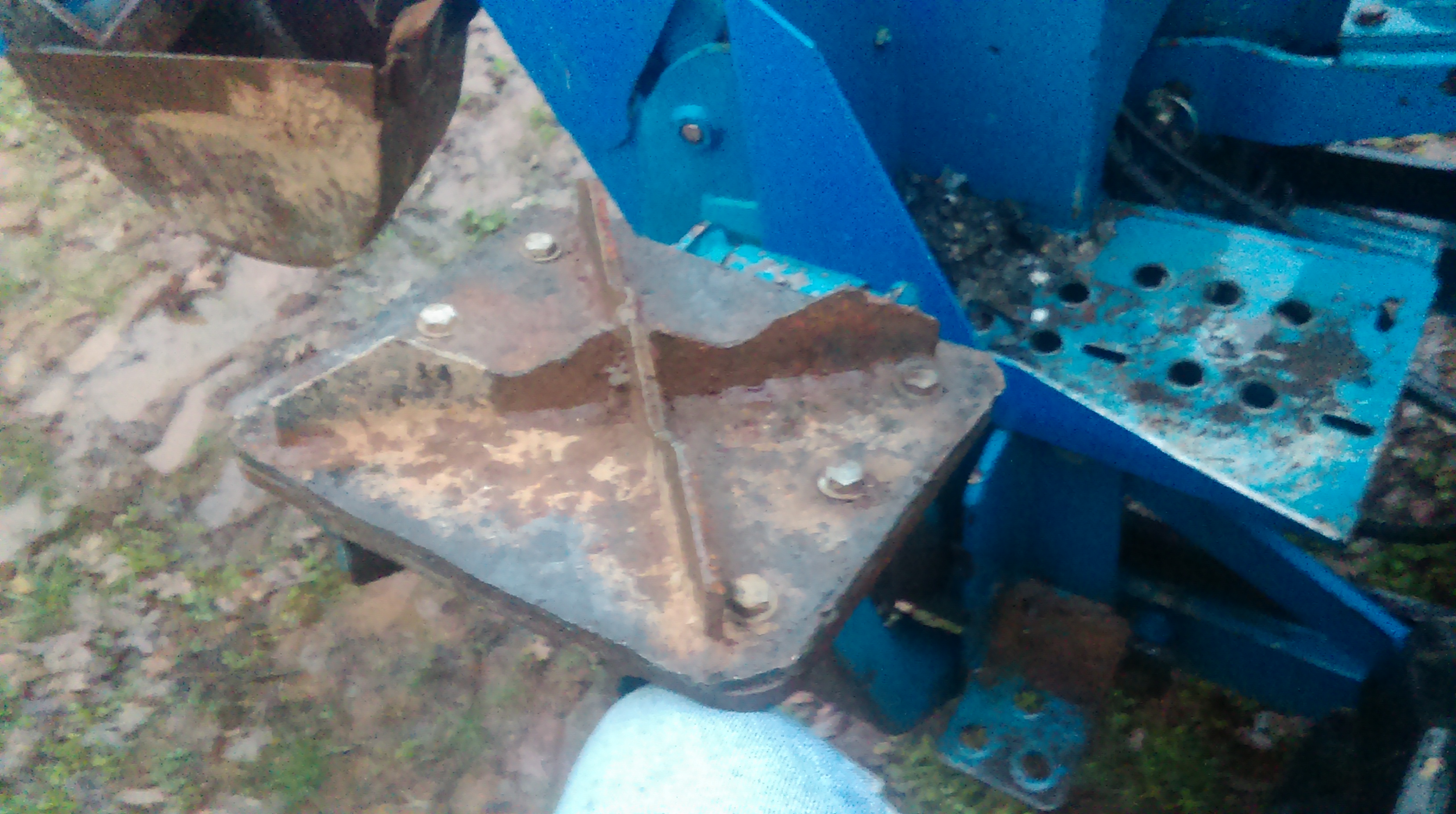

/ Backhoe Stabilizer Pads/Claws #9
Forgive the bad phone picture , it is pouring down rain and I was getting WET :ashamed:
Built these for my 757C on my New Holland . 1/4" plate for base and teeth . 1 tooth is solid all the way across , then other is tee'ed into it on both sides . Made a Huge difference in how the tractor does not slide around anymore .

I like that.
Does the plate unbolt? For is you needed to work on concrete or blacktop?

/ Backhoe Stabilizer Pads/Claws #12
Yes , They unbolt pretty easily . You can see the bolts down each side , other side of bolt has easy access also . Am still working on ideas for Asphalt / Concrete pads . Something similar to this but without the teeth . Instead have rubber / canvas belt or ??? material . I to was not spending major $$ for pads . Think I have maybe $40 which includes the gas in pickup to go get the scrap 1/4" plate .
