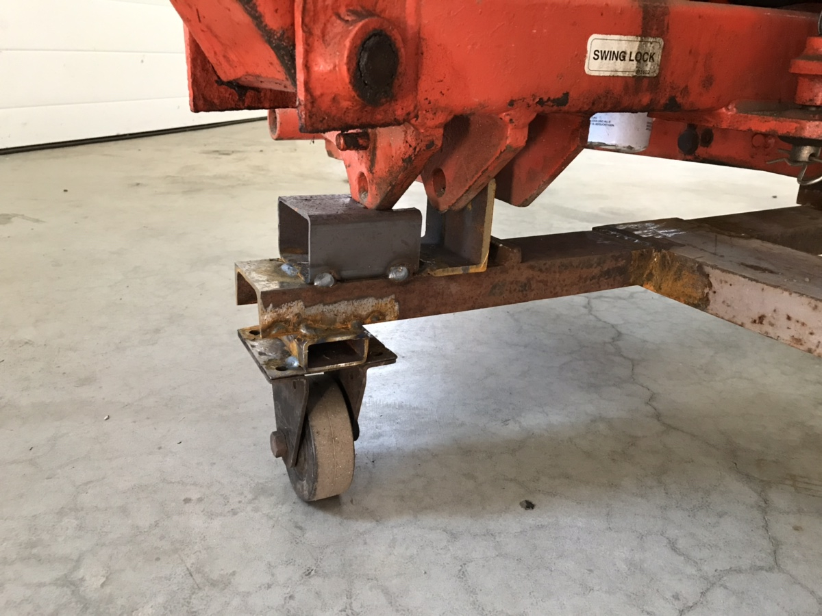

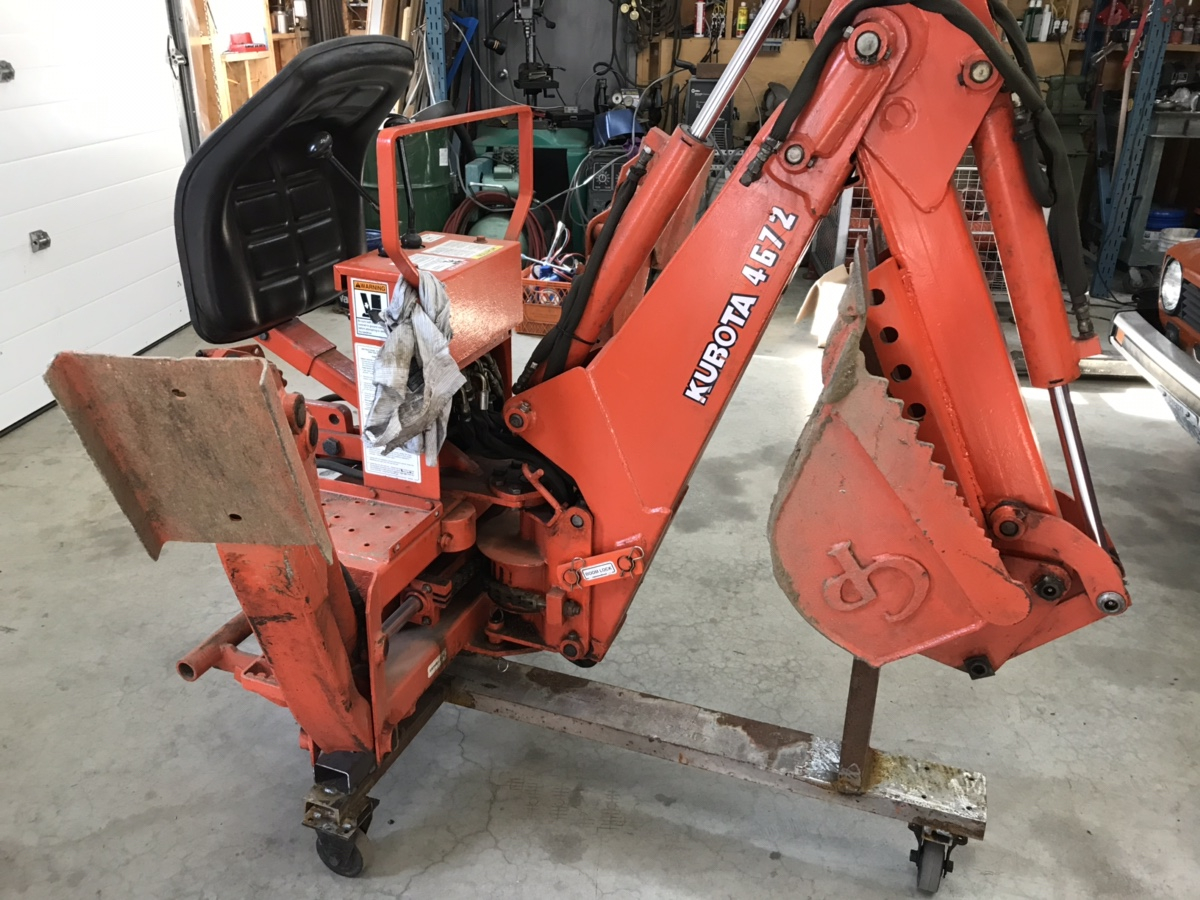

I built a very simple and ugly dolly the right height to remove and install my backhoe. Having wheels to move it around makes installing and removing much simpler not mention storage.
The backhoe is ‘sunk’ into the dolly and cannot fall off and I don’t think I could tip it if I tried.
I was going to clean it up and paint it but… meh.

I think a your dolly is very cool! Well designed for your equipment to safely store. Not everyone has your skills.
