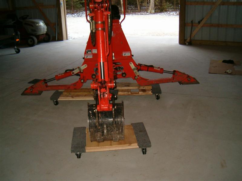

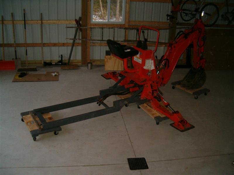

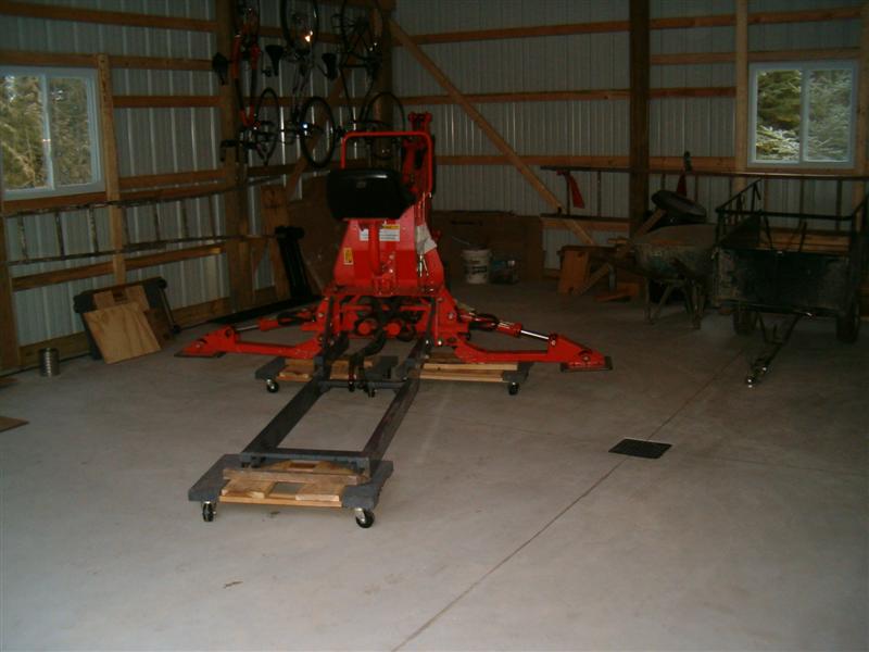

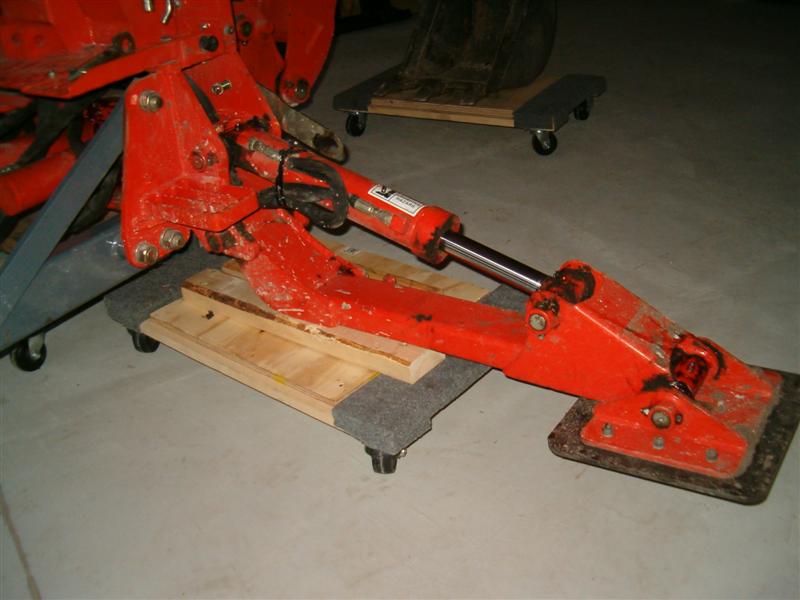

/ backhoe storage #7
I went to Home Dept and bought four of those four wheeled furniture dollies. I sheeted the top of each one flush with 3/4" plywood or some 3/4 hardwood boards. With a shim or two this turns out to leave the attachment at the perfect height. On a concrete floor I place one at each outrigger hinge (not the outboard pad) where the arm attaches to the frame, one at the front end of the subframe and one beneath the bucket sitting flat on the top of dolly with bucket parallel and touching top of dolly. Dipper is plumb.
The reason I place the backhoe on wheels is not only do I gain mobility on the pole barn concrete floor but it is very nice come Spring. It's always nice to have the ability to roll the backhoe a tiny bit one way or another when remounting the machine.
Like others have said, a shot of grease for each zerk drives moisture and dirt away and some wd40 on the hydraulic cyliinder rods.
