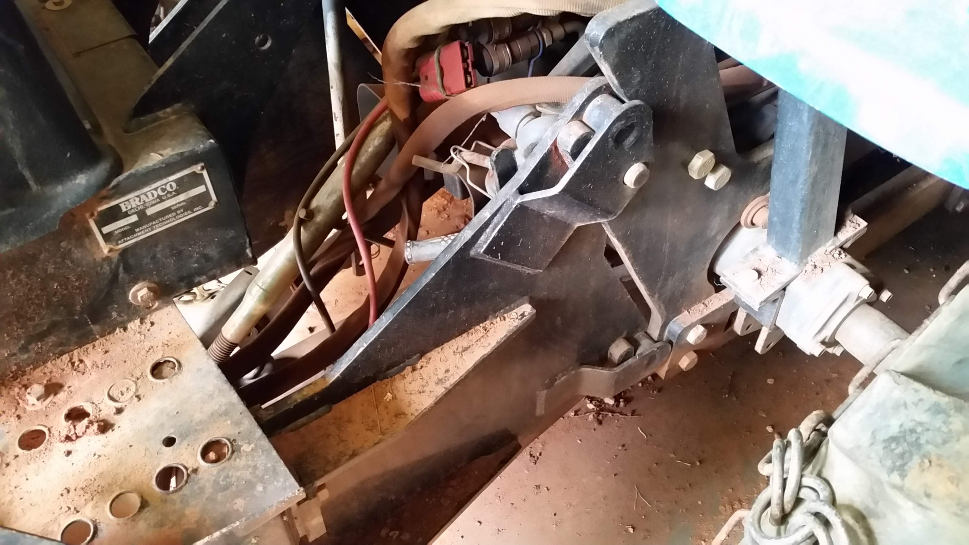

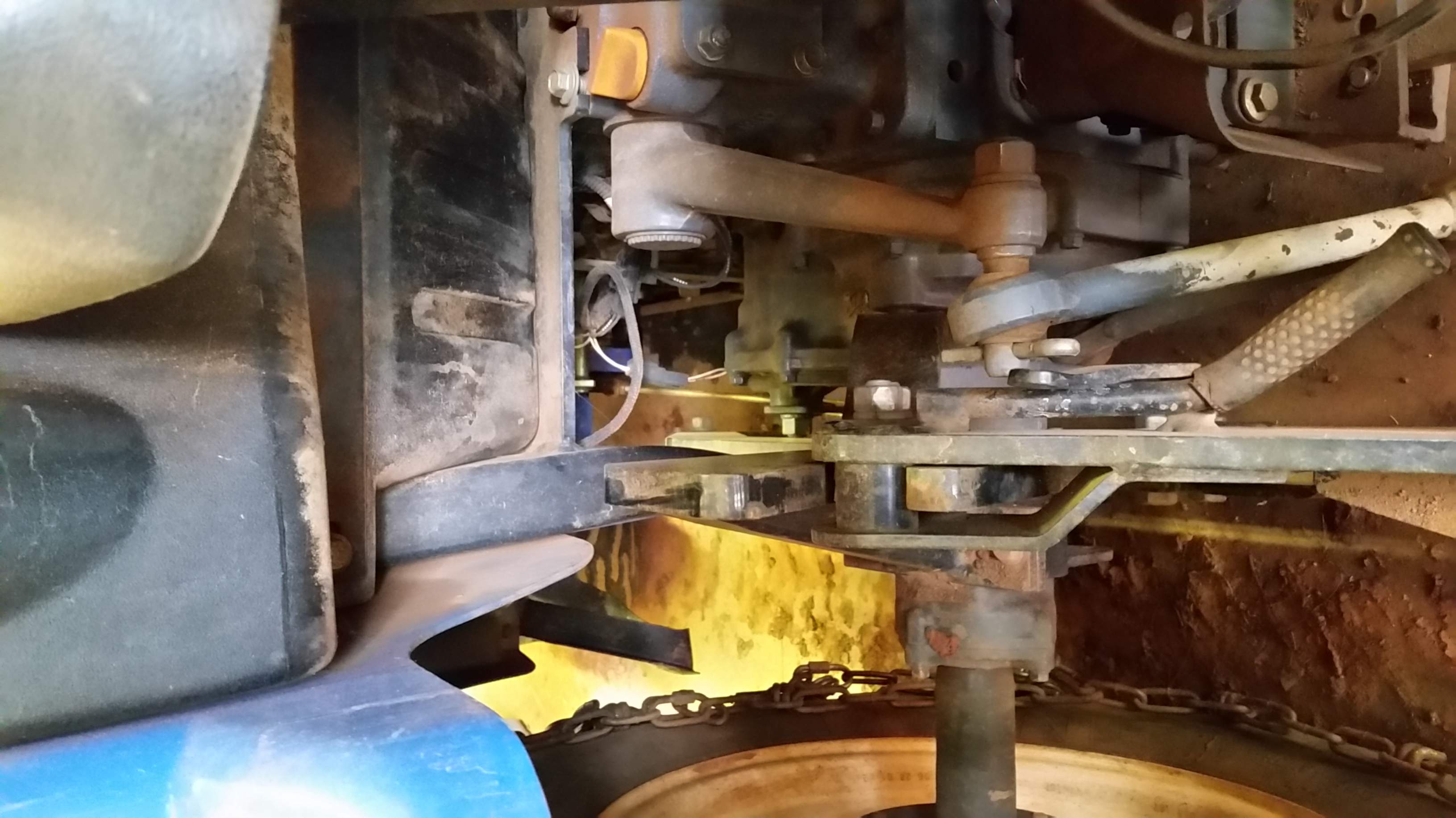

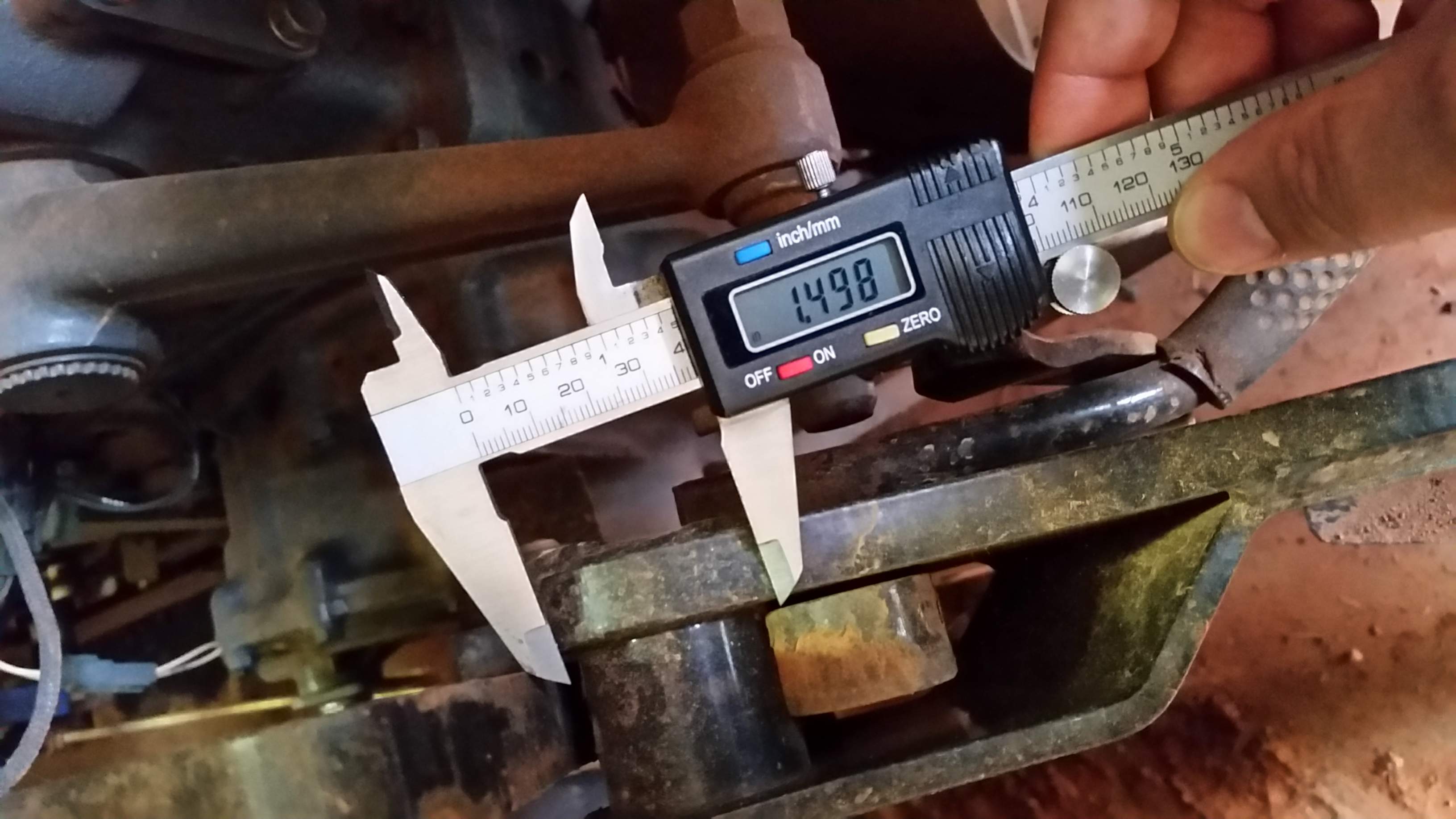

Here are a few better pictures of the 'donor' mount I'm using for reference in my build:

The schematic from michironandequip shows two brackets that are mounted on the machine. These brackets stay with the kioti and accept the backhoe subframe. At only two locations.
   / Backhoe Strong? #36
The Kioti has two brackets at the front of the tractor and a saddle type bracket at the rear that is attached to both sides.
Essentially both Woods and Kioti subframe link the BH to four strong points on the tractor. The real difference is simply that the portion of the subframe that tie front and rear and left/right support points together are permanently mounted to the tractor on the Woods and mounted integrally to the subframe on the Kioti.

Yes. Here is a post I made last week in response to someone who was trying to build a subframe for a Kioti. The photos show from various angles the portions of the subframe that are attached to the tractor and those that are attached to the BH. If you look at all the photos I think the story will be clear. Note that all the gray metal below the PTO is part of the subframe attached to the tractor. There is one shot of the BH dismounted and you can see the ladder part that slides into the slot on the tractor mounted subframe to be pinned in place. I know exactly where they are so I can see the holes where the pins are inserted but I admit it doesn't show well in the photo.

The Deere 448 backhoes use two plates mounted to the transmission housing and ROPs mounts. Once the 3PH draft links are removed, the 'hoe is lifted with the rockshaft lift links, two pins (each about 1.5" in diameter) are installed through the 'hoe frame and tractor mounted plates. The lower 'hoe frame sets in two slots in the tractor mounted plates. After all that, the lift links are lowered and the backhoe hydraulic hoses are plugged into the tractor's hydraulics.
