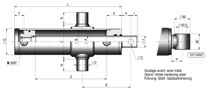

Whoops, i was talking about the crosstube end of the rod, not the cylinder body.
I didn't get far enough into it to verify but it seemed to me like these were probably 'trunnion mount' cylinders, like this:
I didn't understand the comments i was seeing about how 'nothing holds the cylinder in, you can just pull it out' but after reading what i came across about a system maintaining low pressure even on the side you're not activating, i guess they would hold themselves in place as long as everything in that system still worked.. seems sketchy from over here across the internet without looking at it in real life, but maybe it's totally fine!
