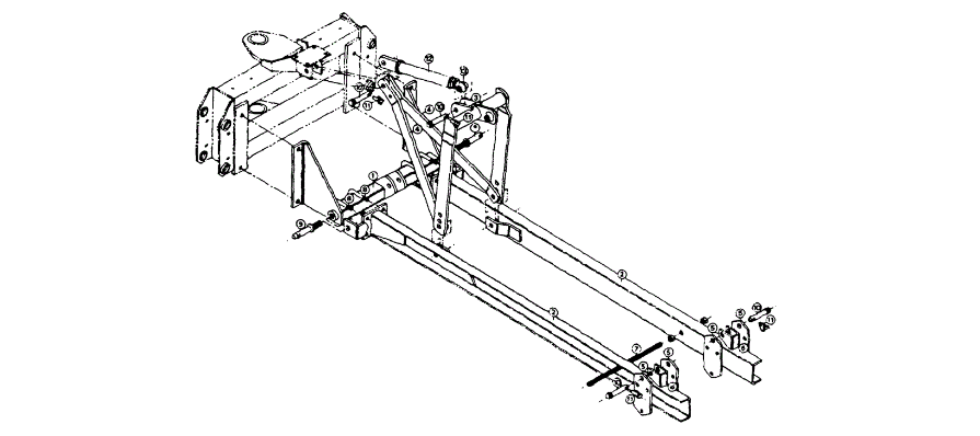

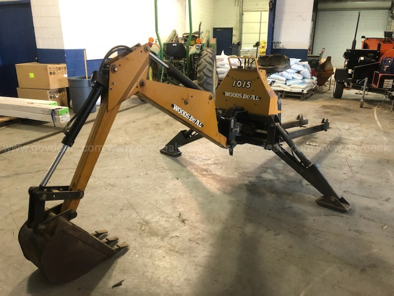

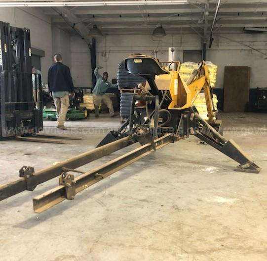

Another update, I just bought a Woods Du-al 1015. Most dimensions are within inches of the KIOTI KB2475L so should be an appropriate size for my CK. Too far away to inspect it personally but looks to be in great shape.
It comes with what was an optional PTO pump system so I'll have options as to how I want to power it. It also has what was the optional "Universal Frame Mount" (subframe) system, which probably won't be "universal"enough to fit my CK but will be a great foundation to build a customized subframe.

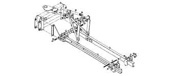

I've never seen anything like this universal frame mount. Apparently it attaches to the tractor chassis at a forward position, but then uses the lower 3 point arms and upper 3 point link mount to support the rear? I suppose the concept was to treat the 3 point system as a pivot transferring energy to the forward frame mount? Needless to say, I'm skeptical. I've attached an image of the universal frame mount, anyone here seen anything like that?
Apparently at some point Woods acquired the Du-al line and this unit must have been built early in the transition, it has both Woods and Du-al labeling. I contacted Woods and they were kind enough to send me a PDF of the original owners manual, nice guys!

Looks like it will not take much to adapt! The three point stuff should make the back half nearly universal.

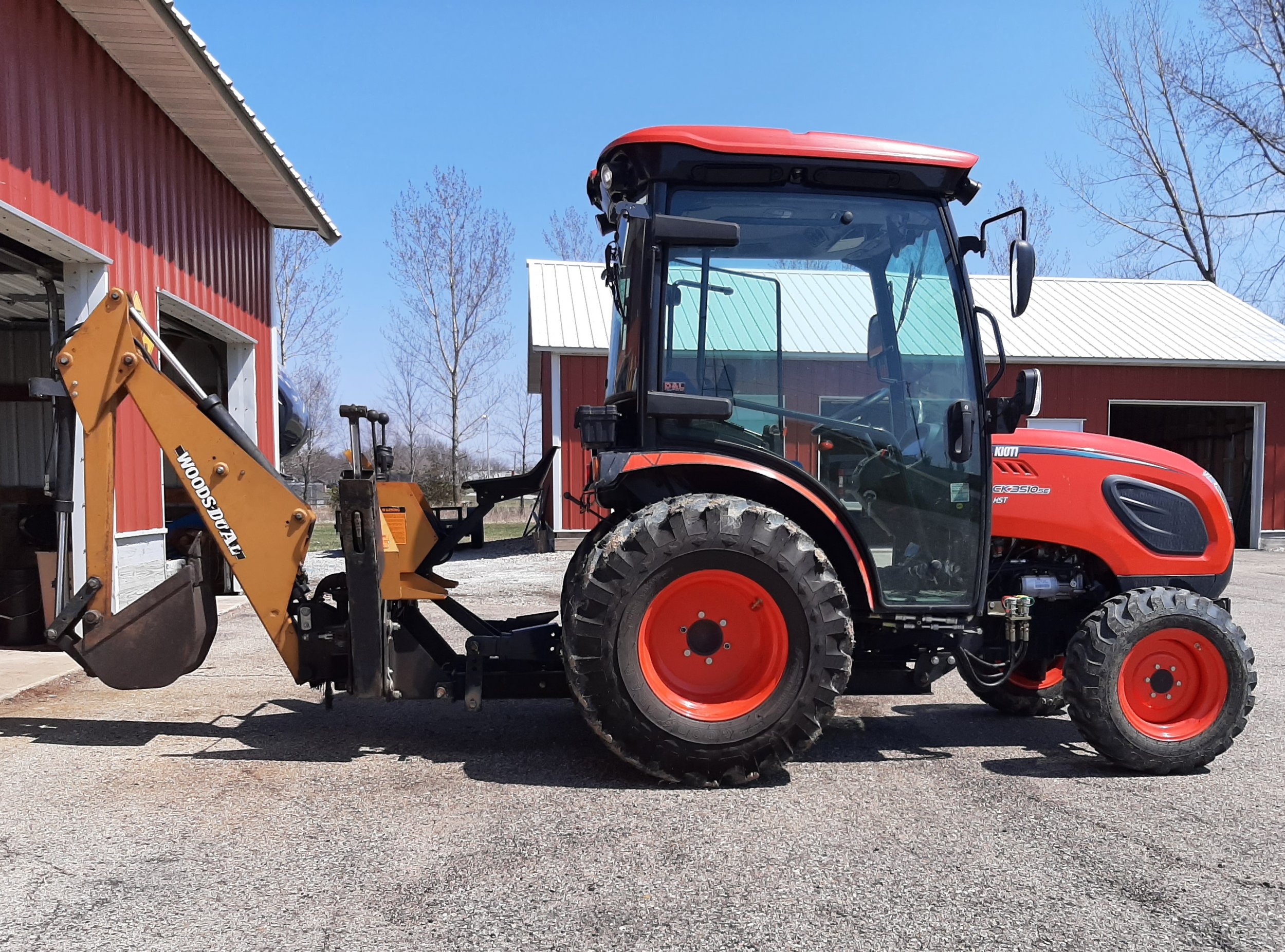

I returned home with the backhoe a week ago and have been working on adapting it to my tractor. Attached is a pic of the initial fitting, I have a few tweaks to make and maybe more once I see how it behaves after operating it.
If anyone is interested in the mounting details I can post more detailed pics. As planned I modified the "universal" subframe that came with the hoe. I have a front mount snowblower and used it's rear tractor mounted brackets for the forward mounting points of the backhoe subframe. It worked really well, a 1 1/8" diameter pin joining the hoe subframe to the tractor about where the rear mounts of a front loader would be located. For the rear of the hoe subframe I created lower 3 point arm pins which I use to lift the subframe up until blocks on the top of the subframe contact the underside of the trailer hitch plate, the blocks nest nicely within pockets on the underside of the trailer hitch plate. This is primarily for transporting as the subframe will push up against the underside of trailer hitch when the hoe's feet are deployed. These are essentially the same mounting points that the KIOTI backhoe subframe uses. The top link of the 3 point hitch is not being used in any way.
Now I've moved on to the hydraulics. I have the feet and boom rotate functioning but the boom cylinder leaked. I disassembled the cylinder and found a defective rod seal. I have a replacement ordered so can't do much more until it arrives.
Anxious to get all the hydraulics functioning so I can see if the subframe needs any additional reinforcement.

Nice! Is there anything that holds the hoe up to the trailer hitch housing other than the lift arms? I would worry that the lift arms would leak down over time.
Dave
   / Backhoe thoughts....
Dave
Currently only the lower 3 pt arms hold the subframe up. As you said, I could add structure so the trailer hitch holds it up I'm not sure I want to. When not in use it's kind of nice to be able to lower it to the ground just to take the weight off of things. We'll see, I might change my mind.
