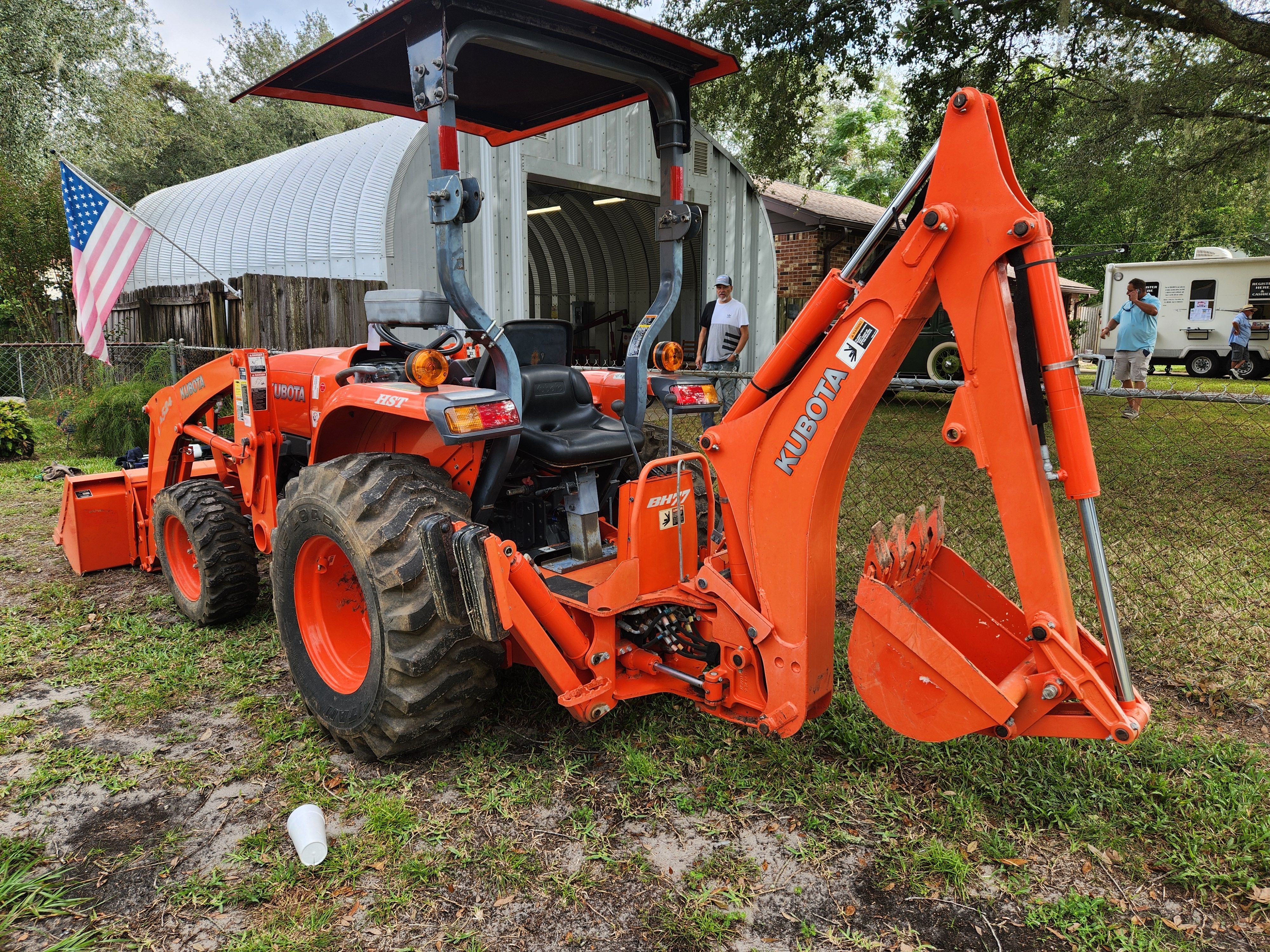

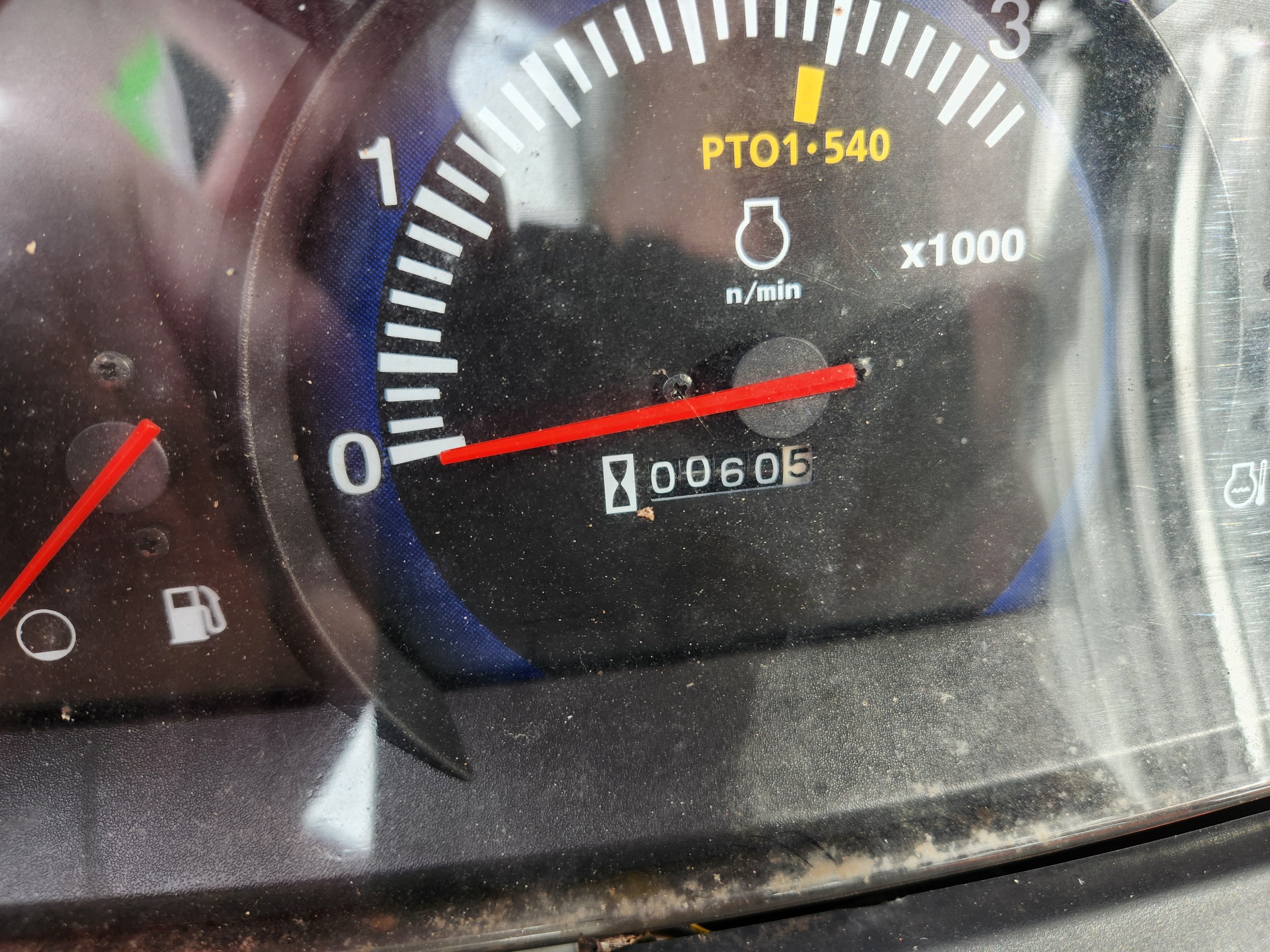

Kubota L3200 4x4 Quick Connect Loader and Bucket. Quick Connect Backhoe. 32hp. Only 60hrs. Came from estate sale. $28,500. Located in Tennessee. John 904-813-4740
