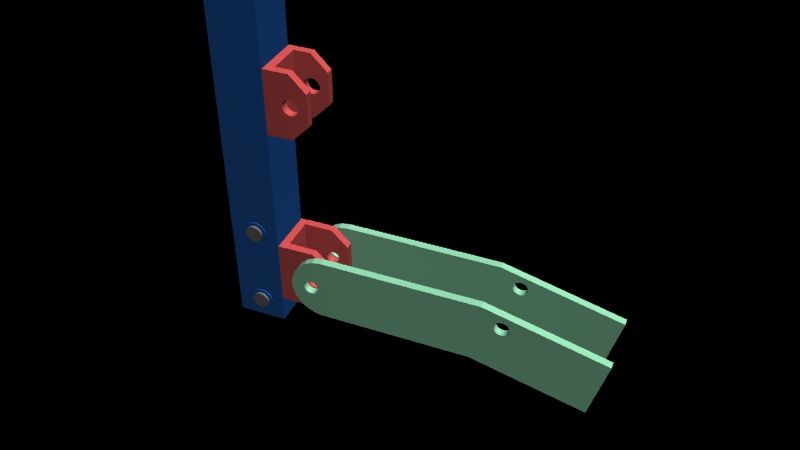

Thanks for the tips. I'll be TIG welding most of it, so it will have time to get pretty hot :)
Welding is part of my vocation, but I very rarely weld anything thicker than 1/4", I do mostly light industrial stuff, custom shelving, brackets, funiture etc.
I'll be MIG'ing the stuff to the dipper, .045 "outershield" wire....so there could be some more tweaking there...although I'll probably "box" the brackets a bit with some 1/2" plate to try to keep them stable.
Below is a basic image of what I have planned.
My largest drill bit is 1 7/64, so I was thinking I'd work up to that, then use the boring head in the mill to take it out to exactly the fit I want. Or maybe drill, then weld, then put the whole bracket in the mill and align bore the holes...assuming my boring bar is long enough.
The dipper is only 3" wide...not going to be a lot of room for bushings. A Cat 1 top link is 1.5" wide at the pivot, so 3" minus the two 1/2" plates leaves 2" between them, or 1/4" of free play on either side at the top end of the top link. At the bottom I may offset the side plates outside the dipper to get more width for stability at the hinge (an idea not shown in the image)...so bushings will be called for there.
Before I start I'll tweak the images and submit for final comment :)

Johnny, the bracket you weld near the end of the dipper is mounted
to some pretty thin steel, so you may want to have it wrap around the
dipper so the tension forces do not distort it.

Yep, that was a worry of mine. Do you think wrapping some 1/4" flat around there would be enough? I'm thinking the 1/2" would be a bit much. Maybe just some side plates to sandwich the dipper?

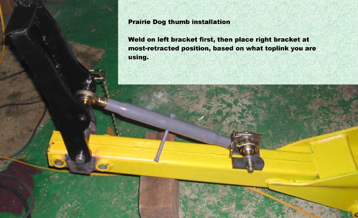

Here is a photo of the parts for one of my mechanical thumbs....I put it
in the form of a kit for the last guy I sold it to. The dipper bracket for
the thumb pivot is just 1/4" steel, but it extends along the sides all the
way to the other side of the dipper. Forces are distributed along the SIDEs
of the dipper, and the welds are in shear, not tension. 1/4" is strong
enough, but thin enough to install below the level of the other 2 dipper
pivot hole bushings, which sit proud of the surface by maybe 5/16-3/8".
That way, the bucket action does not hit the thumb bracket. All of these
(six total) have stood up well. My dipper is only 3/16" thick!
The photo is from one of my thumb threads....you can see the dipper
bracket welded at the lower left.

Yep, I should be able to squeeze some 1/4" between the bucket pivots and sandwich the dipper as shown in your image. Same issue on my dipper..it's 3/16" too.

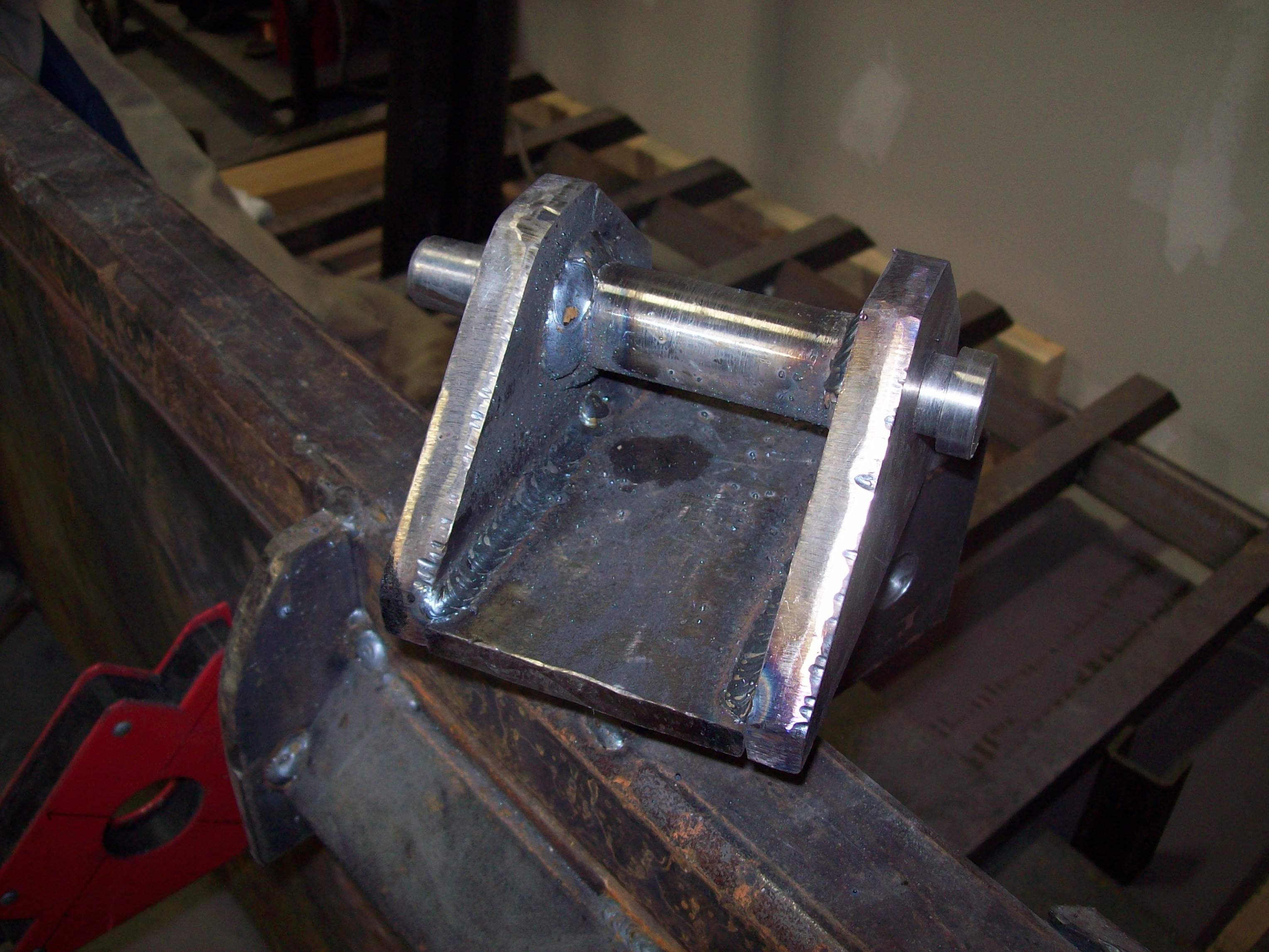

I haven't used may thumb very much to give much input...however I have been digging in the frost for the last several days, That bottom thumb mount takes a beating, soooo........ make it tough or you will bend it!!:) The cross tube for the pin adds a lot of strenght, so far mine has done well.
