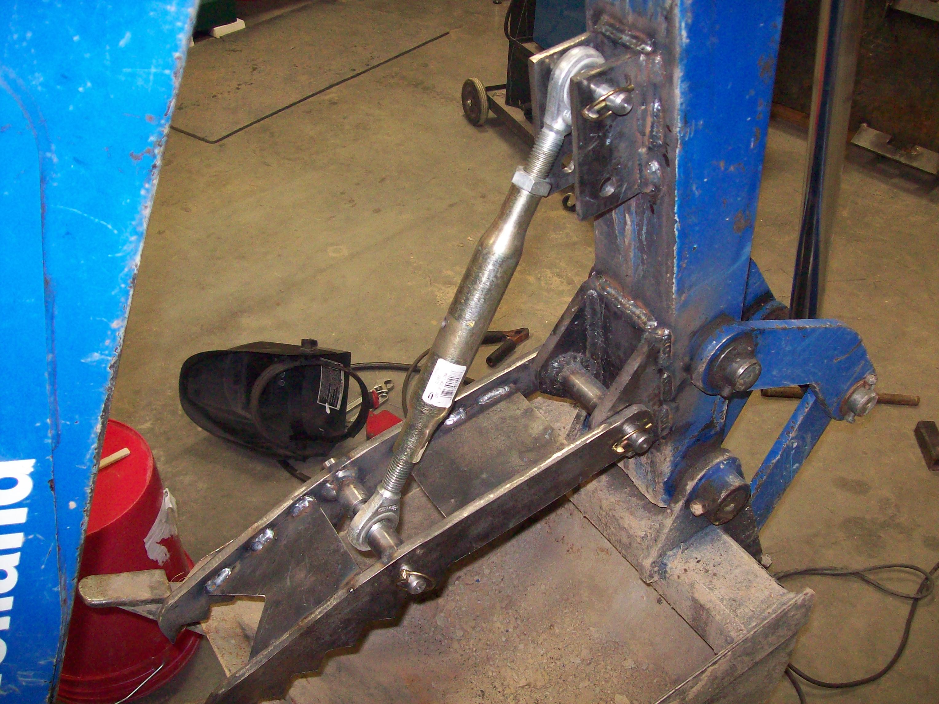

Pilot,
How wide is that, do you remember?
Looks exactly like what I was planning for the pivot.
JohnnyB
   / Backhoe Thumb...weld or bolt? #42
dataway: I'm not where I can measure it , basically the lower mount is as wide as the boom.
I didn't wrap the side of the boom like dfkrug, time will tell if that was a wise choice:)
Mark
#43
I'll just be going about 1" wider than the boom if I have the room.
I'd imagine carrying around a 12' long log the twisting forces could get pretty high as it rocks around. I'll follow the "low and slow" rule :)

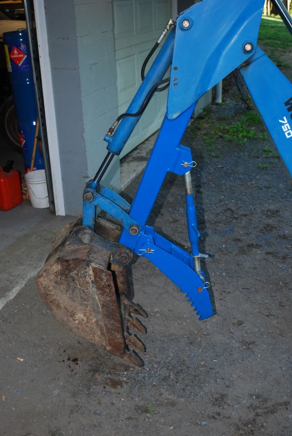

Thumb almost finished...just need to add some cotter pins.
Tested and working nicely.... thanks for all the advice.
