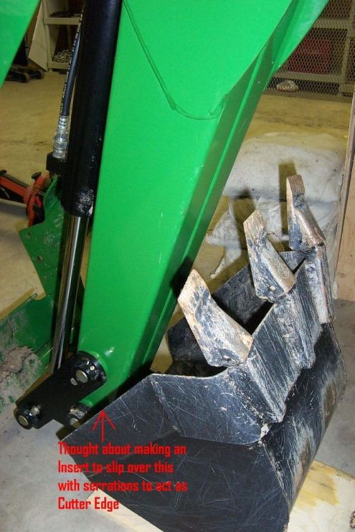

Backhoe Tree Root Cutter Winter Project
/ Backhoe Tree Root Cutter Winter Project
#21
Kevinro.....
Thanks for Link, much appreciated.....
I'll call them for a price, who knows, eh ??
Big thing will be pin size, distance between pins & width.
Once again, thanks a bunch
Eric

/ Backhoe Tree Root Cutter Winter Project #24
This is a picture of the boring bar going through the plates forming the attachment to the dipper stick. Boring bar is enlarging the drilled holes to their finished diameter for the pins. This should give a pretty good idea of the mounting. Don't think I have a picture of the tooth but it's 2 plates bolted and welded together. It had a lot sharper edges when it was built than it has now. SteveV
#40
Henro...
I'm still working this in my head & the reason for my original post was to ask for ideas & I want to say thanks to you and all that have posted. Further to your posts, I scratched on paper a possible redesign along the lines of what I think that you're talking about. Take a look at the attached pic & tell me whether that's what you're thinking or something else ?? Thanks, Eric
