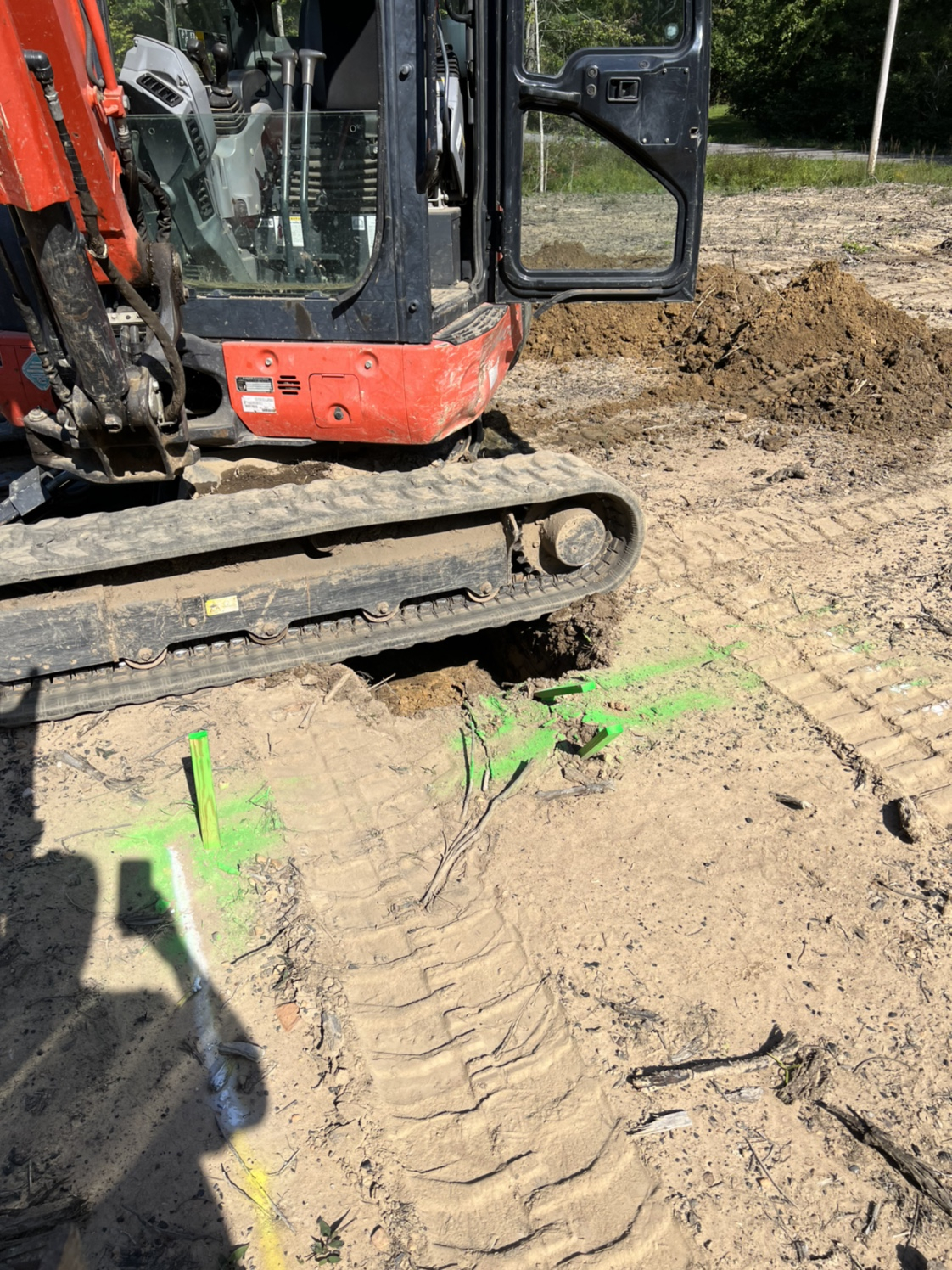

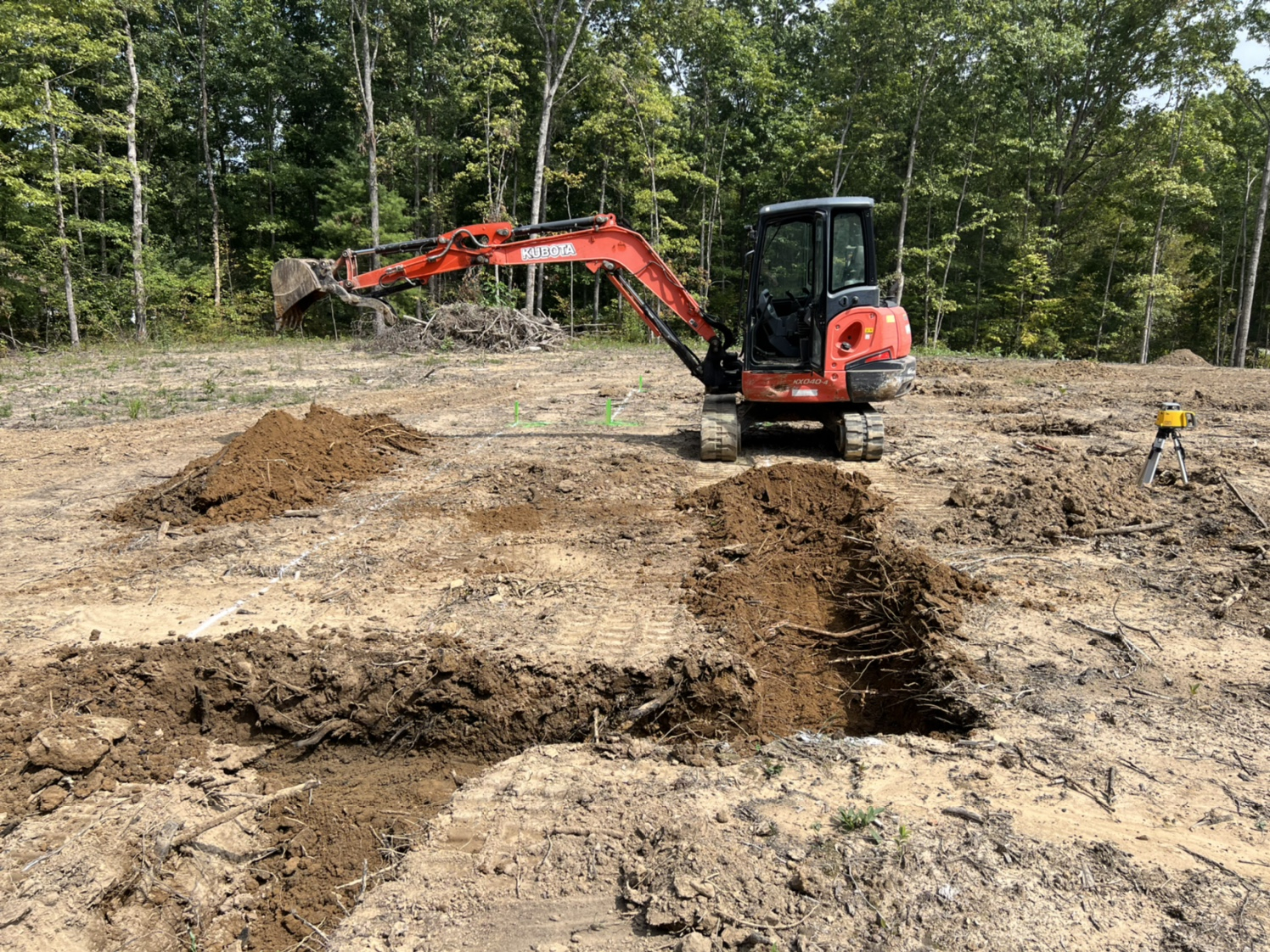

Here’s my mini x on a job. Despite having similar sized booms my M59 would never be able to dump dirt past the second dig line like the mini x did. One of my biggest frustrations with the M59 was it’s inability to get rid of the dirt. My full size Deere was still limited to 180 degrees but a longer boom helped a lot. Another big limitation that I didn’t realize until I had the mini is sitting directly behind the backhoe boom is horrible for visibility. Sitting beside the boom is much better. Having the controls at your side compared to in front of you is much less tiresome to use. My mini x can drive straight across a 24” wide ditch. While it’s possible to cross ditches with the backhoe it’s not nearly as fast.
