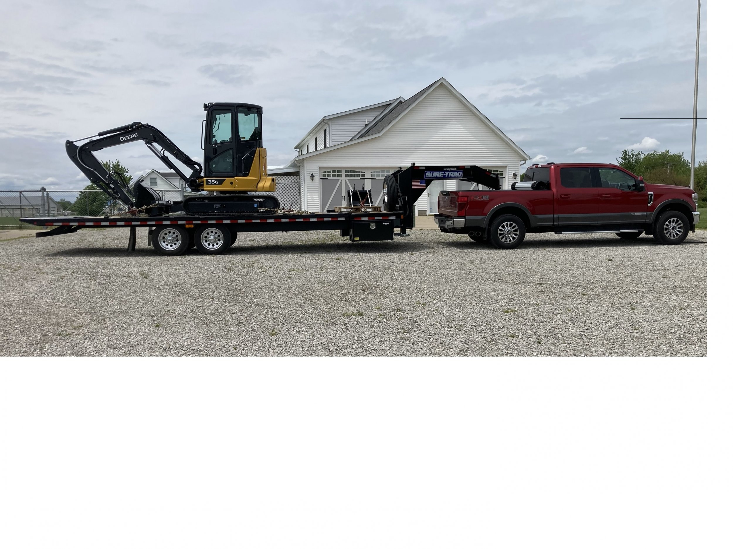

I went through a similar decision last year. Buy a backhoe for the JD4520 or a mini ex. After renting a mini for a small project, there was no choice. I bought the mini to take on the much larger project over the past summer. Weight will be an issues. My little JD 35G plus the F350 and GN trailer tipped the scales at 25200. The F350 was only 120 lbs under the GVWR. The mini is 9600 lbs. The truck and trailer have a combined GCWR of 29.1K (11.5K + 17.6K). Fortunately, no CDL required for personal use in Michigan. If I decide to use it for side work, I will be looking at a whole lot of cost.
