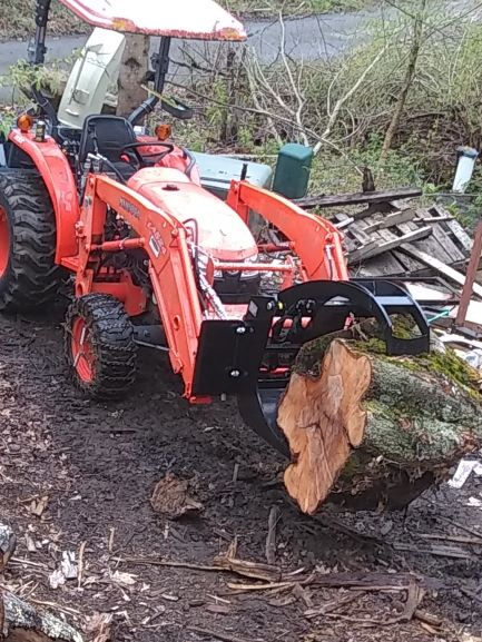

I just added a log grapple to my L3800. I know I need good ballast to move log length. I have rim guard in the rear tires. Now the choice is ballast box with sand or B77 Backhoe. I would assume the backhoe would be better but how are the ballast boxes? Today I moved a large round to try out the grapple but the snow blower was not enough weight and the rear tires were spinning in sand.

A backhoe is a good source of ballast weight (I use mine for that), but a ballast box allows for better maneuvering in tight spaces.
/ BACKHOE VS BALLAST BOX #3
In my experience with a backhoe ballast:
The backhoe has a lot of weight up high which can cause big, uncomfortable weight transfers in undulating terrain.
They’re also very long so they swing wide when turning. That’s annoying in the bush.
The advantage is that you can slew it to the uphill side on hill crossings for better stability.

The backhoe will raise the center of gravity and reduce the ground clearance. Go with added wheel weight and a 3pt ballast

If space is an issue, ditch the backhoe for ballast. Concrete will have more weigh than sand. You can buy pre-made metal boxes online in the $250.00 range empty. Some have tubes for tools.

I try to keep the cheapest, heaviest and most durable ballast on the back of my tractor. My $150 John Deere ballast box weighs 900 lbs. I bought it used a couple of months ago and filled it up 2 weeks ago with the extra concrete from my barn floor pour. If I damage it, I'm not out much. If I damage my other ballast options - 700 lb rototiller, 900 lb chipper, 500 lb snowblower, I am out a lot more money.

I assume you already have the backhoe? The backhoe has the big disadvantage of being in the way but it would take a very heavy ballast box to reach the same effect. The backhoe is already heavy to start with and the farther the weight hangs behind the rear axel the more effect it has. I’ve never used a BB because they’re useless for anything else. A box blade or backhoe or some other implement at least has other uses. Usually if I’m working in tight areas I’m not doing hard work and just drop the ballast entirely. Truth be told usually I loose the loader and use the rear implements for tight work. The loader adds considerably to the turning radius where the rear implement doesn’t have much effect.

I have the backhoe already, got it when I got the tractor. The ballast box was given to me, so I debate selling it or getting the 3 pt hook up to use it. I have the snow blower still on but with the large maple round the rear tire was slipping on the dirt road. I need to drop the snow blower and I guess I'll put the backhoe on for now.

If you think you will have the NEED for the backhoe, put that on. If you think there is a good chance you wont use it in a years time, use the ballast box.

For that machine....if you go with a ballast box in close.....you need to aim for 1000 pounds if you want full capability of the loader.
