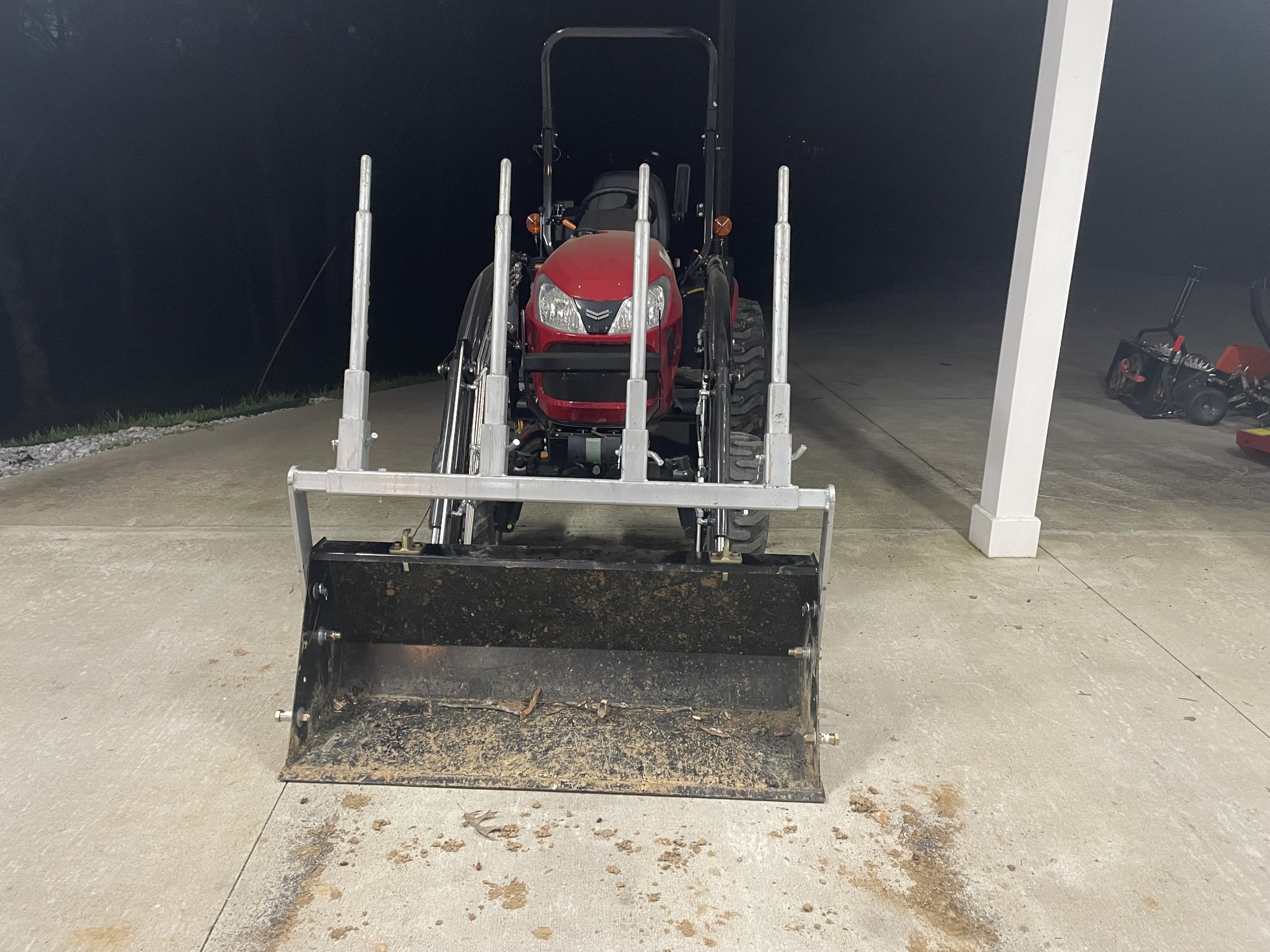

Because of some health issues, I sometimes need help removing the backhoe and installing the 3 pt hitch arms, top and tilt etc. on my L47.
If I have a small job that requires the 3pt hitch sometimes I can use this adapter that I built back when I just had a Bobcat.
There's more than one way to skin a cat🙀

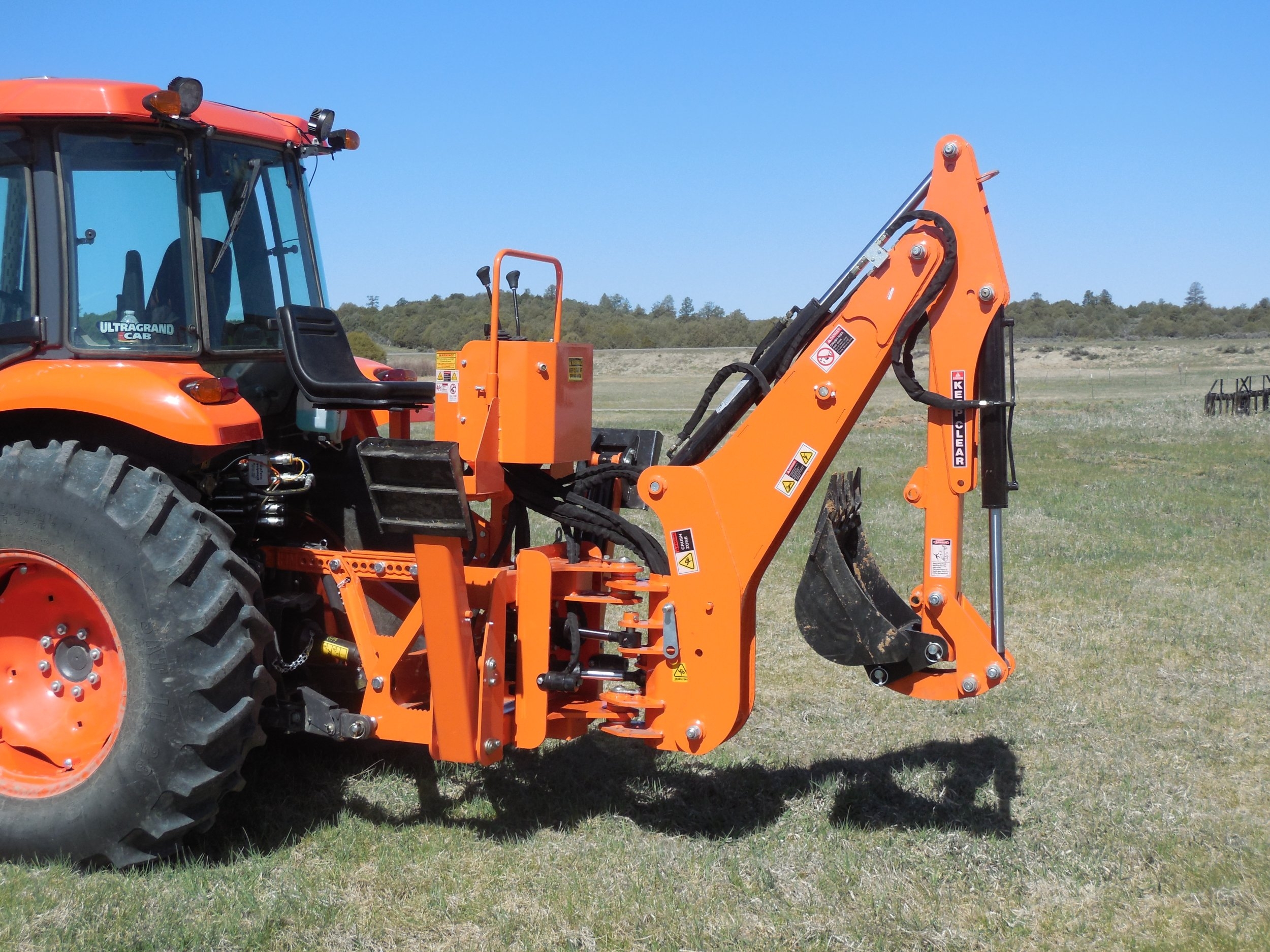

I’m surprised no one has mentioned the towable backhoe.
I’ve got about 18 ac. of hill, mostly brush and < 12” trees with 2 ac. grass around the house/barn area. I needed a backhoe for firewood logging, trail maintenance, rock removing etc. but I did not want to have to remove it whenever I wanted to use the 3pth and pto so the Northern Tools NorTrac was a good compromise. Some one will come on here and say that is just a toy, but it is not, it is equipment that does a good job for what it is designed for, but like anything else if you push it you will break it. There are other towable backhoes available and they are all fairly simple machines to work on and with plus parts are readily available. Anyway it works for me.😊

I think it is because of the new Rage in the mini/micro excavators from China, still well under $10k and you get tracks and a "360*" view.
Anything that beats a hand held shovel is Good in my book. :)
