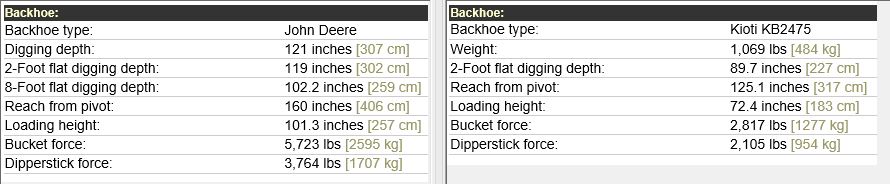

I have an old ford 4500 tlb. It's 45 years old now, and I'm really gentle with it. I'll have to eventually replace it. I'm worried the new backhoe would be more of a toy than a workhorse like the ford was. I've never operated a hoe like a woods or kioti.
I have seen lots of youtube clips on the john deere 110 tlb, but I think even that would be much stronger than I could expect with the Kioti.
/ Backhoe #5
Yes, the backhoe on the 110TLB is almost double the specs of the Kioti KB2475. Lots bigger, too (longer reach, etc.)
110tlb vs kioti: View attachment 430767
It's clear the 110tlb's hoe is about twice the power of the kioti KB2475. I'd hate to invest 10k in something that I'll regret.
Although reading further, the woods bh-90x is much closer to the jd110 tlb

I have an old ford 4500 tlb. It's 45 years old now, and I'm really gentle with it. I'll have to eventually replace it. I'm worried the new backhoe would be more of a toy than a workhorse like the ford was. I've never operated a hoe like a woods or kioti. I have seen lots of youtube clips on the john deere 110 tlb, but I think even that would be much stronger than I could expect with the Kioti.
No doubt the power of a CUT mounted BH will be substantially less than your Ford. However, the CUT based TLB will be a hundred times more effective than a shovel. It's all about perspective.
