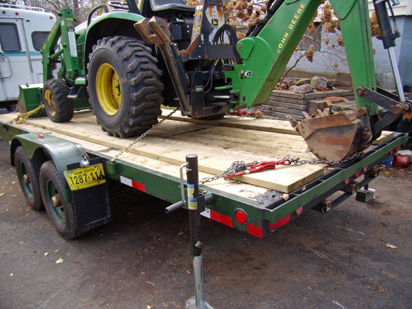

Ah, those lovely Torx self tapping screws!
My trailer was re decked last summer. I just cut the boards from the top and use a pry bar to break them off or pull them through rotten boards.
Ground the remaining stubs off with angle grinder.
When applying new decking used bolts. Placed the board and then drilled through board and support Chanel's. In some cases used pipe clamps to pull boards into alignment. :D

All very good ideas for wooden deck removal. Last few trailer decks I have done, I did not redrill the cross metal beams to lock down the new deck. Just get fender washers that fit your bolts and drill the wood adjacent to the angle iron flange and clamp to the beam. Saves drilling time and more holes in the iron. You mentioned a 2" lip on the front. Your decking will not move and is held nicely with the fender washers as clamps. You can use more bolts too. Makes it easier if you should have to redo in the future.
PS-I also had to destroy the old deck on removal.
