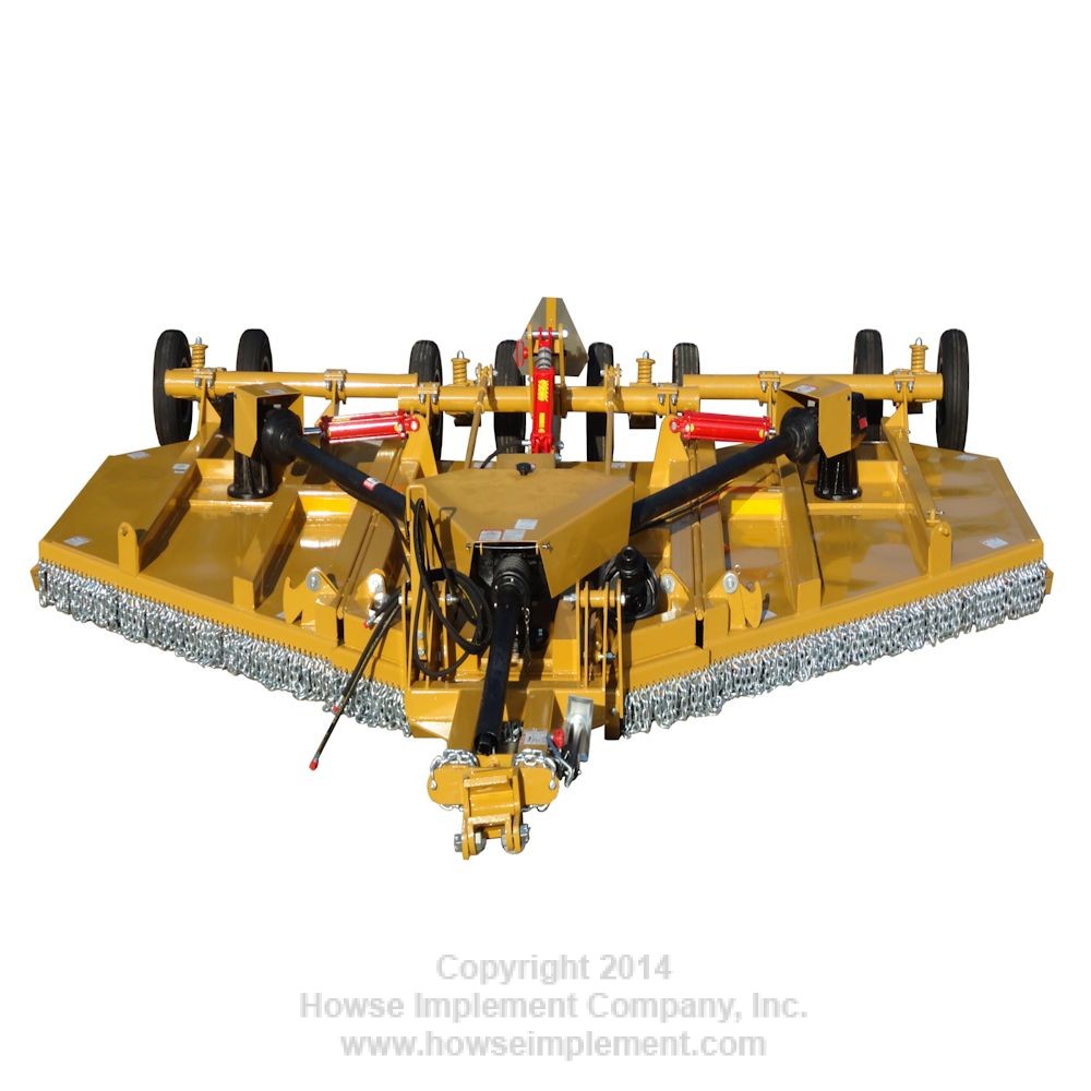

Ummm, every mower I have seen on the ROW (mowing commercially, not Harry Homeowner) has a rear discharge deck, not a side discharge deck. The sides are at least 1/4" steel.
They will also have chain guards front and back (as seen on this Howse Batwing):
15' Heavy Duty Flex Wing Mower With Chain Guards - Flexwing Rotary Cutters - Heavy Duty Rotary Cutters - Rotary Cutters - Product Lines

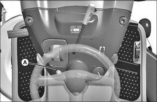

I think Deere requires that the RIO button has to be held up... down stops the mower. If forgetting, and the deck shuts down from the RIO, then the button has to be pushed to Off, and pulled to On.
My mother in law has a LA135 which has a small button to the left of the steering wheel that must be pushed down (as seen below, it is item A):
OMGX23404_I9

Here is the Oklahoma DOT mowing along a ROW with batwings, note the rear discharge and the chains front and rear:
