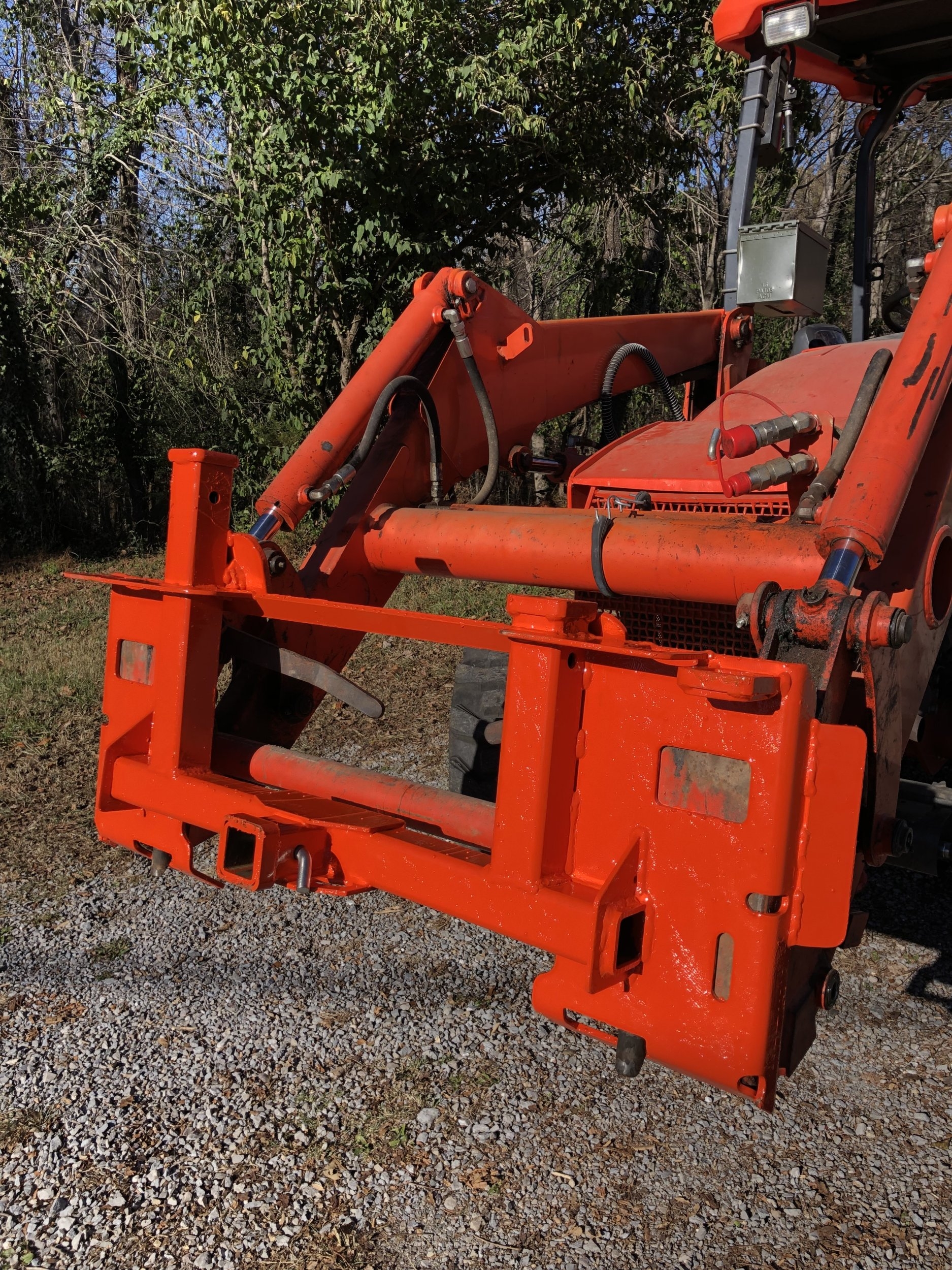

Skid steer solution (temporary ?). You guys have some great ideas and plenty of experience. Big problem with backing in, beside direction control, is the loader arc out front. Slight steering corrections swing the loader wide -- and the barn door is narrow. Real easy to get wedged up weird. So I got a length of 5/16 tow chain, attached to rear corners of the gen trailer and looped around 3-pt hardware. This locks the trailer into position laterally. creating a single unit. Backing up skids the trailer wheels sideways if necessary. Trailer and gen are relatively lightweight so no serious harm to tires in that short barn distance.
Big problem with front steering-in is the need to unhitch and then rehitch the tongue and tumbler bar each time. Not fun in a dark barn at 17 deg Fahrenheit.

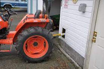

I don't always think my tractors are always the best to back trailers into narrow doors. No mirrors to see the edge of the trailer in respect to the door edges. Much rather use the pickup with its mirrors. Now if my tractors had mirrors, but would probably knock them off in the woods. Jon
If you're interested, here's a cheap & easy way to add tractor mirrors:
Make a pair of brackets from a piece of 3" angle iron and buy a cheap pair of mirrors off a Jeep Wrangler. I bought them on eBay for $40:
Then bolt them to the FEL support frame:
The mirrors articulate and fold inward for woods work. They can also be removed easily if necessary.
They are cheap enough and readily available so it's no big deal if they get broken.

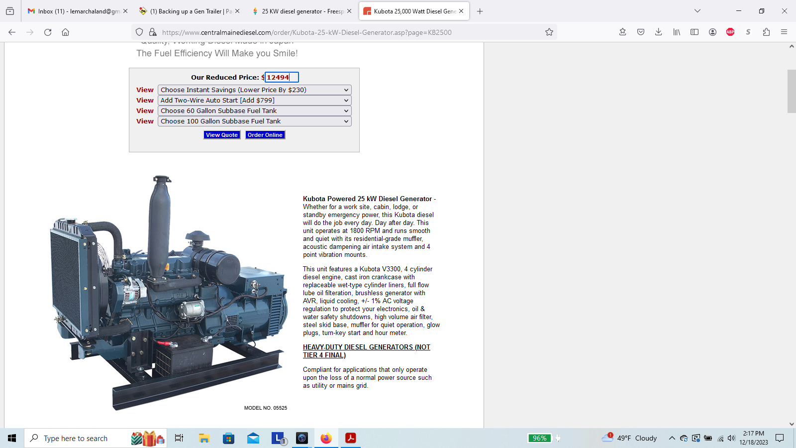

If an 1800 rpm diesel powered unit should be very reliable also.
cost well let's see; $12,500 with no enclosure or fuel tank.
I can get reliable 2wd tractors for under $5000 day in and day out.
Sounds like you came up with a good workable solution.
Others that sounded good were , forks on the 3pt pick up gen. trailer all hooked up or mount gen on a 3 pt platform rather then the trailer.
Enjoy your power when others are out.

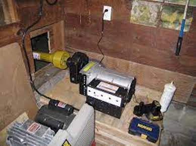

Mount it on a 3-pt. platform and junk the trailer! Would make it much handier!
/ Backing up a Gen Trailer #80
Bolt heavy duty casters to a pallet and mount the generator on it. Move it with the forks and roll it around where you want. Makes it easy to hook up the PTO shaft.
Make sure the pallet is wide enough to keep the generator torque from flipping it under load, and use casters with brakes to keep it from moving around.
