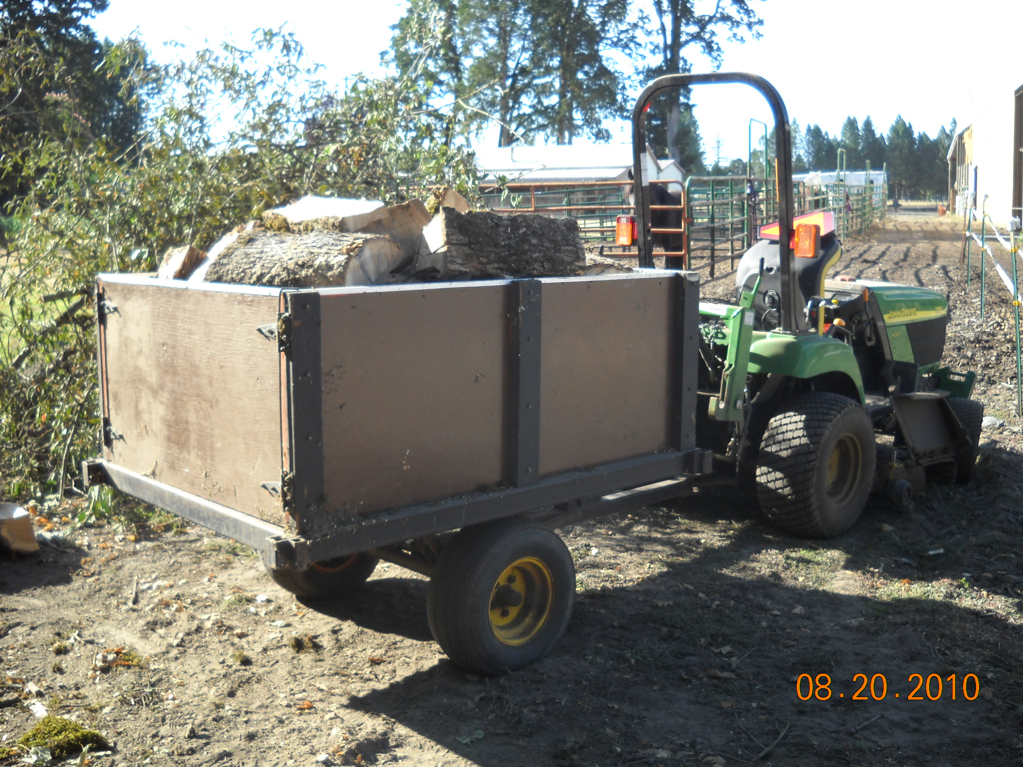

If you could mount a ball on your 3pt instead of the drawbar you would be able to back up a little easier. Better yet would be to extend the trailer tongue. The longer the trailer tongue on your 4x6 the easier it would be to back up.

I use the ultimate cheat. I have a receiver hitch on my FEL and move my trailers all over with it. Easy to control the 18' and 10' trailer.

I think any kind of trailer is easier the longer they are and a longer hitch helps too . Like our semi trailers on 5th wheel converters , the 40 footers are much better than 20-30ft and have 10ft hitches on them . A 2wd tractor is handier too, quicker to compensate and better lock .

Key distance is a ratio: The shorter the tow vehicle, and the longer the trailer, the easier it is. And of course, vice versa. The key distances in this ratio are from the steering axle (front) of the tow vehicle to the hitch ball, and then from the hitch ball to the trailer axle (not sure how that translates for dual/triple axles...). I have wondered if there is some "magic ratio" that you really want to be beyond where it starts to become much easier, but I have not seen anything like that published.

You can practice practice practice and it still ain't easy with the set up you discribed. FEL mounted hitch is much simplier.
