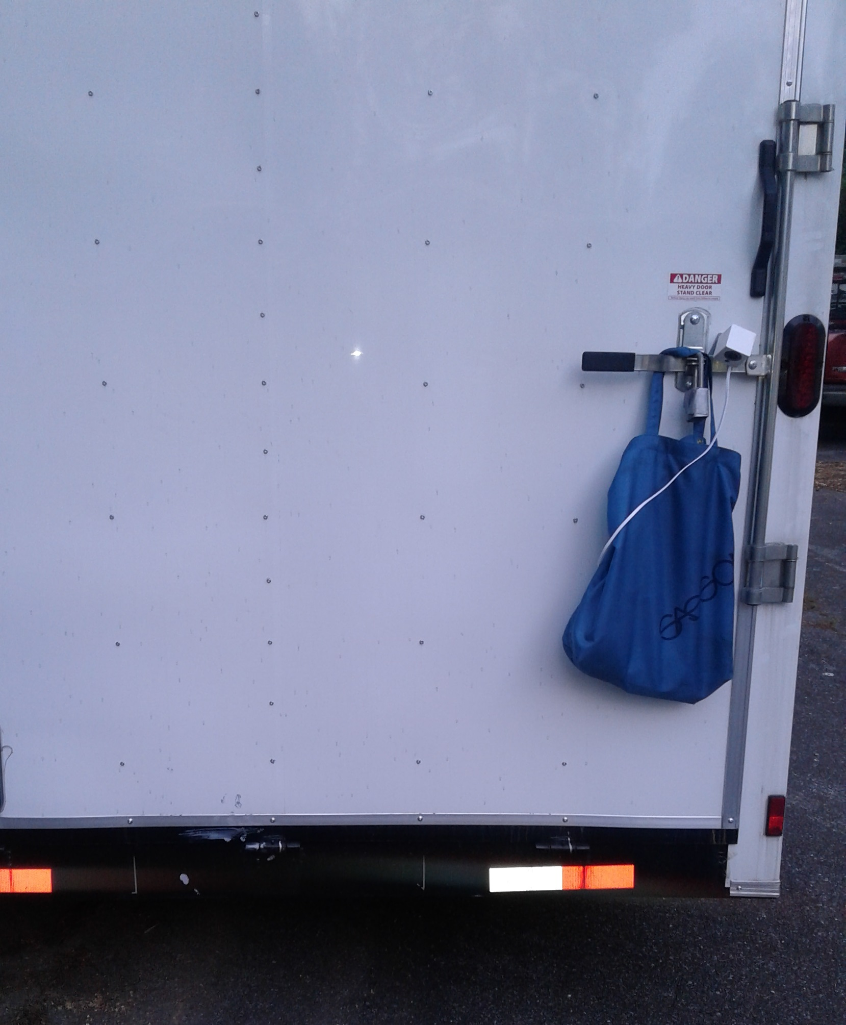

I've used (and posted about here) a $20 Wyze cam with a $13 battery for backup, latest using my phone as a hotspot.
Real easy, take the cam & battery, place it on the bumper (it has a magnetic mount) connect wirelessly with the phone, adjust the camera. Also works as a FEL cam.
Here's an example using it as a trailer back up cam, battery in the bag.

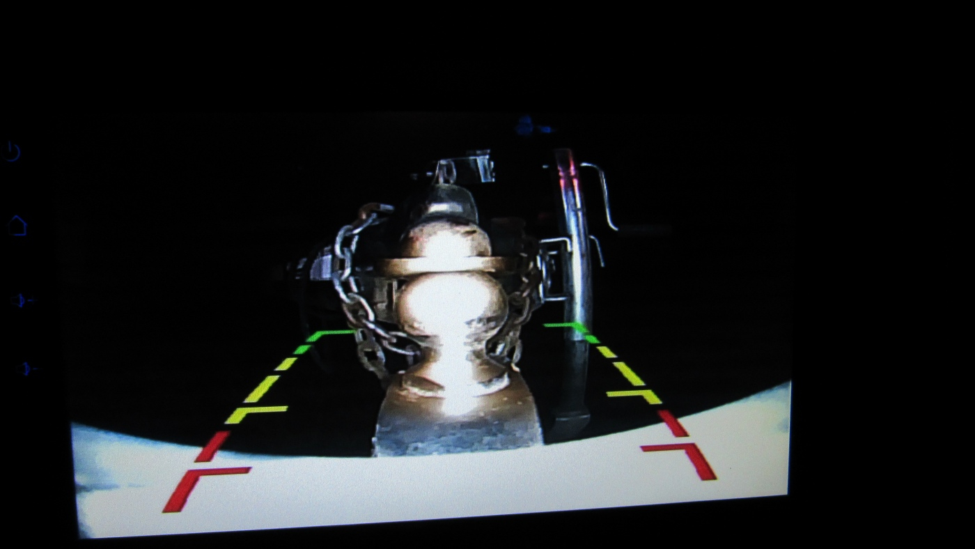

I bought a new backup camera a while back that has led lights built in. I just haven't swapped it out. They are supposed to be white, not infrared so the night view remains in color. Today may be the day for that too.
EDIT: I got my ball and couplers painted. All I had that was bright was metallic gold. Painting the ball and coupler rims made a huge difference in visibility.
I also got around to installing the new camera I've had sitting for a couple of years. The white LEDs were supposed to make the night image clearer and in color. Instead they wash out the image at night. I am back shopping for a third camera. I am finding they all feed from RCA jacks and that is the only connection in I have so resolution is going to be limited no matter what.

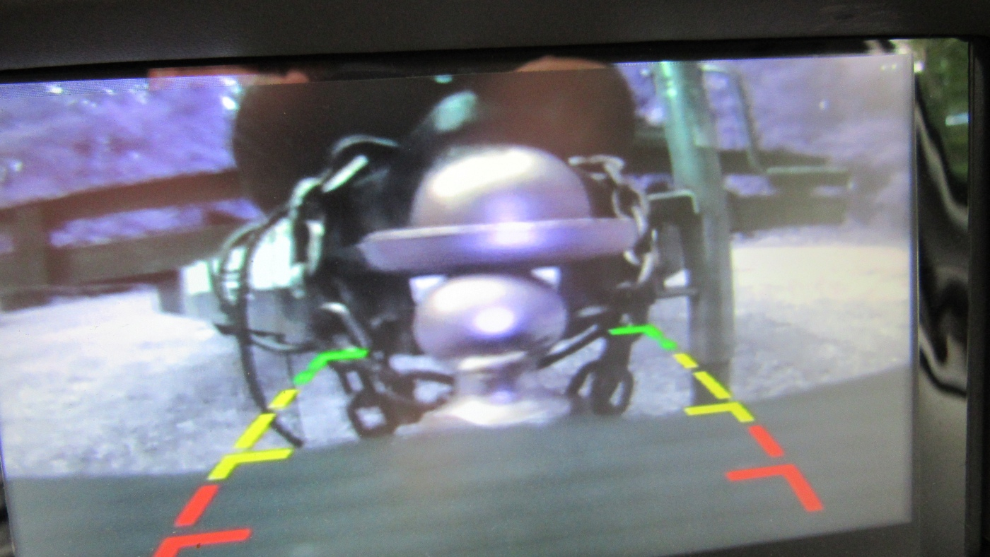

Sorry to say that adding a bright LED next to one of the license plate lamps and shining on the ball did nothing to make the ball visible when in a shadow.
Will try the aluminum foil trick as mentioned by bcp in post #12 above. Also can see where painting the ball and coupler bright would help as others have suggested.
Thanks for all the feedback, guys!

I found the shiny foil on the hitch ball improves visibility greatly on the monitor! Now I need to paint the trailer coupler with a bright color.

I painted my ball and couplers metallic gold and it helped a lot. When I swapped my rear camera out for one with white LED lights it washes out the distance view at night but does enhance the close up view of the ball and coupler. The camera with white LEDs has a much clearer daytime picture than my old one did. I ordered a couple different cheap cameras to try and see if one is better than another. They all connect to my head unit by RCA so image quality is somewhat regulated by that.
