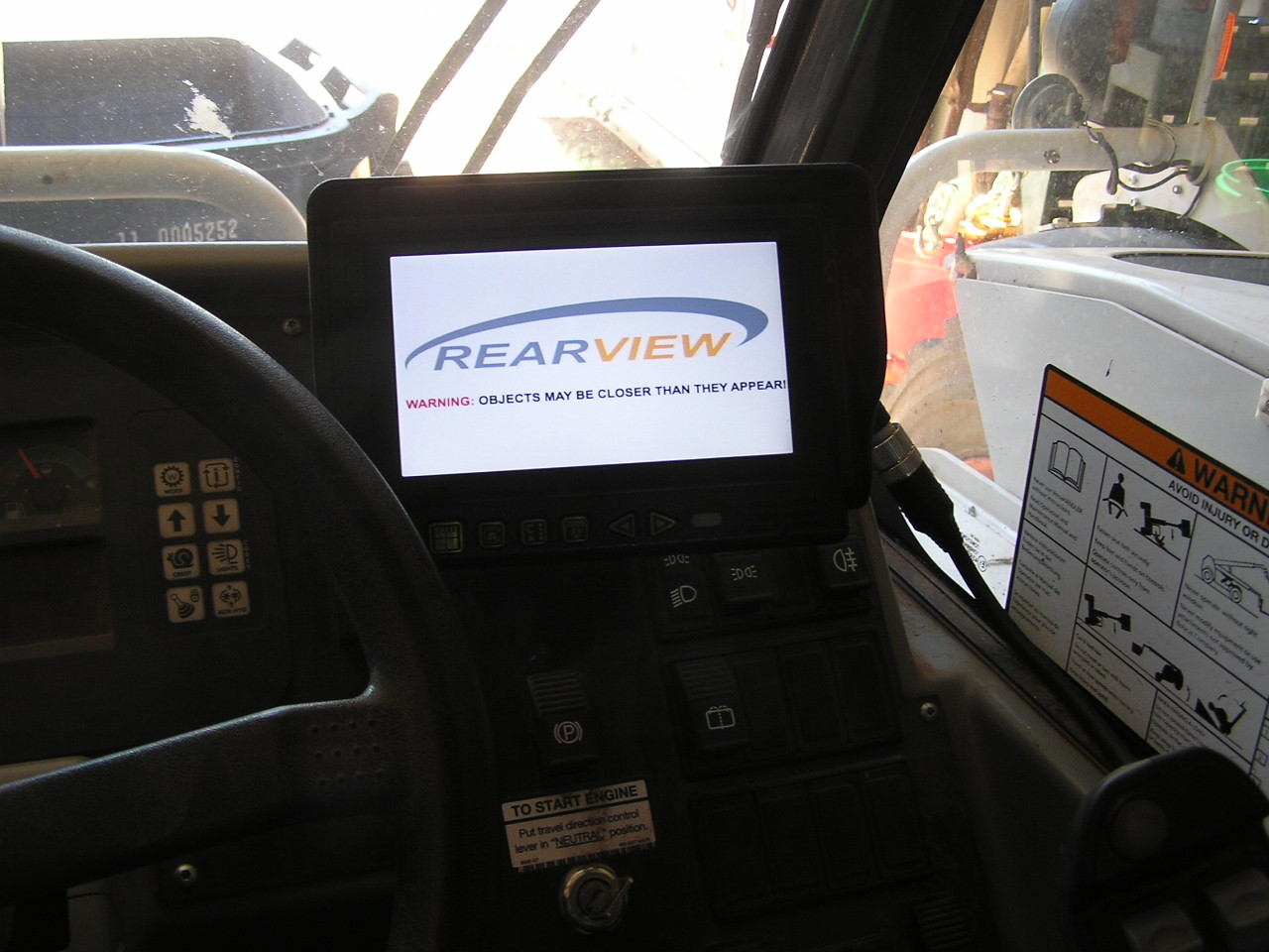

This is what I use in the V417.
Can't see much to the right looking out the front with a round bale out there.

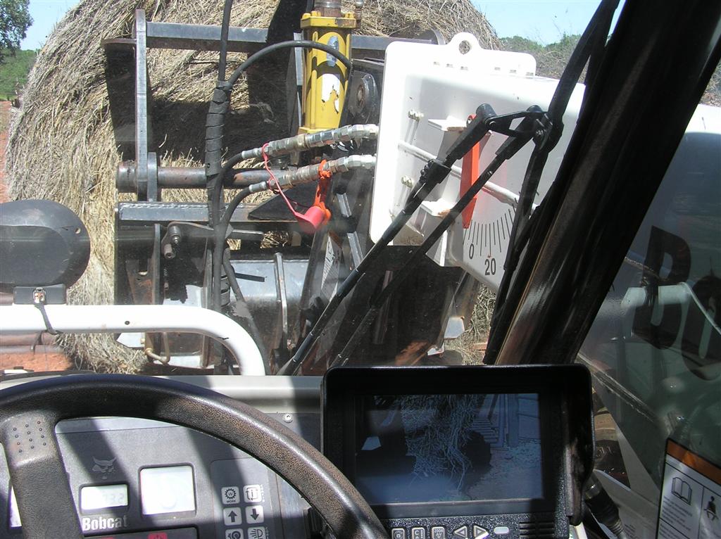

The front camera is mounted above the right wheel
I have tilted the camera up to see higher, since this picture was taken.

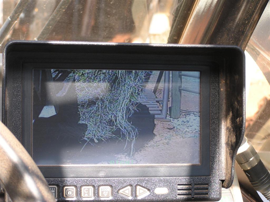

This shows what I saw in the monitor.

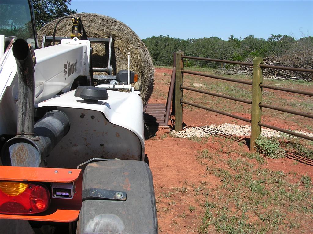

You can see the backup camera next to the tail light lens.

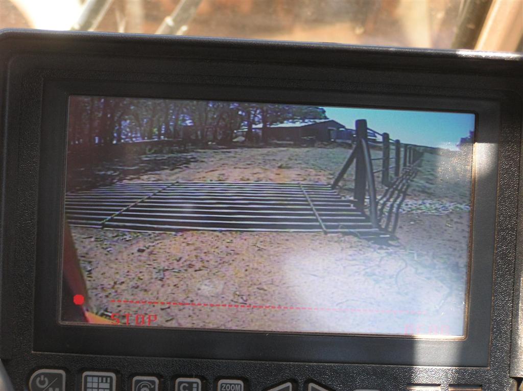

I drove on across the cattle guard and shifted to reverse.
Backed up and stopped with the first pipe at the lower edge of the monitor.

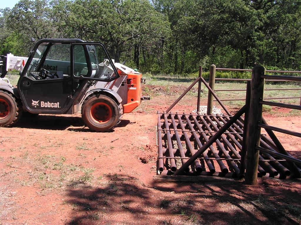

This is how close it was.

It switches to the rear camera when I pull the reverse lever, and the front camera in neutral or forward.
You can also select the rear camera on all the time if you are pulling something you want to keep an eye on while going forward, just glance at the monitor.
