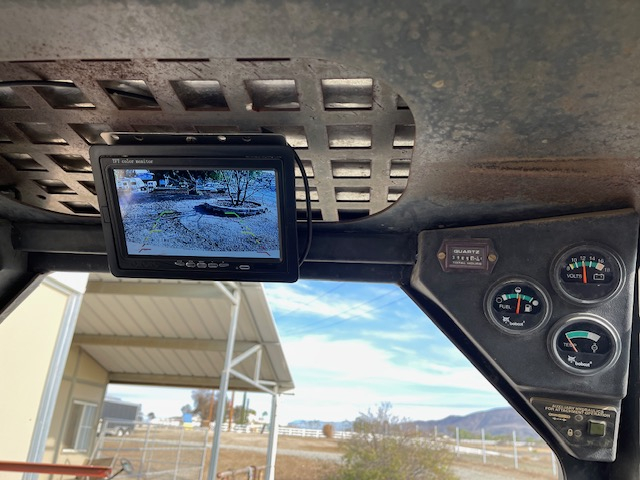

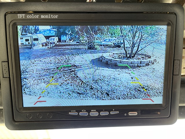

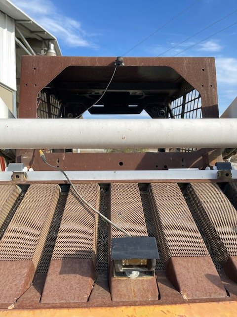

I have 2 backup cameras on the Skid Steer, the BC 773 machine is notorious for poor visibility. The 7" screen is mounted to the roof. The 2 cameras have different field of view characteristics. 1 is normal mounted just below the roof. The other is a wide angle mounted on the engine hood. The camera comes on with the key switch and I switch between cameras with a toggle switch next to the key.
All from Amazon and pretty easy to hook up. Been working flawlessly for about 1 yr. I wrote it up with part numbers in the SS section.
