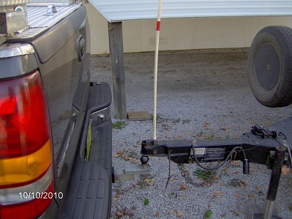

This is a lot cheaper than a camera, 1/2" pipe cap bolted (3/16" stove bolt) to coupler, piece of 1/2" pipe stuck in cap, stored in tube on side of trailer tongue when not in use.

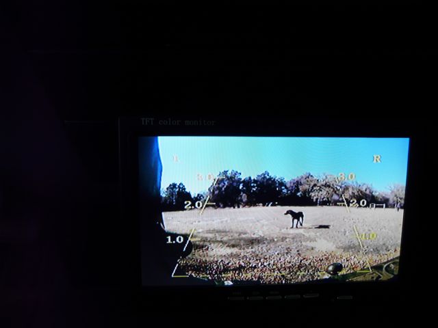

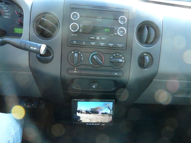

Here are some photos. The colors are a washed in the bright sunshine. I should have put the camera higher and in the center of the truck for the best trailer hooking-up capabilities. I will just have to get used to knowing where on the monitor the trailer tongue should be.
Next post will be a comparison between the Prius BUC and the Ford BUC.

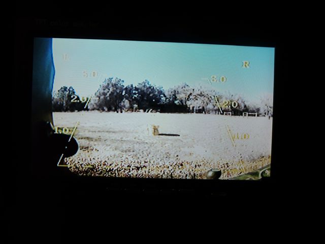

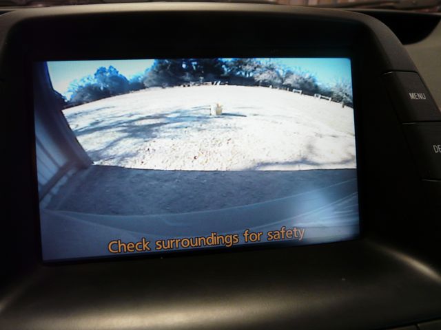

Here is a comparison of the factory Toyota Prius back up camera and the TFT monitor added on to the Ford F150. A faded yellow bucket was put 10 feet behind each vehicle in the bright sunshine.
You can see the trailer ball on the Ford on the bottom righthand side.
