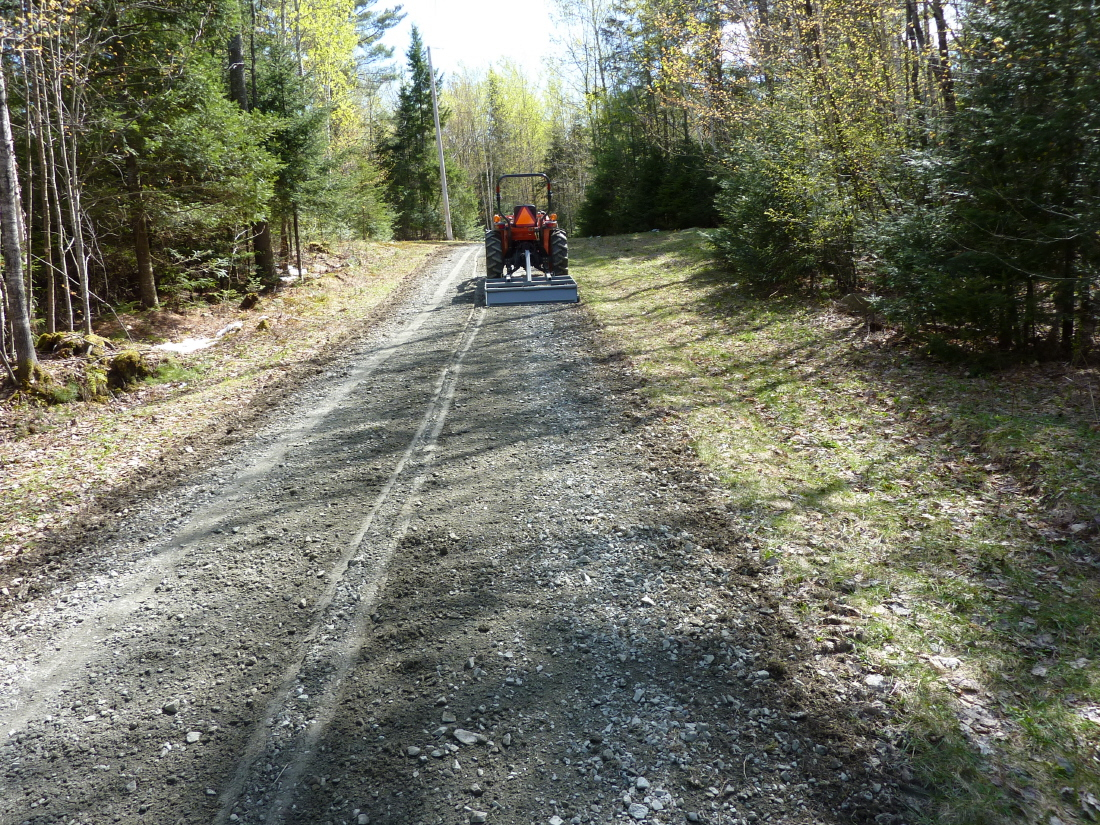

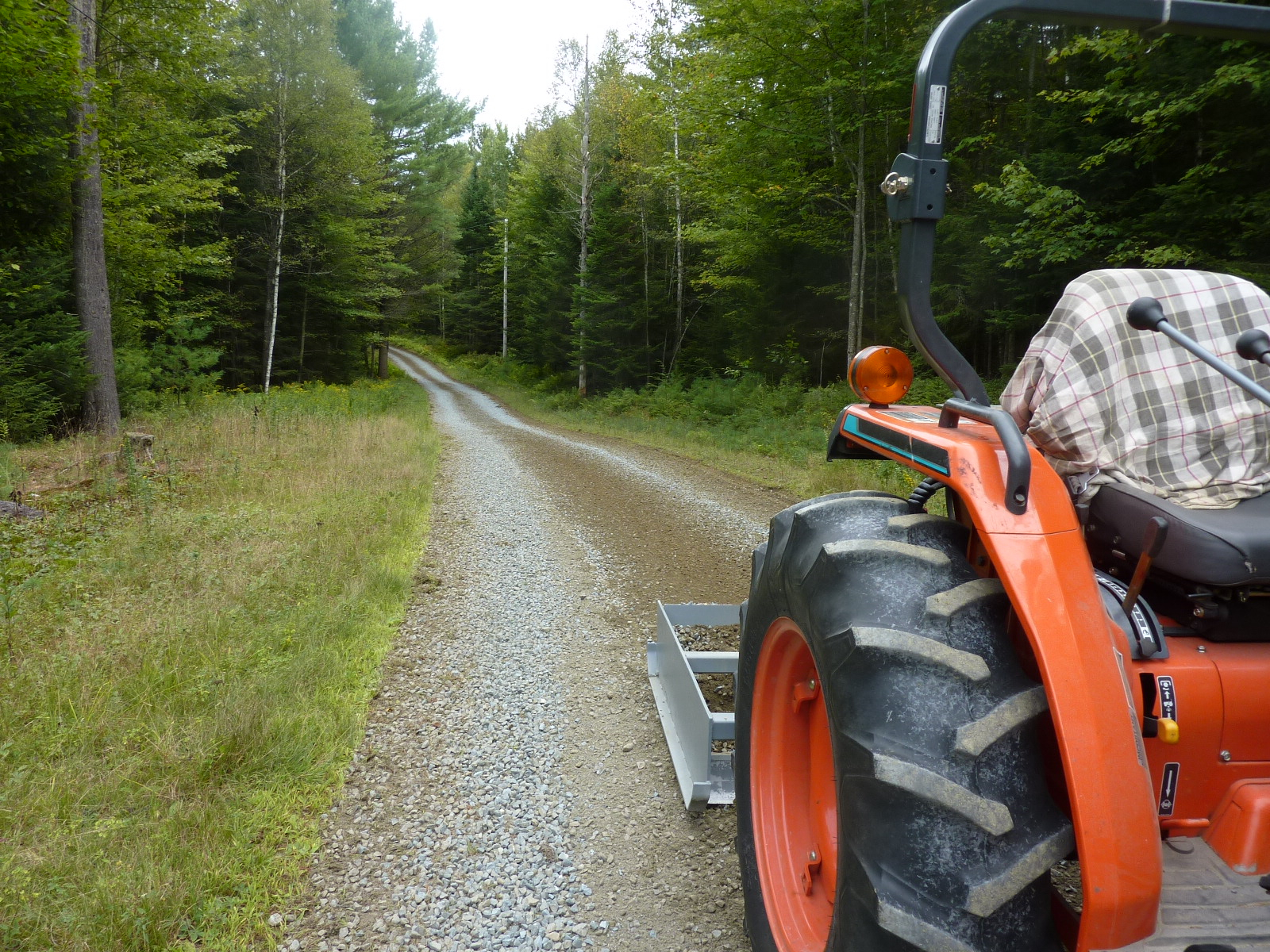

   / Bad Boy Land Plane #19
800lbs for my 5 footer. Blades are angled 15* if I remember correctly.
Anyone trying to create a crown best have some patience . Dirt literally only moves side ways 5/8"- 1" each pass.
I actually painted a stripe on the ground to see how far the stripe would move.
