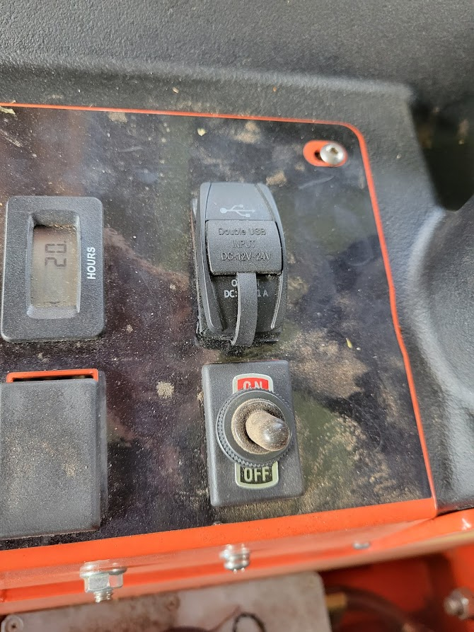

What did you use for wiring and switch? A rocker switch that fits the blank spot on the Rogue's dash?
Rob
   / Bad Boy Rogue zero turn mower #22
I put a relay under the user console, ran 14ga wire from the battery to the relay, and 16ga wire from the relay to the lights. I Tee'd off the USB port wire since it was switched to energize the relay. The relays I had were fused, and since it was installed under the console, I have a 30a fuse in it, and have a 20a fuse right off the battery, so if there is ever an issue, it is easy to change the 20a one.
I just used a toggle switch with a rubber boot to make it waterproof. I drilled a hole in the existing blank cover, and put the switch in. The toggle switch open/closes the switched power from the USB tee to the relay. I think I used some 18ga for that, 20/22 would probably be fine too, it is only used to energize the relay.
Switch: https://www.amazon.com/dp/B078KBC5VH
As you can see by the dust, I mow a lot of dirt lol
If you look below the switch on the orange side, you can see a screw head, the relay is mounted to the inside. which hides all the cables and keeps things dry and hopefully cleaner.
