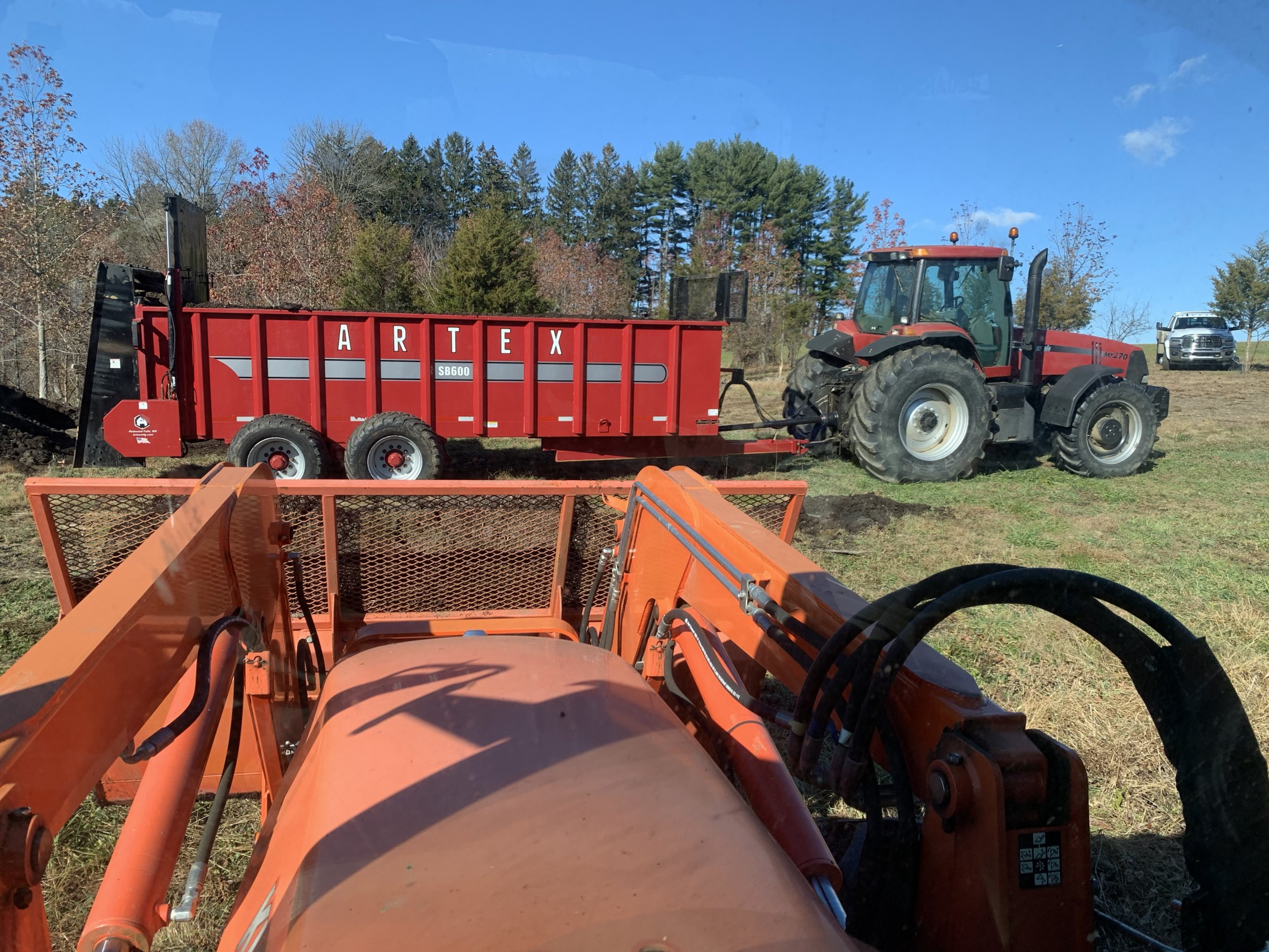

Purchased my M135X in warmer months almost 3 years ago (April 2019). Never thought to see if the glow plugs worked. They actually won’t work if it’s over 41*.
Last winter, I realized the glow plugs weren’t working. Ohmed out wires, looked at wiring for mice damage, water damage, bad grounds, etc. Ohmed out wiring. Thats when I learned the glow plug system in larger kubotas is more complex than I thought. All 4 glow plugs passed electrical testing.
The glow plugs have 2 sensors one for air temp, one for water temp. The ignition switch is also part of the circuit. Then there are 2 relays and a fuse. All of this is controlled by the ECU. Last winter, I replaced
Key switch
water temp sensor
air temp sensor
both relays
fuse
Still no glow plugs. With nothing left to replace or test, I succumbed to a very reputable Kubota dealer. They basically did all the same things I did and replaced one of the new sensors I had already placed.
Still nothing. They called Kubotas double secret probation hotline and Kubota thinks it’s the ECU.
ECU price $6000 :(
ECU Not returnable and no guarantee it will fix glow plugs.
So I’m out of answers. Any thoughts on other possible avenues to pursue?
Can you put in a block heater? I'll bet they are less than a $100 and are a better starting aid.
   / Bad news big repair
#192
Not when the tractor sits out in fields and is used to load spreader. Which is for about 2 months in late fall/winter. No access to power.
