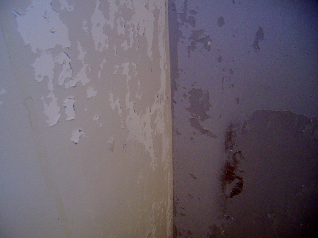

Any expert sheetrock finishers/painters on here? I've got a project that has stalled because I'm not sure what's the best way to proceed and could use some expert advice.
Missus decided to strip the wallpaper in the little bathroom and paint it. I don't know how the walls were originally prepped for the wallpaper, but evidently it was poorly. It looks like the wall was sheetrocked, mudded, then primed with a coat of latex and then papered. Probably not sized. The paper was extremely "stuck". Paper tiger was required, plus multiple applications of DIF. Even so some sheetrock paper was damaged and parts of the latex prime coat peeled, leaving lifted edges.
I have used a water soluble white-glue-like product before to prep damaged sheetrock paper, so maybe that will help with that, but I really don't know what will work to address the peeling edges of the latex. If I try to sand off the remaining latex, I'm sure that MUCH more paper damage will result.
The desired end-point is a smooth enough surface so that it can be final finished with regular latex paint.

Been there done that. Existing bathrooms are hard to replace drywall so I would scrape as much as possible and then skimcoat as needed. I like using setting type compound that you mix because it seems to set harder in thin layers. I also use a screen sander with the shop vac to minimize the mess.
   / Bad sheetrock prep for paint #6
That wall looks pretty rough. not ready for paint. I'd would get the new remodel drywall thats 3/8 and screw on walls. If worse comes to worse, you can always tear down old and put new stuff that is mold and moisture resistant for the bathroom.

Where I had a large section with few corners to trim I demo'ed and replaced. In tight areas I sanded down and put on skim coats with the widest knife I could find (18"?) and sanded smooth. It isn't fun, but slow work is best. I find it easier to put on a lot of skim coats and sand it down.

Thanks guys. I shoulda noted that this is a small 1/2 bath, so no real water issues and no mold. First floor, only three electrical boxes (light, light switch, outlet), one HVAC register. About 1985 construction; 1/2" rock for walls and ceiling. As far as I can tell, there is nothing in the wall/ceiling joints except a tape/mud joint.
I hate to demo and redo or cover over with 3/8 because I want to TRY to avoid removing the vanity and a large glued-down mirror above it. Also hate to remove the base mould and shoe mould, but that's not as much of a consideration.
For skimming over, would regular mud (joint compound) work best or a modified thinset? KennyG, exactly what do you mean by "setting type compound"?

When you buy drywall compound you can buy the bucket/tub of premixed stuff or you can buy "setting type" which is dry powder in a bag. The setting type comes in various types that set in 20, 45 or 90 minutes. I suggest getting the "lightweight" or "sandable" versions. Maybe it's just me, but I find it easier to work and stronger than the premixed stuff.
