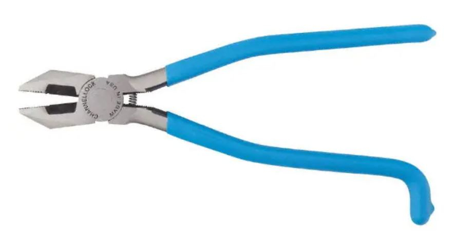

I hate when I do that. Tie wire can shear. I tied a lot of rebar in my youth and still use it today on the ranch. For tough applications double it up. The correct way to get the max tightness is to (a) use tie pliers that have a wide flat nose (b) pull the wire tight by grabbing the 2 pieces to be twisted and racking the pliers back against the pipe or (whatever you are tying) then twist up the slack you created. A little final twist can be applied but not too much.

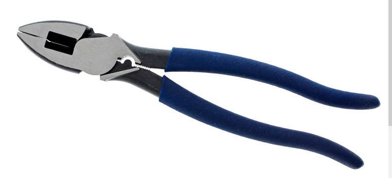

Electricians/linesman pliers works pretty well...

I've used those small rolls of rebar wire for close to 50 years, and it works great. Years ago I had some coaching that resembles scootr's description. Using it double with a saddle tie makes incredibly strong joints. Linesman pliers are my choice.

No doubt lineman pliers will work great. Are those Klein's shown? Good stuff.
The tie wire pliers have the added hook on one handle making the pull and tug a bit easier.
