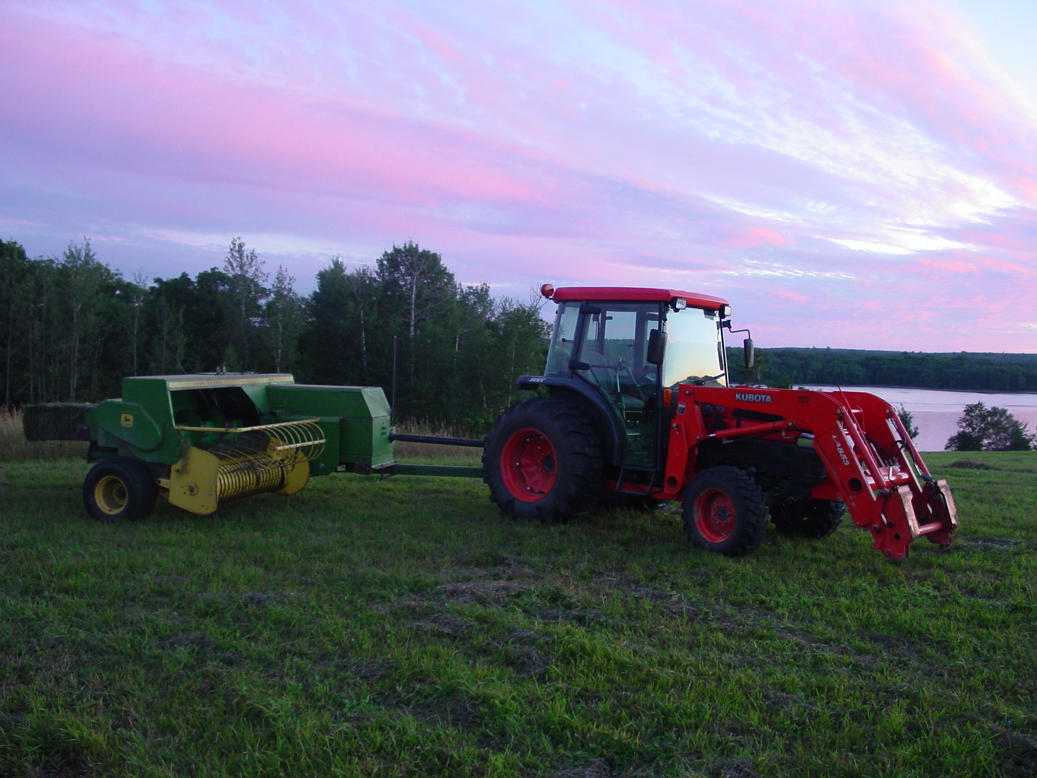

We bale with the L5030HSTC that weighs in at 6500 lb all dressed, it only really rocks the tractor when parked and no hay is feeding. We also use our 100 hp MF 5455, weighs in at almost 12,000 lb all dressed, when parked with no hay, it feels to be the same amount of rocking.
I was worried about it when we first started but like I said we've got about 30,000 bales / 300 hours+ of square baling on it trouble free. The hst clutch is great for starting the load up nice and gently too.
   / Baling with Hst? #19
From 7 years ago.
