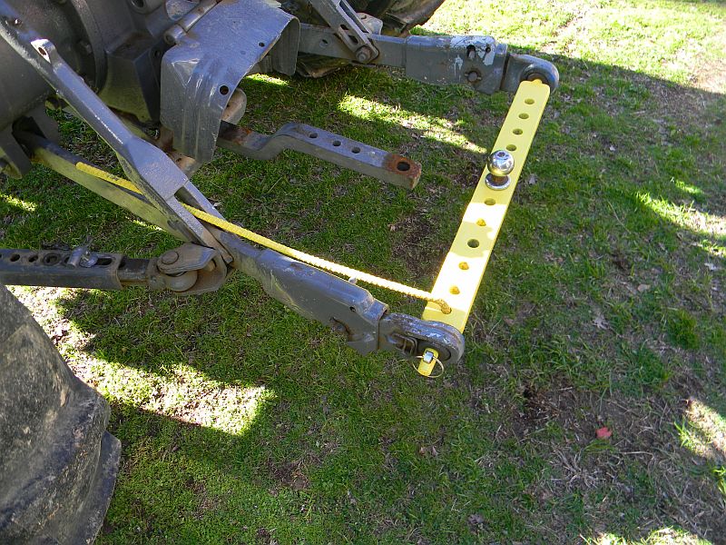

No upward movement at all. I have 3 trailers I move from time to time. The lightest has about 500# of tongue weight, the heaviest tongue is about 1200#. I do the same as Richard, back up, lift and move, drop trailer without getting off the seat. I do have a grab hook, clevis and a pipe to store the hitch when not in use. The hitch fits my HF quick hitch or any 3 pt. tractor. You can easily add a safety chain if you are worried about the trailer tongue being too light and lifting.
I have lifted the 3 pt hitch especially when backing a trailer up and it hits a hole or an obstruction. It goes up 4-5 inches but stops. I just keep pushing if I know it is not a large obstruction.

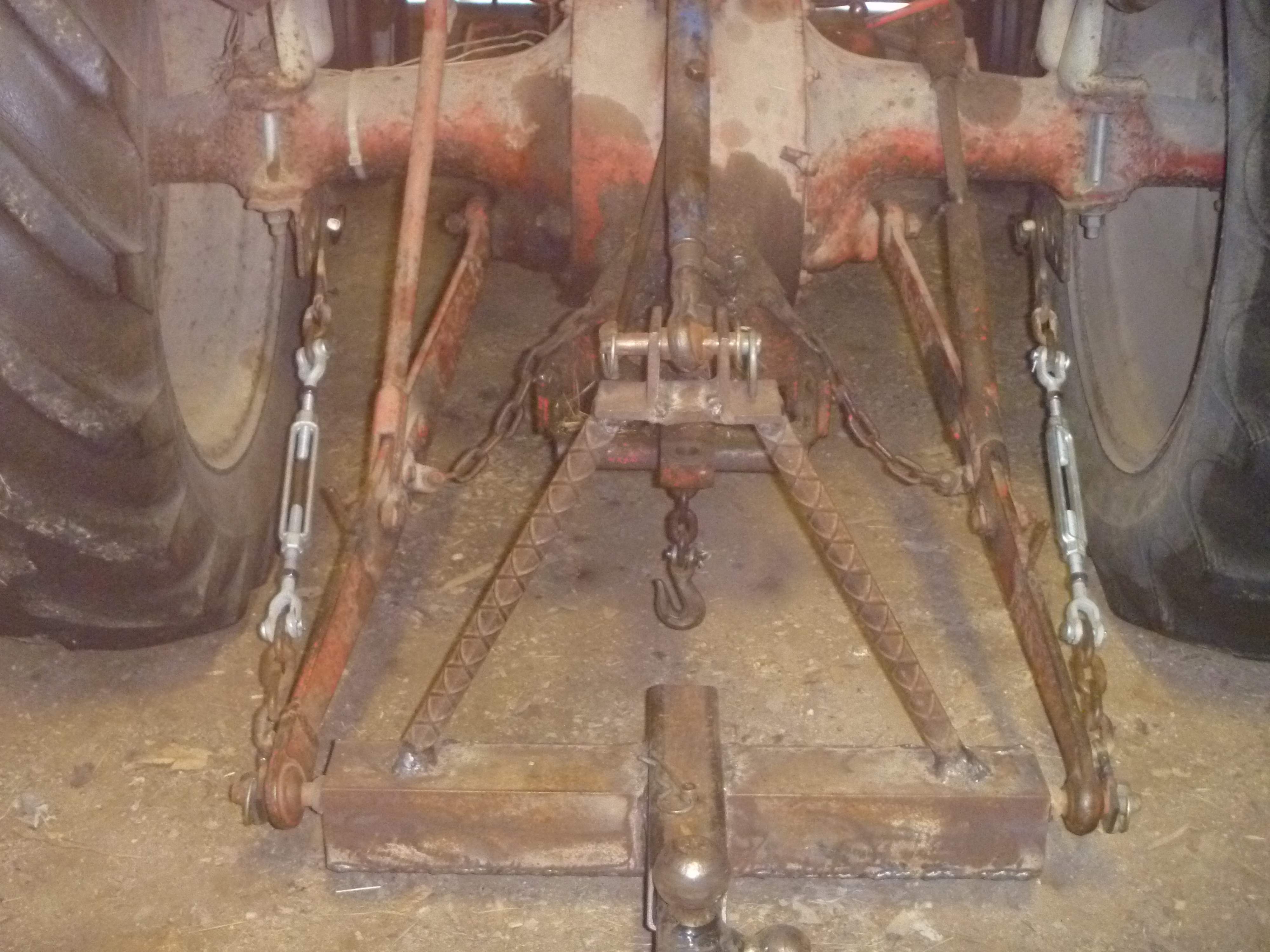

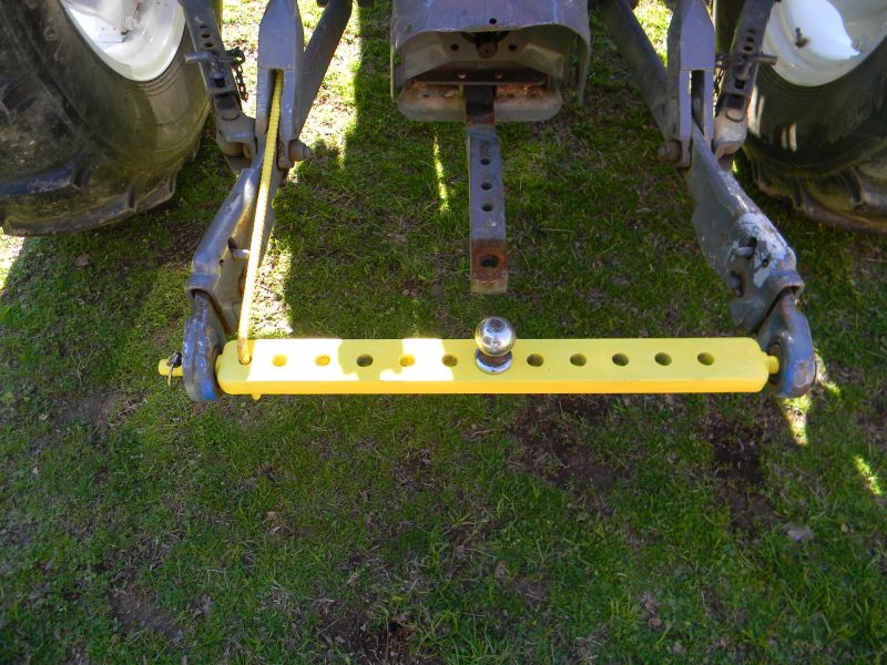

It's not too difficult to weld your own. I have had plenty of weight on mine but if you do make your own plan it well. The visibility of mine is not good: the top link is in my line of sight to the trailer hitch ball.:thumbdown:
On the other hand, the ball protrudes rearward about 10 to 12" allowing for very sharp turns when towing. That required some beefy welding to take the downward force of the tongue.
Bob

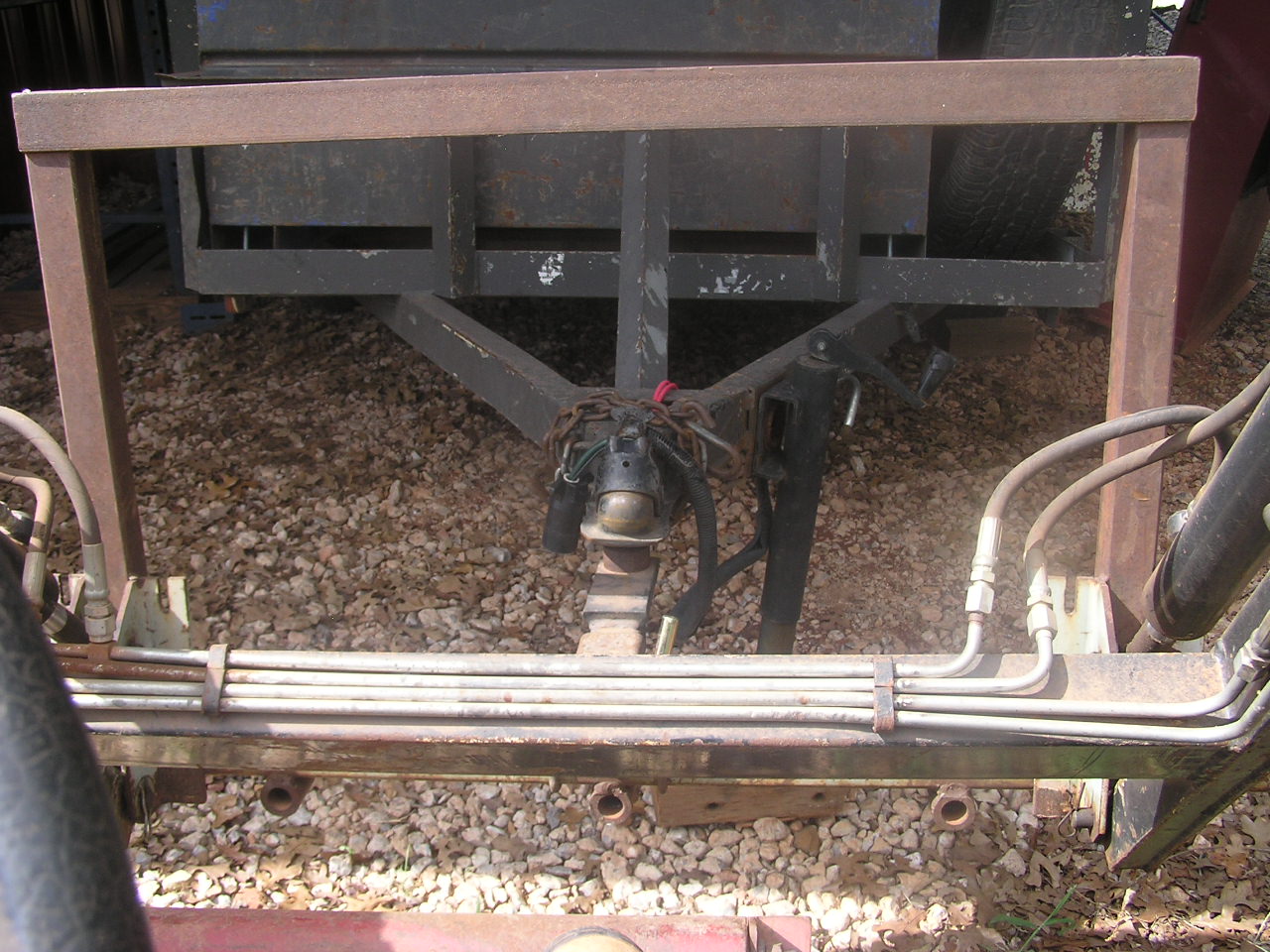

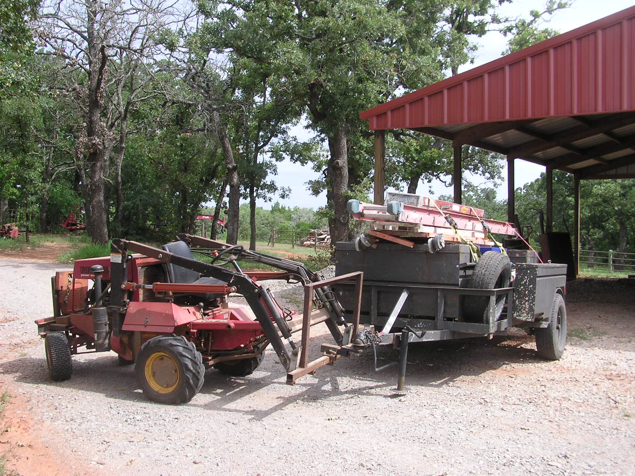

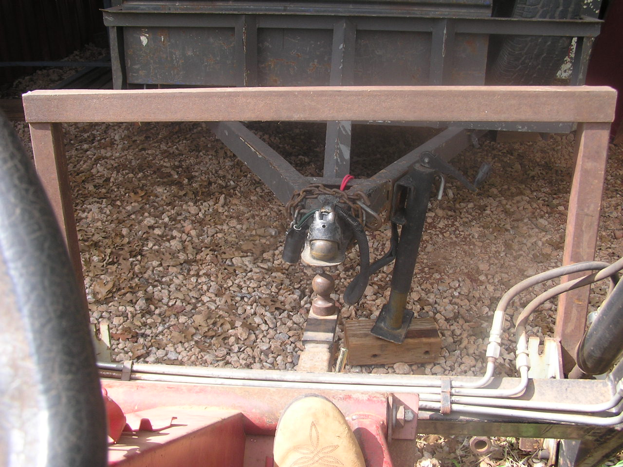

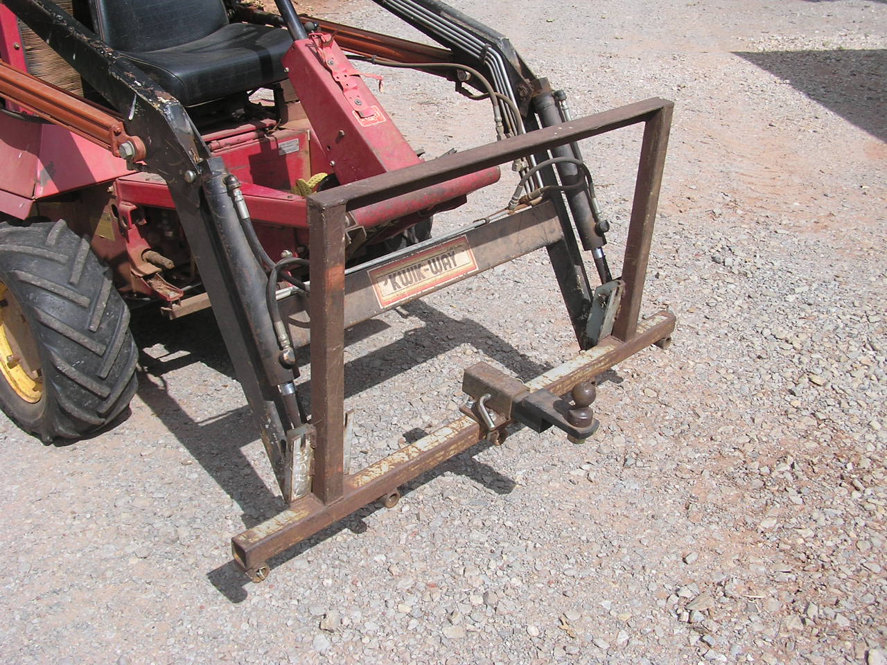

I put a receiver hitch on the brush fork frame.
   / Ball hitch for tractor. #36
For backing up in tight places this work well for me.
Yup. That's what I I have, and it works great for me. Very, very precise control, and when I want to move a trailer down the road a bit, I push the trailer backwards while the tractor is going forwards. I could also have an extended drawbar if I want to see more, but visibility of the ball is generally not an issue.
