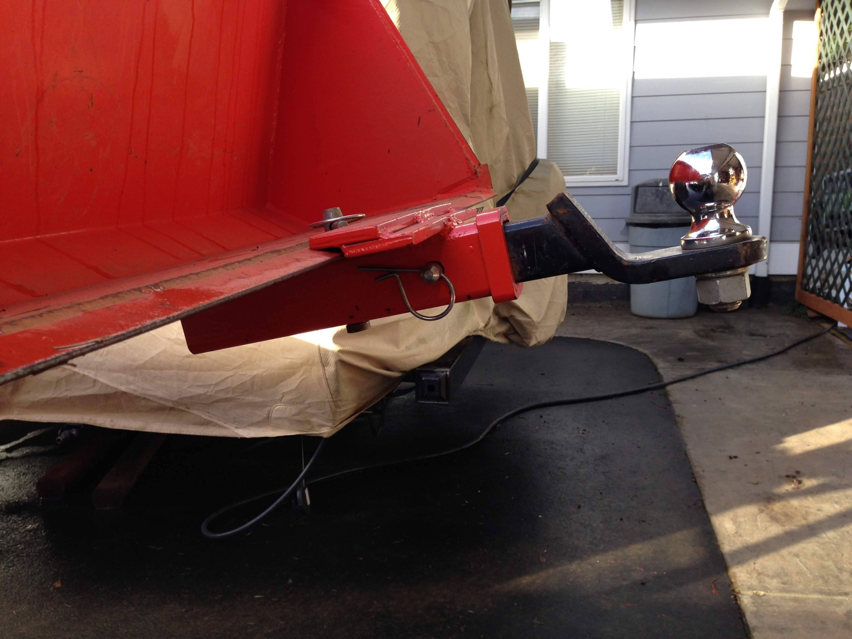

I built this one a few years ago for my tractor. The advantage to this design is that it can be mounted in a matter of seconds, I can change ball sizes easily, it extends a little further from my bucket to aid in maneuvering, I don't have to worry about removing anything attached to the 3-point.

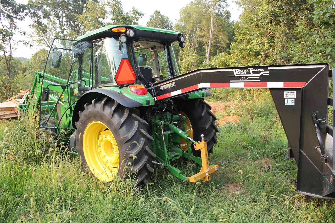

Saw this on the internet. Going down hill w/o locking the GN hitch.
Hope this wasn't a TBN member.
That's very handy!!!! Tongue weight might become an issue but would be great for light loads!!!!
