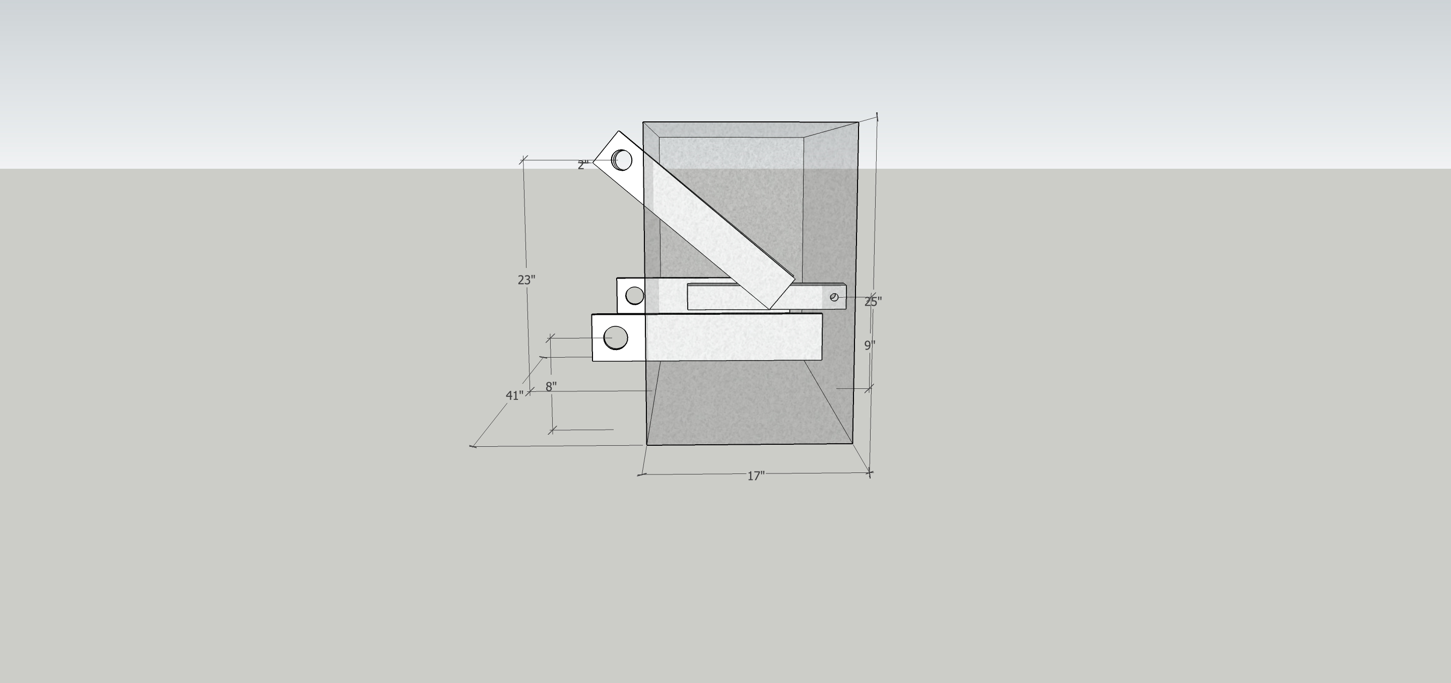

I can put the receiver any height. What would you suggest as the ideal height? The ball on my car is about 400mm (16") above ground level. I wonder what other folks would suggest as ideal, too high and too low based on their experience with their ballasts.
Thanks
Ken

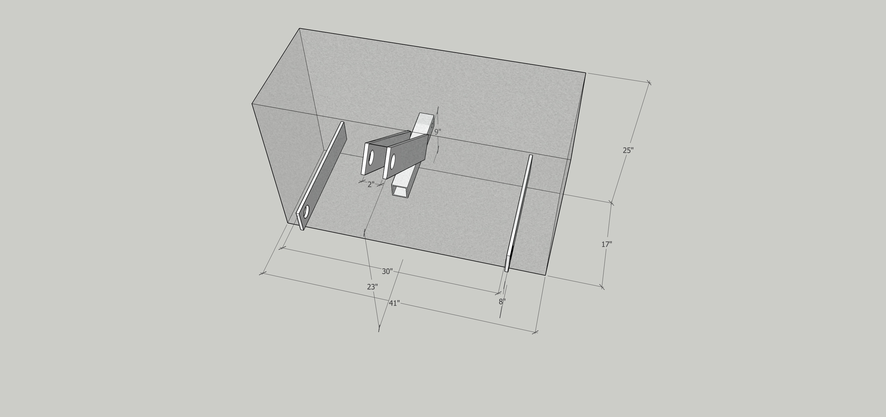

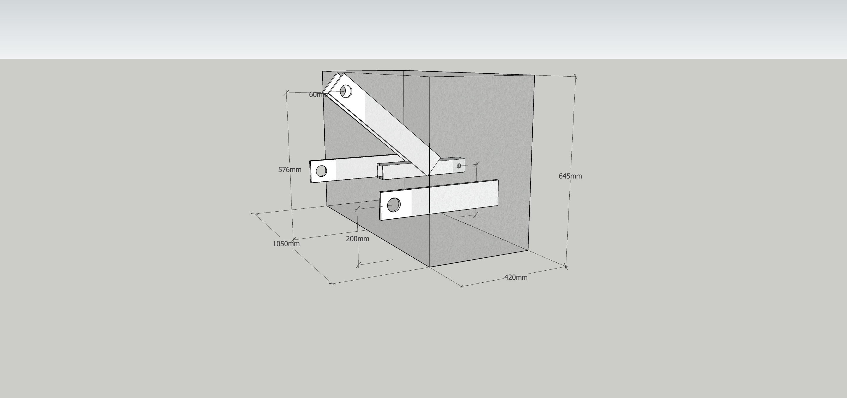

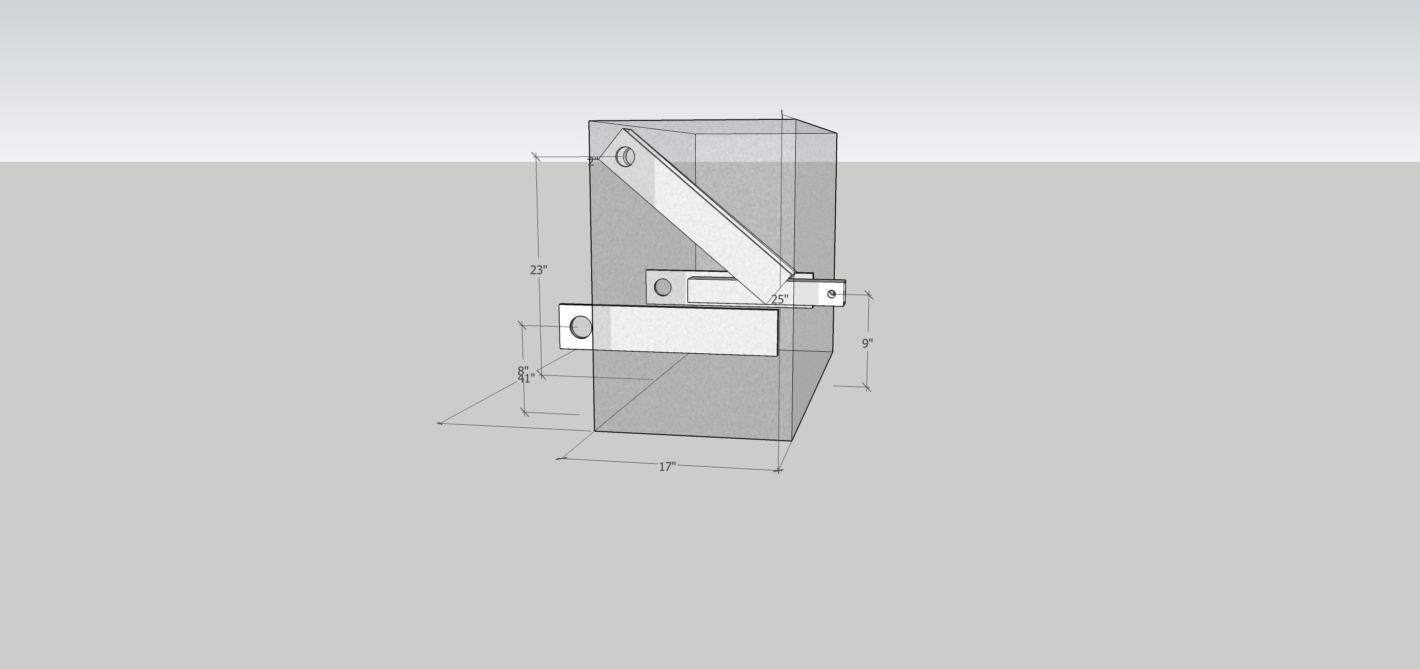

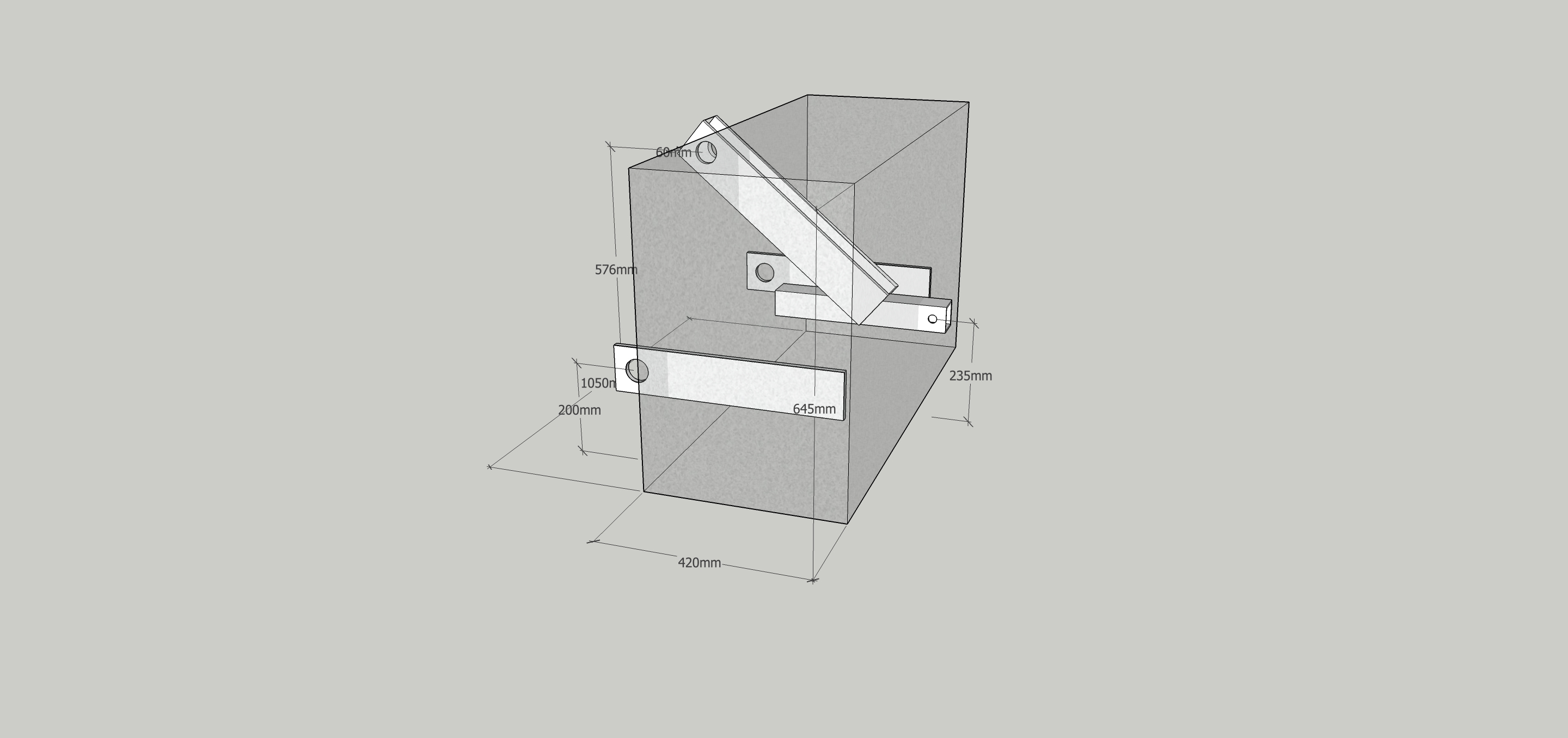

   / Ballast - Any merit in this idea?
#53
Are these dimensions better? Will they work with a quick hitch?
Thanks
Ken
#54
I left out a critical dimension - 30" between the faces of the lower beams.
Ken

I'll try to reword... if you're MX is like all the other MXs from the factory then it uses a 3/4" pin for the top link and 1-1/8” pins for the lift arms.
I think you'll find it awkward to use the 1” hole you've drilled for the ballast top link. I would really confirm your pin sizes before proceeding.
As far as setting the rest up in a cat2 configuration... there's no problem with that I can see except for lack of compatibility. There's also need advantage I see to set it up as Cat2. :drink:
Personally, Id put the hitch receiver about 8" off the ground.

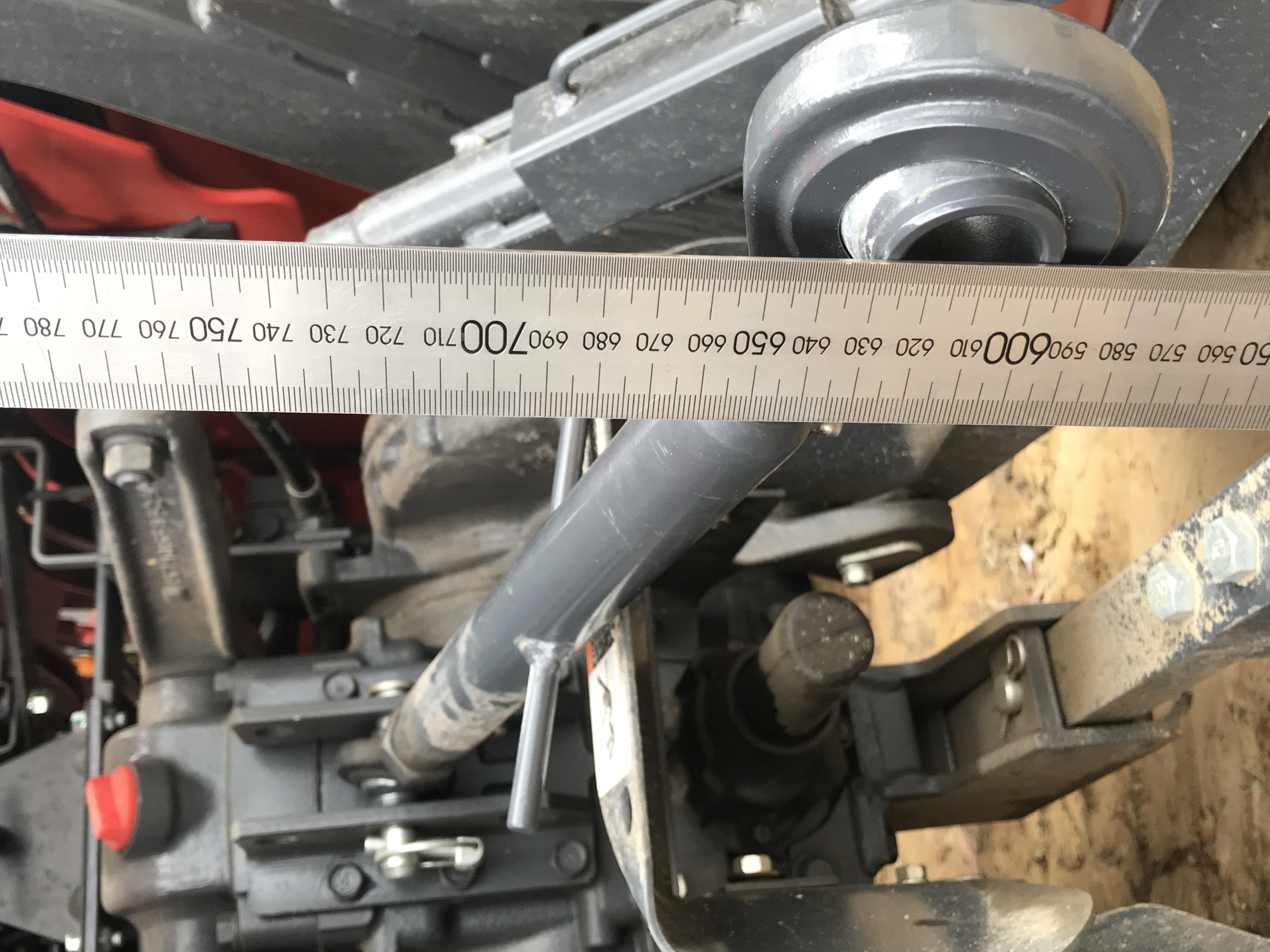

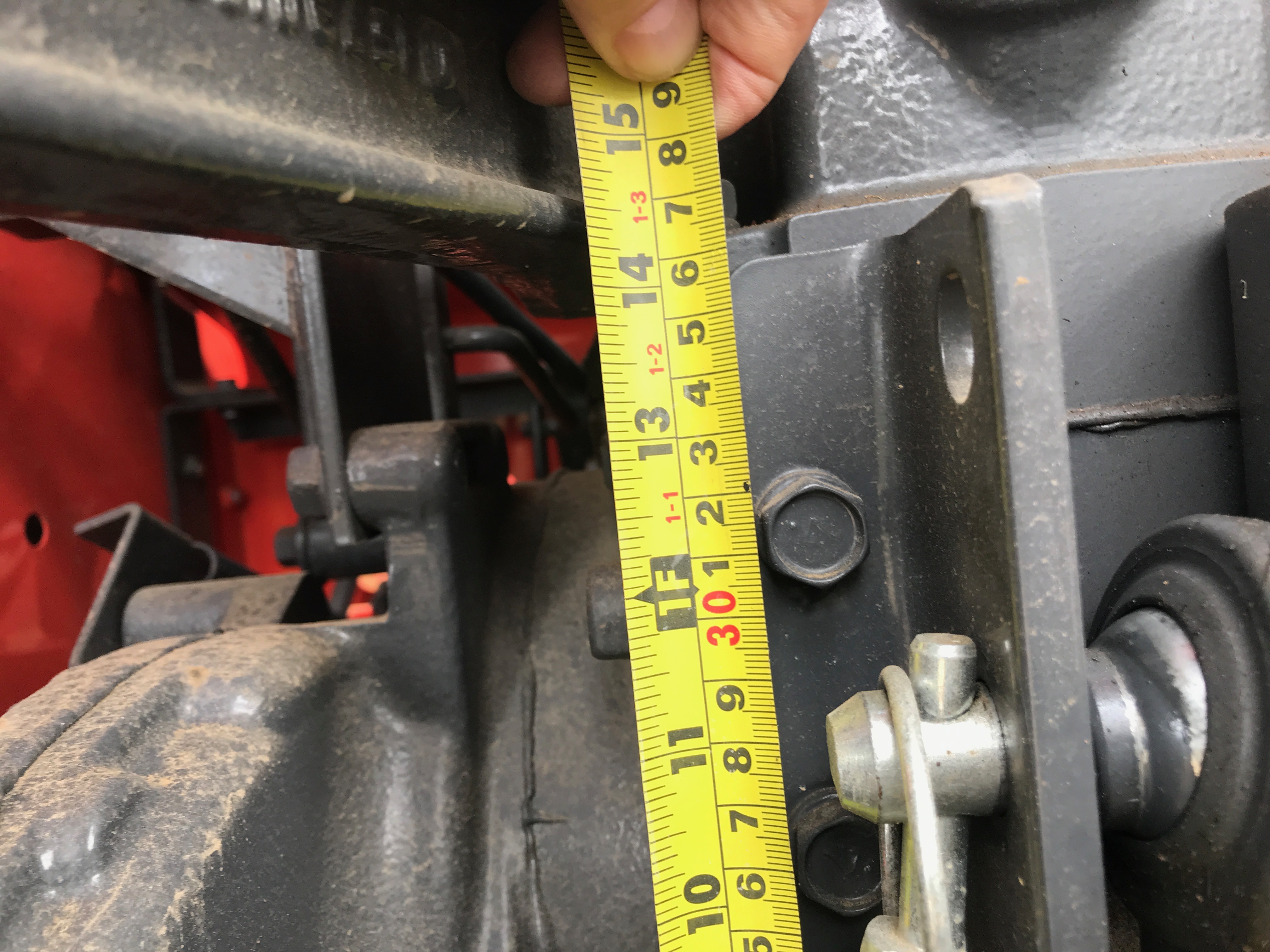

Not sure I follow that but it looks like top link holes are smaller than bottom link holes. This site shows
1 1/8 inch bottom hole dia on cat 2:
Linkage pins sizes Cat 1 Cat 2 Cat 3, usefull Information about tractor linkages | Implements Direct

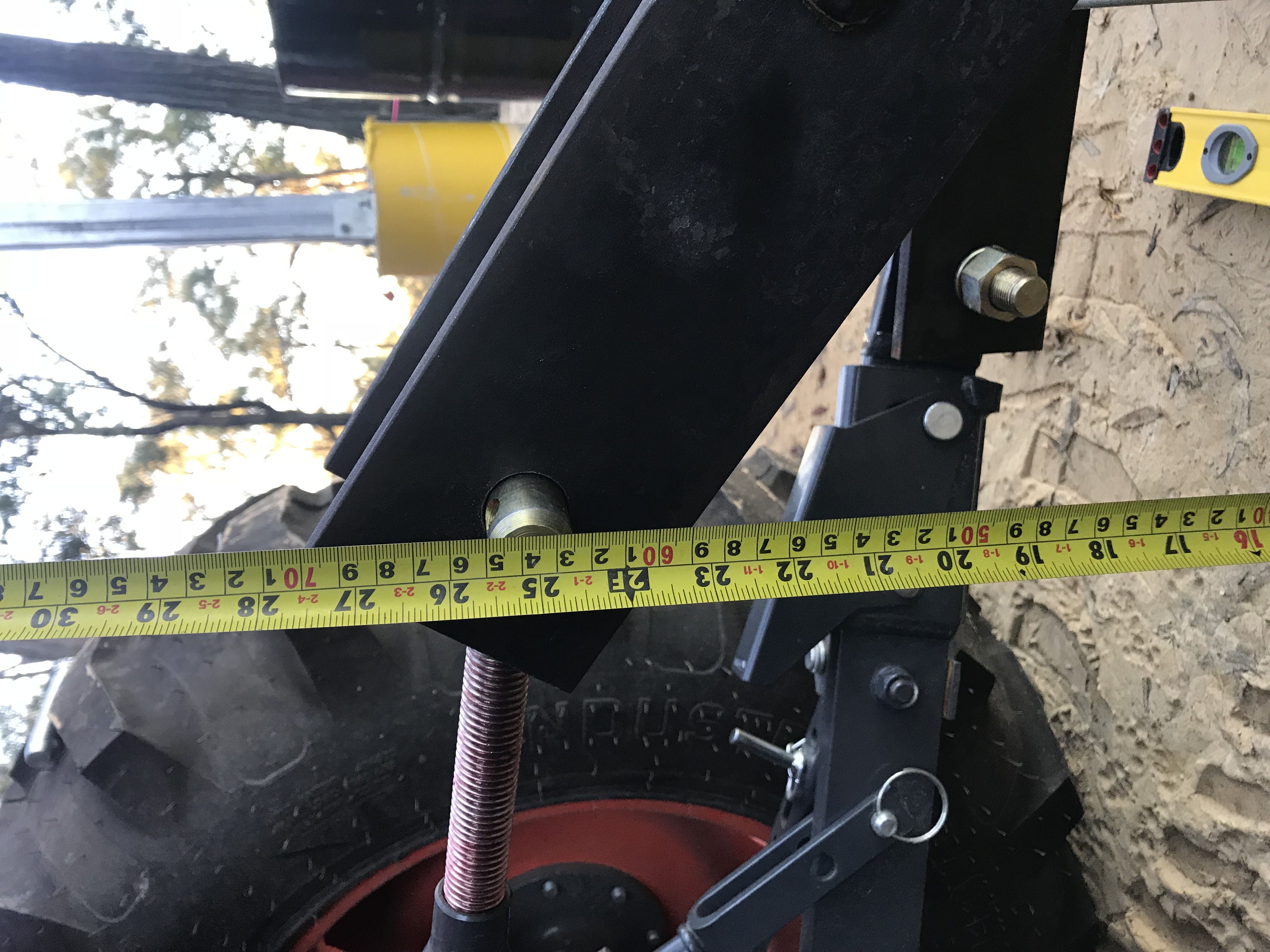

On my tractor, top link has different size holes on each end. On the end of the link that attaches to the tractor the hole is CAT-I and on the the end that attaches to the implement the hole is CAT-II.
I took the attached photos to measure heights from the ground with a certain configuration, but they have enough detail to show that the top link is 3/4" (~19mm) on the tractor end and 1" (~25mm) on the implement end.
I have never understood the logic of this, given that 'a chain is as strong as its weakest link'. In other words, the top link on the MX5100 has effectively only CAT-I strength and not CAT-II strength.
Perhaps this is the way they are configured only on Australian models and the USA models are 1" on both ends?
Ken

#58
I'll try to reword... if you're MX is like all the other MXs from the factory then it uses a 3/4" pin for the top link and 1-1/8 pins for the lift arms.
I think you'll find it awkward to use the 1 hole you've drilled for the ballast top link. I would really confirm your pin sizes before proceeding.
As per the attached photo (of some testing of configurations), you'll see that the implement end of the top link on my tractor is 1".
Wow - that is a lot lower than I had planned. I'll review my thinking.
Cheers
Ken
