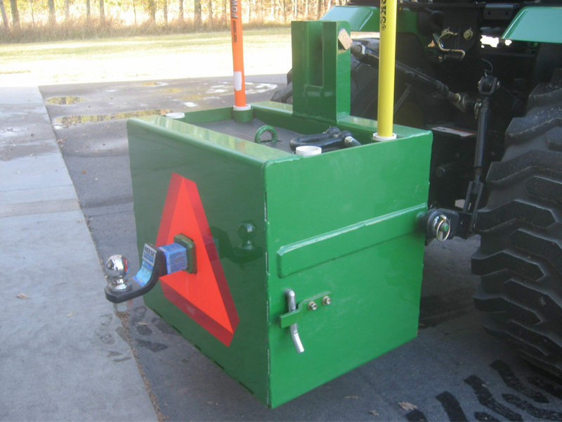

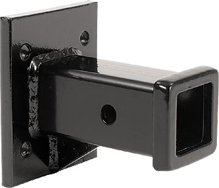

Wanted to get a hitch mounted to my John Deere Ballast box for my 1026R. I have a little trailer I use around the property and figured A receiver hitch mounted to my ballast box will be one more addition to avoiding switchouts for various work I'm doing.
Question is, will the metal wall of the ballast box be ok to support a bolt on receiver hitch? Will I be bellying out the metal when pulling lets say a trailer full of firewood?
I have attached a photo of what i was thinking on mounting.

Use large (fender) washers on the inside of the ballast box...or even make up a doubler plate using 1/8th to 1/4 thick plate. The intent is to spread the load as much as possible.
This is probably overkill since the Deere boxes are pretty robust as manufactured.
Something to consider...if you pour concrete in the box, you'll never be able to remove the receiver. You might want to consider a less permanent ballast. As an example, I use sand.

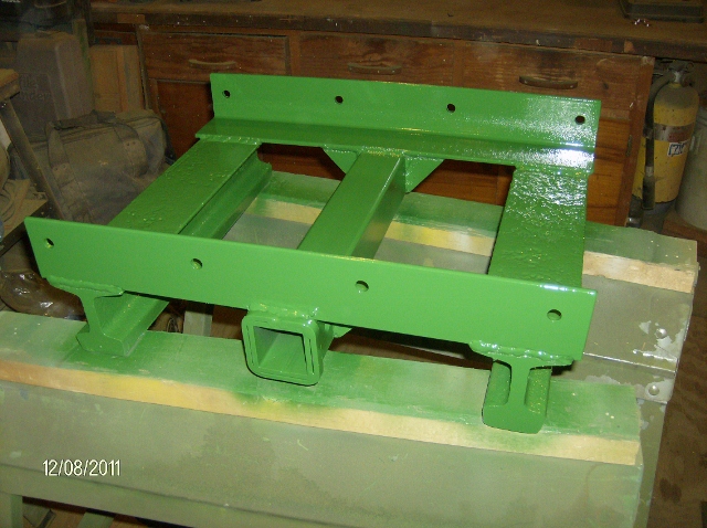

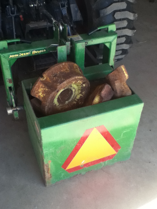

The first picture is my box, filled with sand then topped with some cast iron weights from an old 4020 we had years ago. The last 2 is from somebody else here on TBN with the receiver on the inside, you can see the pin on the side of the box that lets the pin out. This is what I want to make eventually, but my flex point receiver does well now.

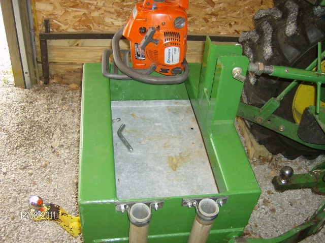

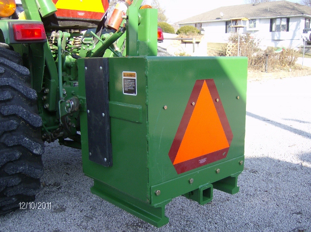

/ Ballast Box Bolt on Receiver #9
I had some old light RR rail laying around & wanted my box up off the ground. So I used a long receiver tube welded to two 1/4" x 2" angel irons which are welded to the RR rails. This is bolted to the box. Also added a plastic chainsaw sheath to one side of the box & two Plastic conduit pieces to the other side for tools. My box has 600+ lbs. of scrap iron (including the rails), leaving around 8" at the top for drawbar, chains, tools, etc. Tray inside is an old galvanized grainery door.
I later added another set of lower pins 5" lower than the originals to raise it higher for loading on the trailer.
I picked up the "barely used" box off CL for $70, but it took quite a while to find one! ~~ grnspot
I picked up the "barely used" box off CVL for $70, but it took quite a while to find one! ~~ grnspot
Now that is a nice setup! How did you mount the chainsaw sheath? I would love to do that as well, due to the fact I will be going in and out of my woods cutting timber.
/ Ballast Box Bolt on Receiver #11
Thanks!
We have a plastic recycle plant nearby & I keep some 1/8" & 1/4" 4x8' sheets on hand for projects. The sheath is a sandwich of 1/4" plastic, full sheet backing, narrow side strips & full sheet outer, bolted to the box with 1/4" stove bolts. Depending on the thickness of your bar, you may need thicker strips. Plywood will work, but the plastic will last better! ~~ grnspot
