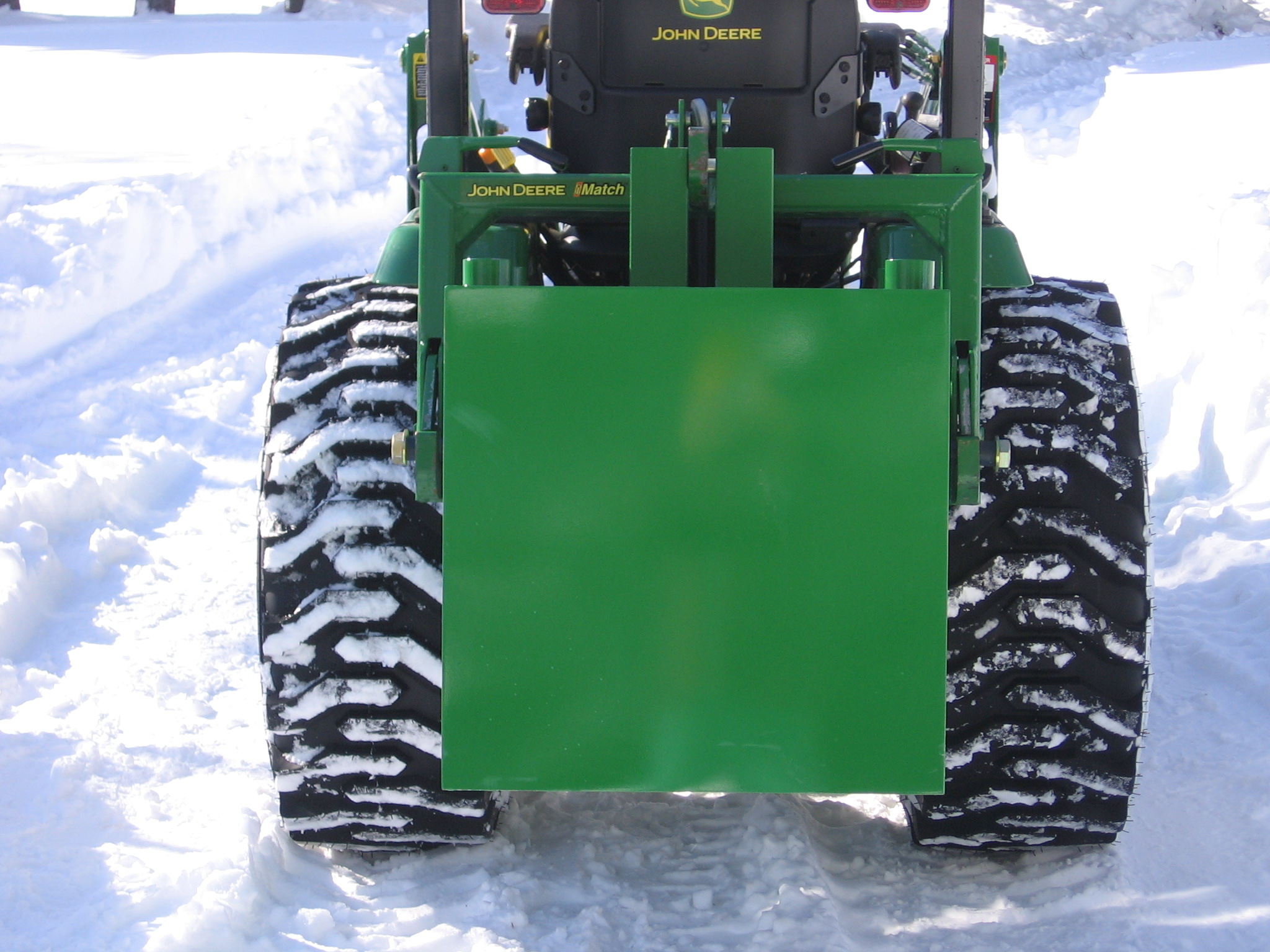

Here are a few pics of my box before paint. I was planning to paint it the way it is,but a friend and coworker who knows bodywork offered to "mud" the welds and spray it for me. So I went to the JD dealer and bought a quart of paint,thinner and hardener.......70.00...ouch! Paint wasn't bad,the hardener was the most...40.00!! Enough for a gallon though.
I made the box out of leftover 1/2"x12" cold rolled. The box tubing is 1-1/2 square with 1/4" wall. The pipes are 2" schedule 40. The pieces of angle are 3"x3"x1/2". I cut 1" off so it would be flush with the edge. The box measures 24" wide,18" deep,and 24" high. The box weighs 380lbs......empty!!
For the side pins, I'm using 1"x5-1/2-8 bolts with a piece of 1" schedule 40 pipe over the bolts for bushings. The OD of the pipe will give me just about 1-1/2". I cut the threads off a bolt and drilled a hole in the end for a 7/16" locking linch pin for the top pin. I also added a piece of 3/4"x3"x4" inside the box to give me 1-1/4" for the threaded side holes.
Comments good or bad are welcome:)
Greg

Nice job making my 55 gallon drum ballast weight look pitiful. Seriously though, nice job.
/ BALLAST BOX BUILD #23
I know I live close...... :) Can u beat the JD prices....???:thumbsup:
/ BALLAST BOX BUILD #24
Wow, that is a super ballast box you built, :thumbsup: !!! KC, :D :D :D
