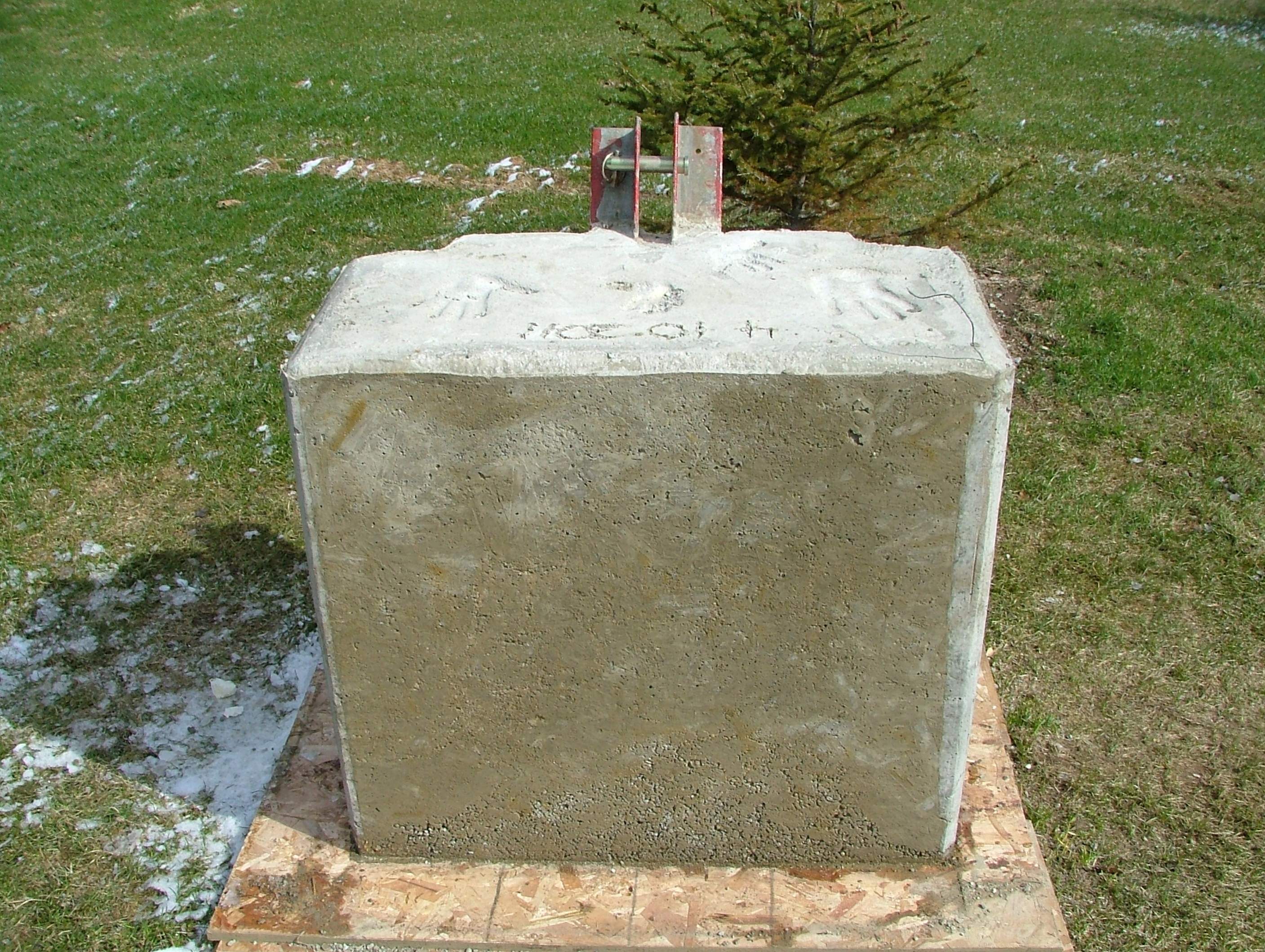

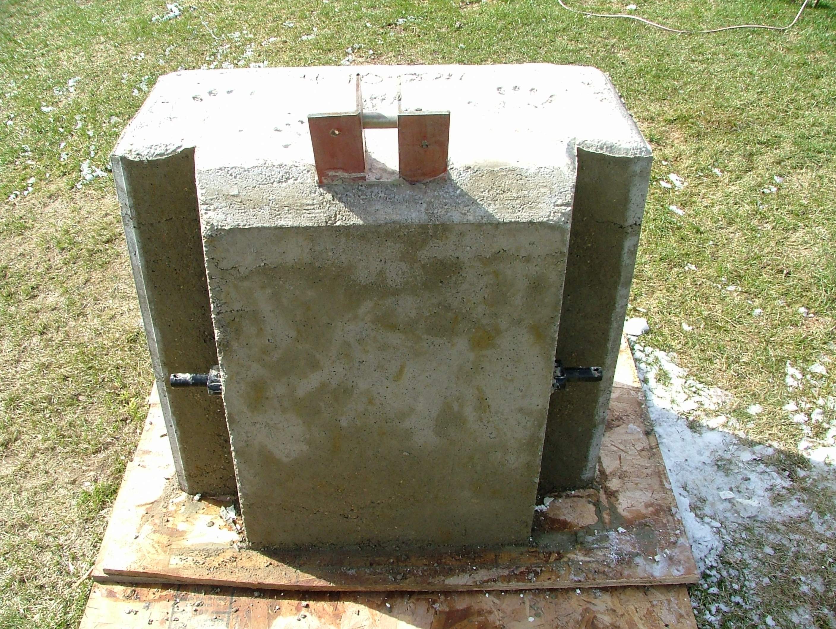

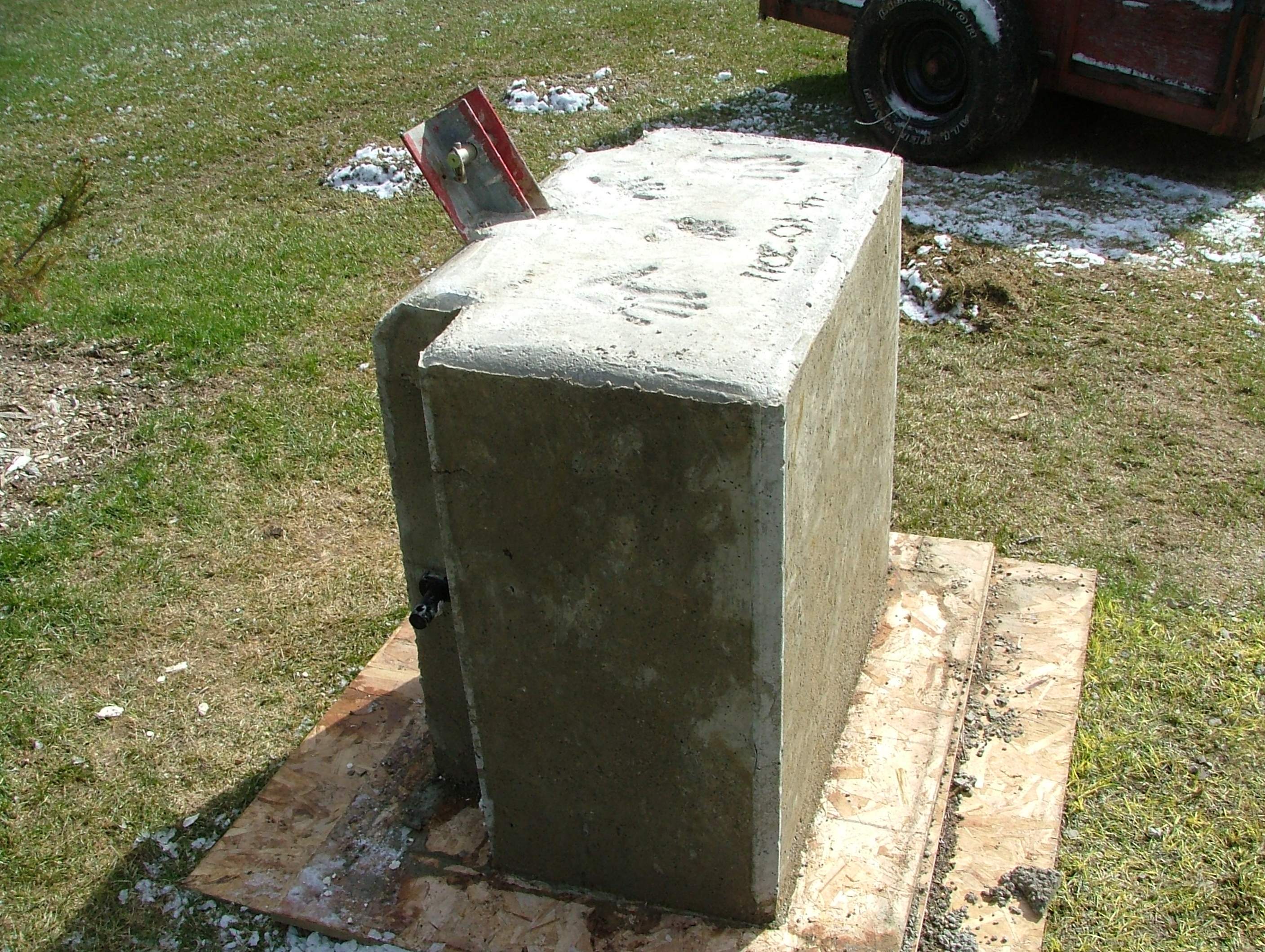

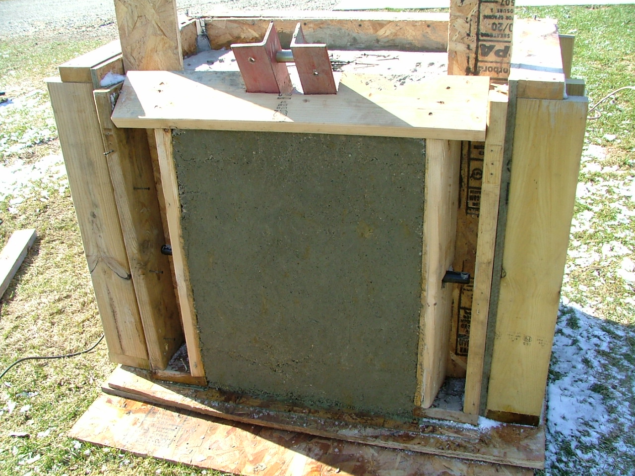

Here are some pics with the form removed. This weekend will be two weeks since it was poured. It hardened up nicely, despite the very cold weather we've had since the pour (30s and 40s). I'm tempted to try lifting it with the tractor this weekend.
If I had to do this again, I think I'd line the form with plastic. To prevent the prune appearance that others have spoke of in other threads, I'd line each face of the form with plastic, pulled tight before assembling the form. I believe this would result in a very smooth appearance. As I did it, I believe the wood pulled some moisture from the surface and resulted in some areas of the surface not curing as well. I may get a back of concrete to smooth off some of the spots that didn't cure as well. I have no idea why I'm compelled to do that since this is just a block used for weight. :confused2:

U will soon get plenty of dings in it.
""One of the local cement factories would fill that form for cheap around here. You could beld up and weld some rebar to that steel that would help reinforce it.""
That is definetely a goer, even if its reject, hey its only a counter weight. As long as it will hold together reasonably well. Heard of a local place around here that makes em into blocks for barrackades etc.. out of excess and reject stuff. Might pop in one day with my formwork etc set up and do just that.
   / Ballast Box Build #17
Did you coat your form with motor oil before pouring the concrete? That would have made it easier to separate the plywood from the concrete. We did that with some poured concrete here and it worked great.
We used new motor oil by the way.
   / Ballast Box Build #18
After seeing diesel being used in the same manner I used it once myself, results seemed good enuf for the job.

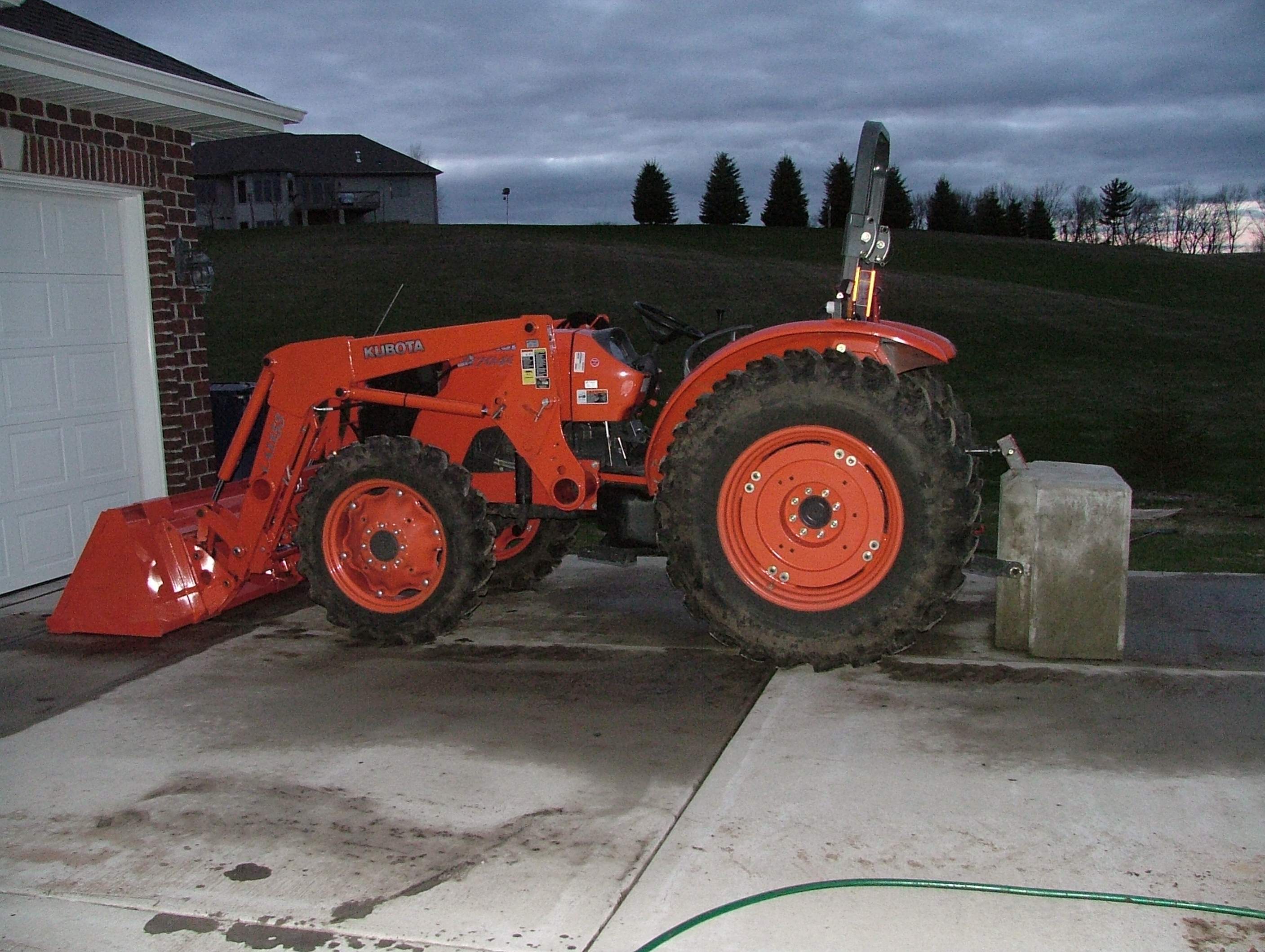

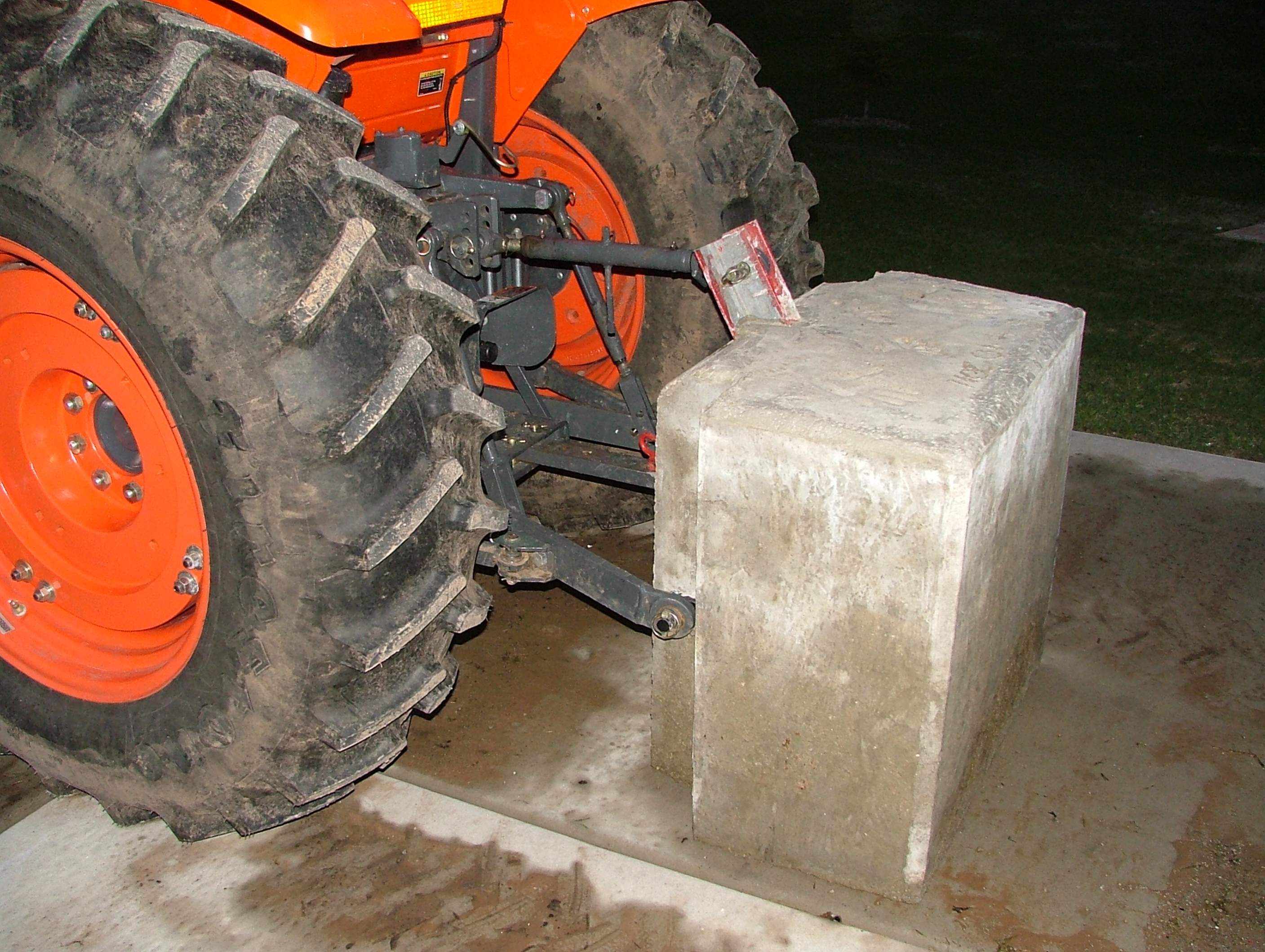

Hooked her up today and wow what a difference. The extra weight takes the back end down an inch or two when the block is raised. And it feels much more planted when using the loader. There were no signs of cracking or stress on the block when lifting it either. I did get a bag of rapid set, high strength cement that's designed for resurfacing, so I'll be able to make the surface of the block nice and smooth (why I care about this, I have no idea).

Very nice. I have been wanting to do something like that for our M7040 and it sounds like I should hurry up and do it. Should work well. :thumbsup:
