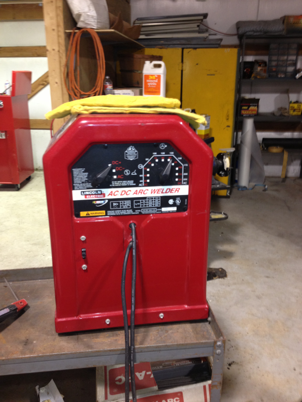

The first order of business - replacing my stolen welder. Hello Craigslist. Found this near new AC DC tombstone for $200. It's now mine :)

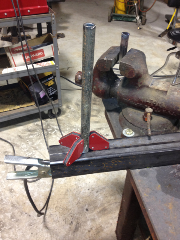

I want to incorporate a trailer hitch receiver - almost flush with the concrete. To do that, I have to design a way to insert the pin - inside the concrete.
I purchased some square tubing sized to allow the hitch to slide in. Measured how far back to drill my holes, making them slightly oversized.
Now I am welding tubes - a long one that will penetrate from the receiver hitch thru concrete to daylight; and a short one on the other side.
Here I am setting up to weld the long one. It's been a long time since I welded. This isn't going to be pretty

Good deal, it looks new.
I went ahead and took off the cover of the welder, which I needed to anyway to install the correct plug. While I was in there I gave it a good cleaning.
He even threw in a good half box of rod.

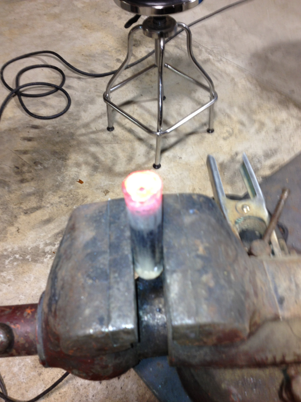

I needed to weld shut the end of my short pipe. That was fun! Ok, might have had to try this twice. I kept melting my pipe!!

You probably already did this, but be sure you try a couple of hitches in that 2" ID sq tubing to be certain they will fit before you get it all welded up. Have seen some 2" tubing that you couldn't get a 2" hitch to fit inside it.

So your going to have the tube going thru from one side for a long hitch pin right.
Yes, I will have a long hitch pinch to hold the hitch into the receiver. I will have to fab some sort of lock to keep the pin from sliding out when in use.

Well to lock a hitch pin in place you can make a 90 degree handle at the end of your pin, and mount a hook on the out side of your box thin all you do to lock the pin is rotate the handle of the of pin into the hook. Should work just fine.
